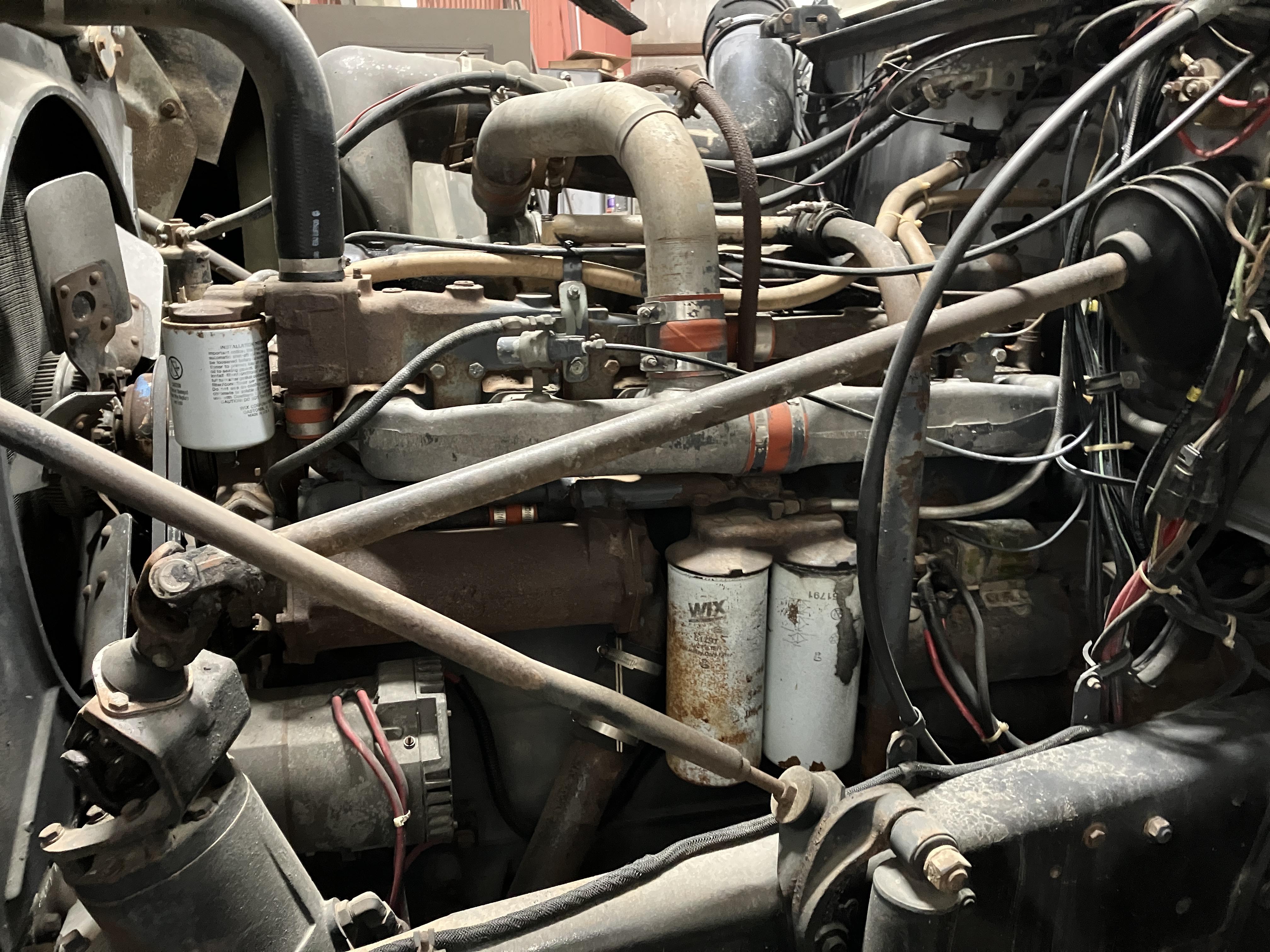

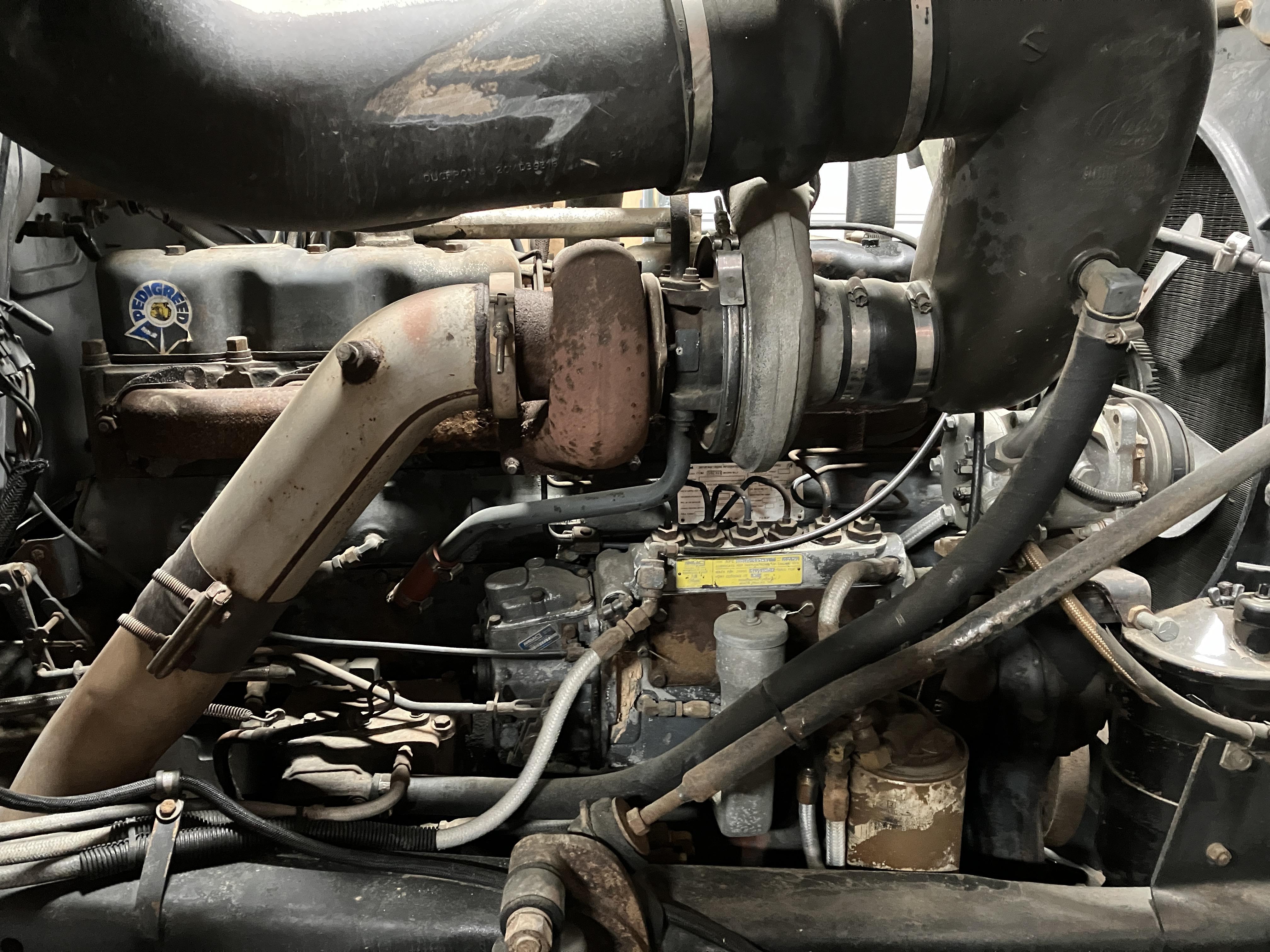

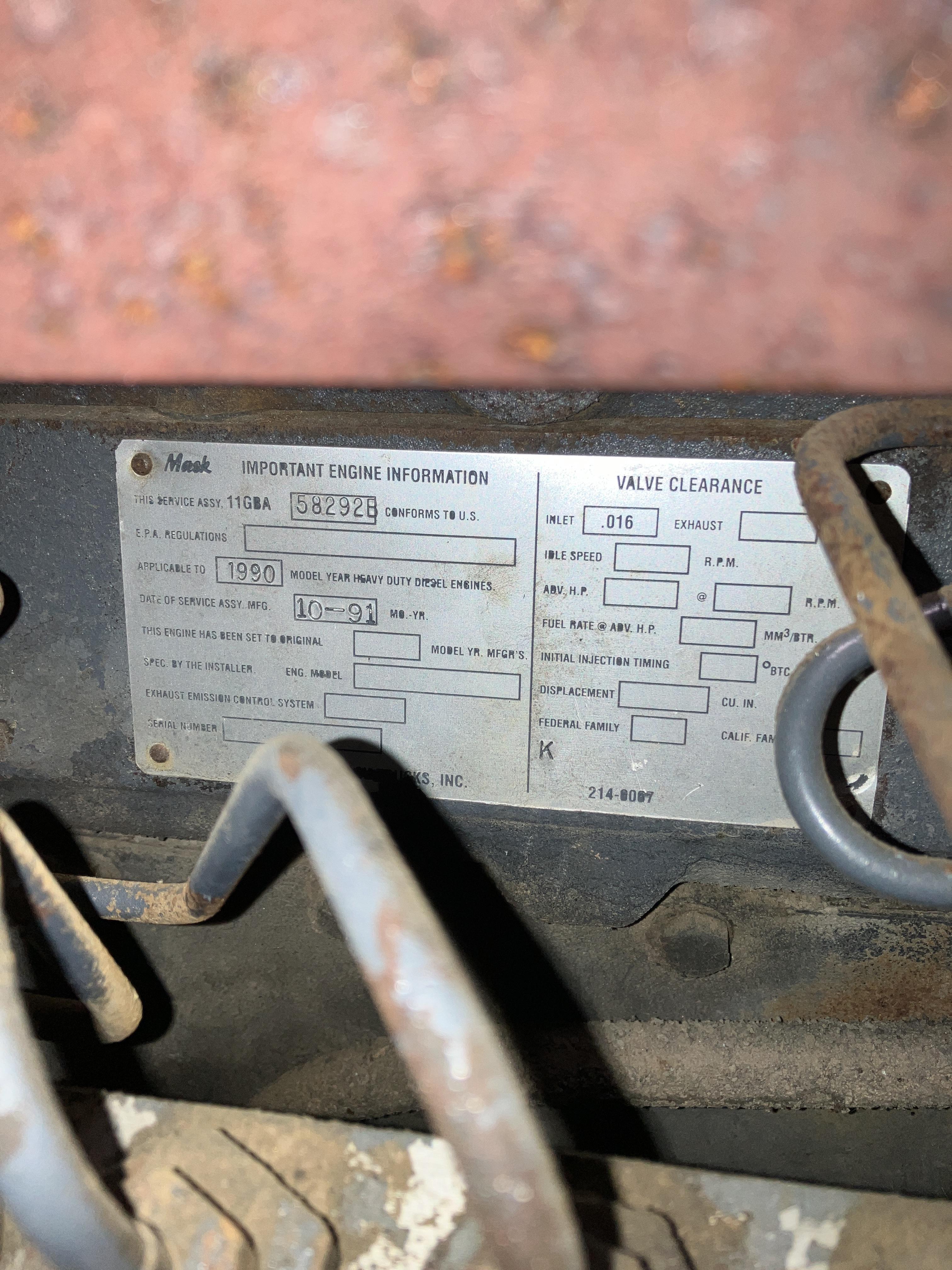

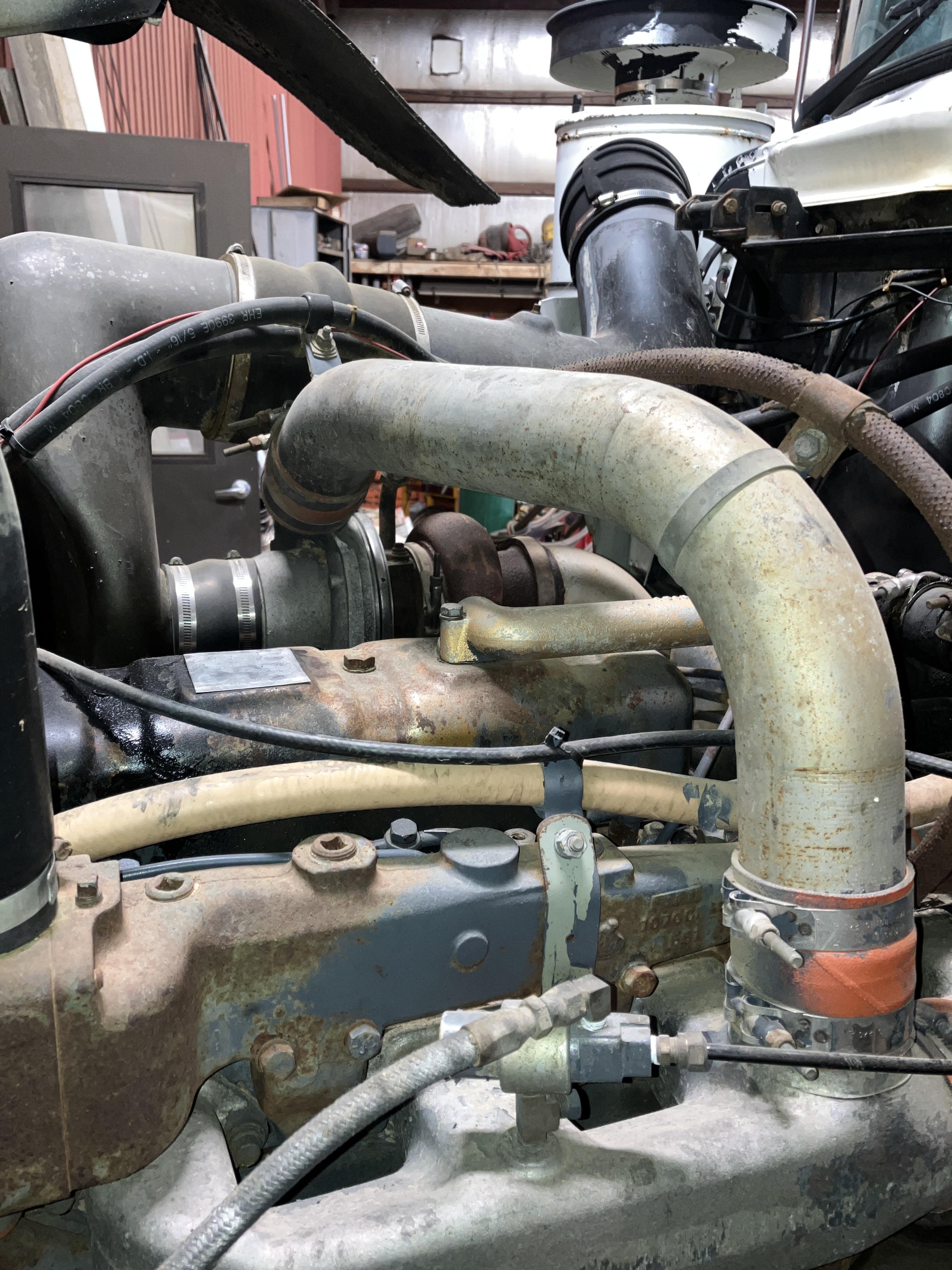

new here, but I’ve got an ‘89 R model Mack and I’ve recently learned it must have been a glider Kit as the mondel number is RD600GK.  It’s a non aftercooler engine and I’m not sure how to differentiate between an ENDT and a 2 valve E6.  I’m needing g to find a top turbine aftercooler for it as a standard aftercooler would not fit in front of the radiator.
https://www.bigmacktrucks.com/topic/73563-endt675-or-e6/
Looks like the re-man center didn't do its job with the data plate, I'm guessing it was rebuilt in 1990, the year that the E-7 came out..  maybe Mack can tell you what it is using the 11GBA number..  although, terry did say what it is...  Looks good to me..
