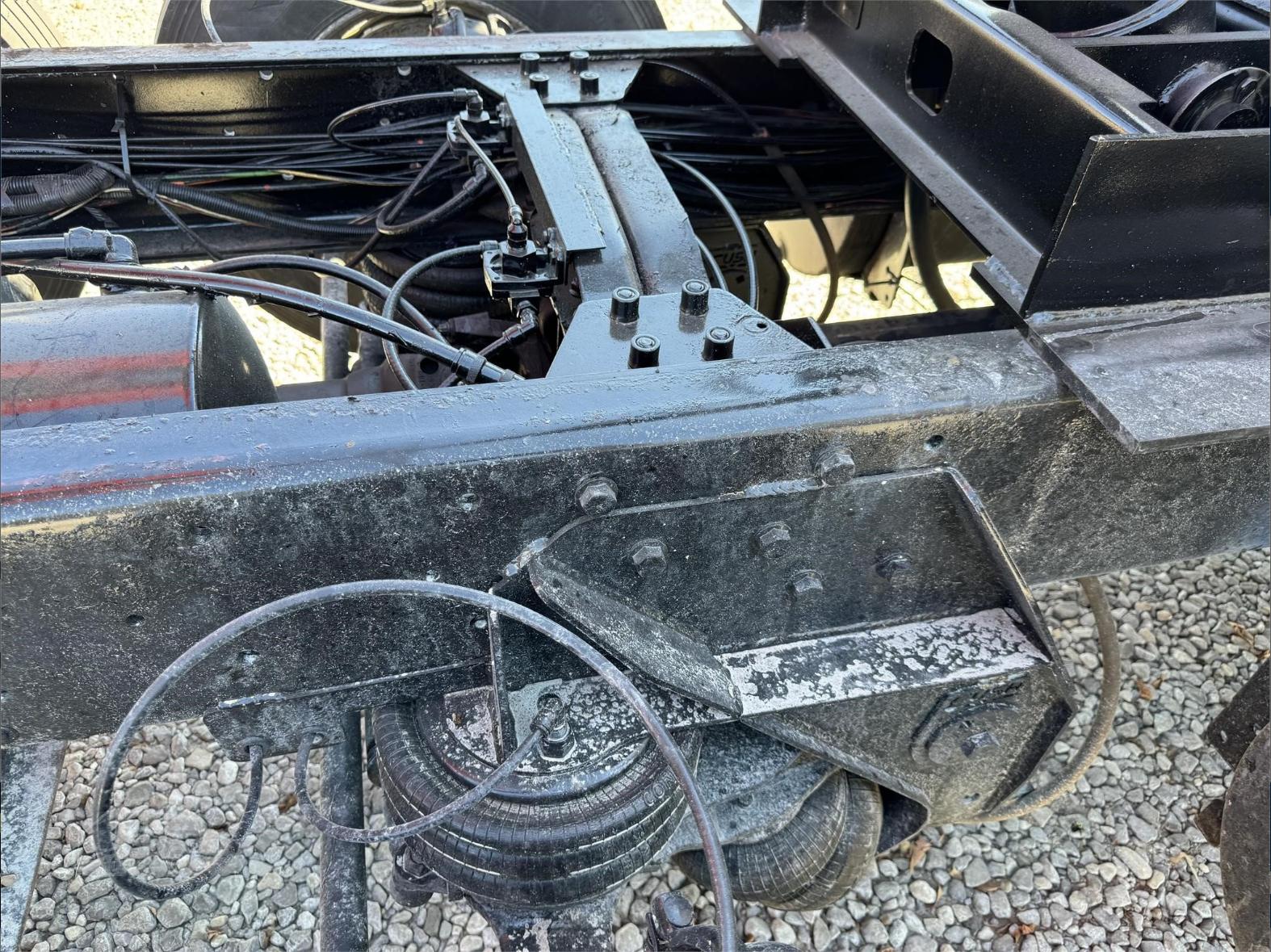

there's some rusty frame pictures in this thread from a few years ago. Gives you an idea of what the rust can do.  It pries the flanges apart until they crack horizontally, junking the frame.  Twice now we've rehabbed trucks by pulling one side out at a time, separating, sand blasting and painting, reinstalling, then doing the other side. Its labor intensive and time consuming, but the end result is about as "like new" as you can get without dropping $20k for new rails.
  • Thanks 1

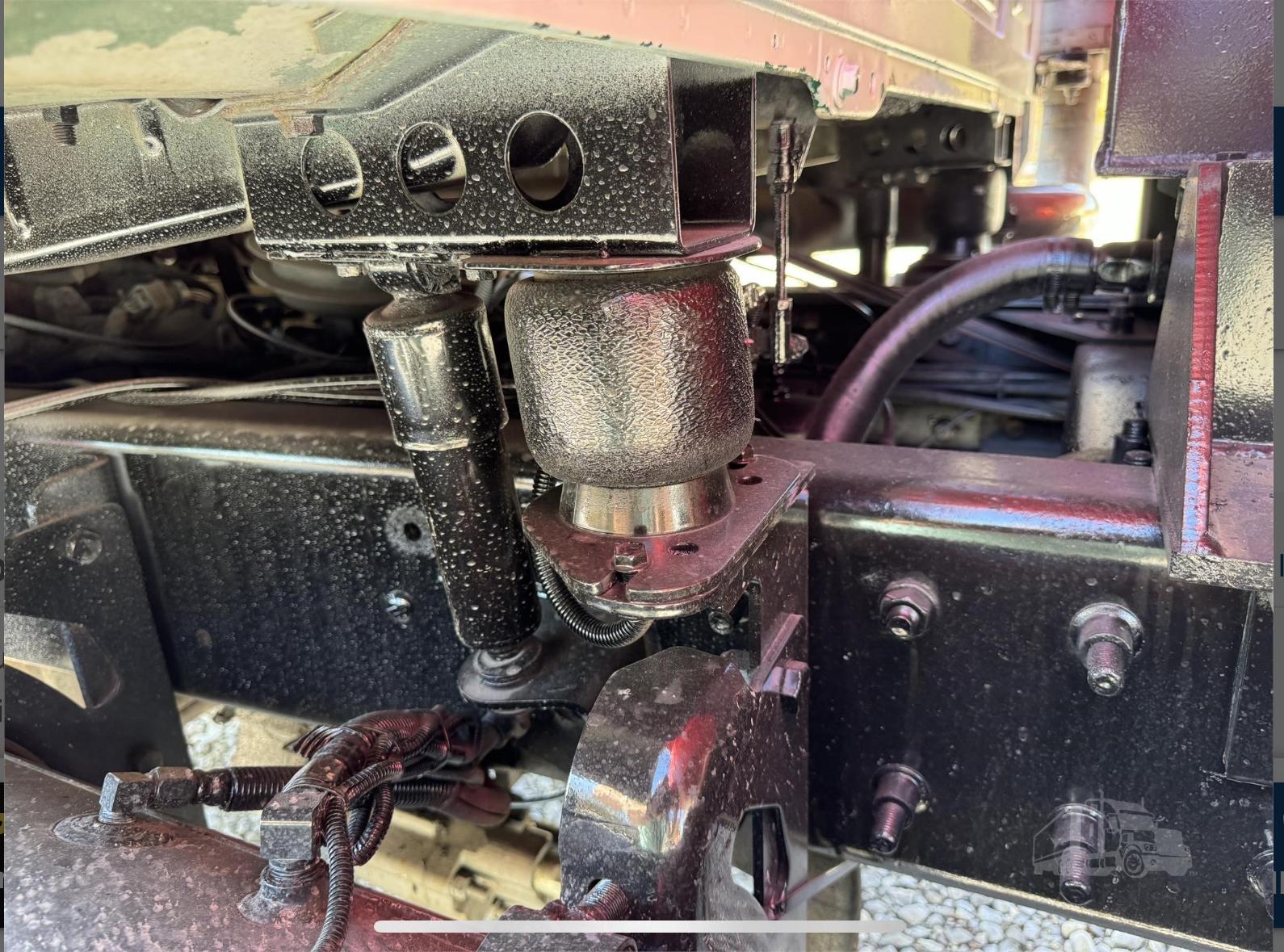

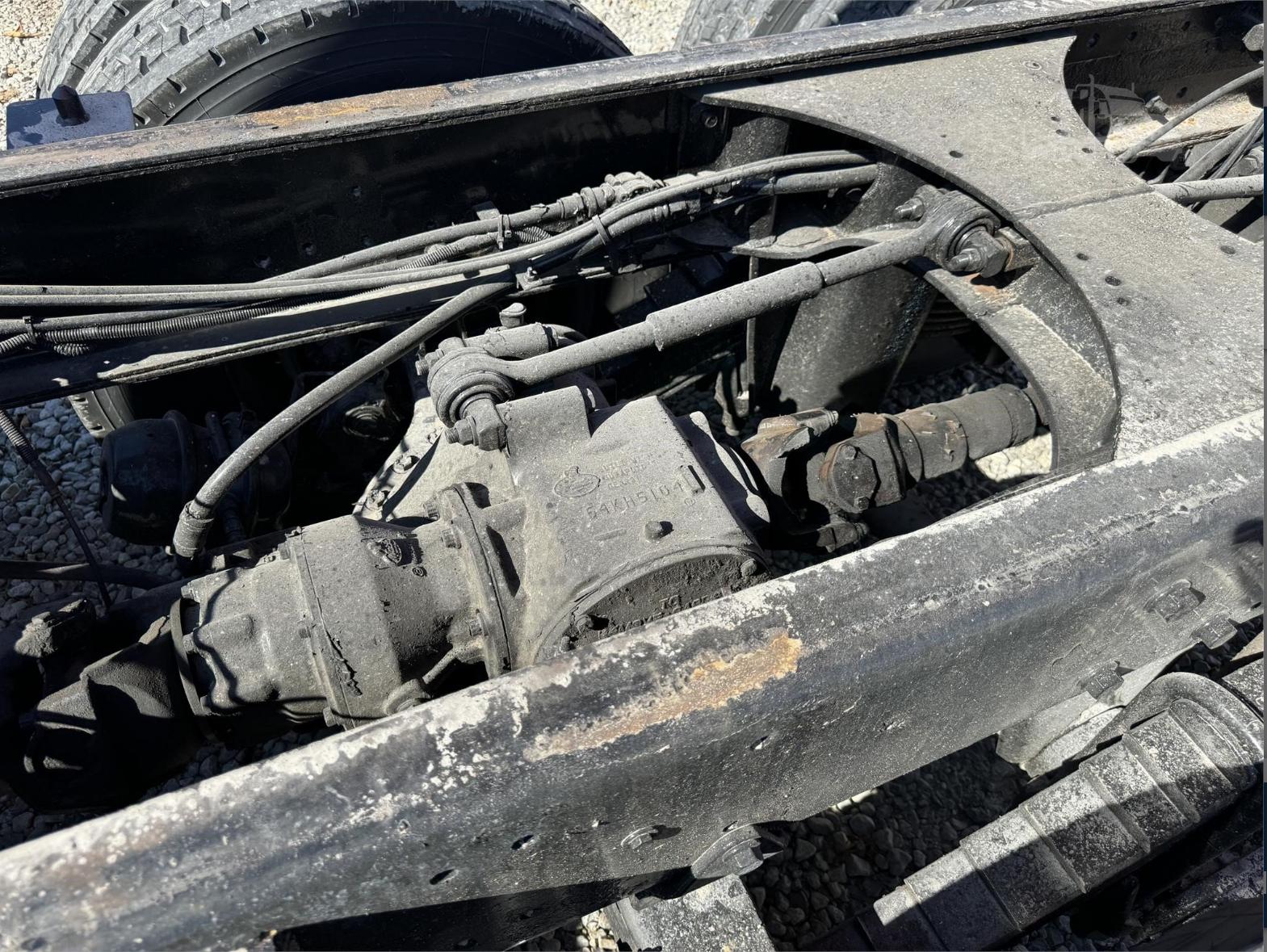

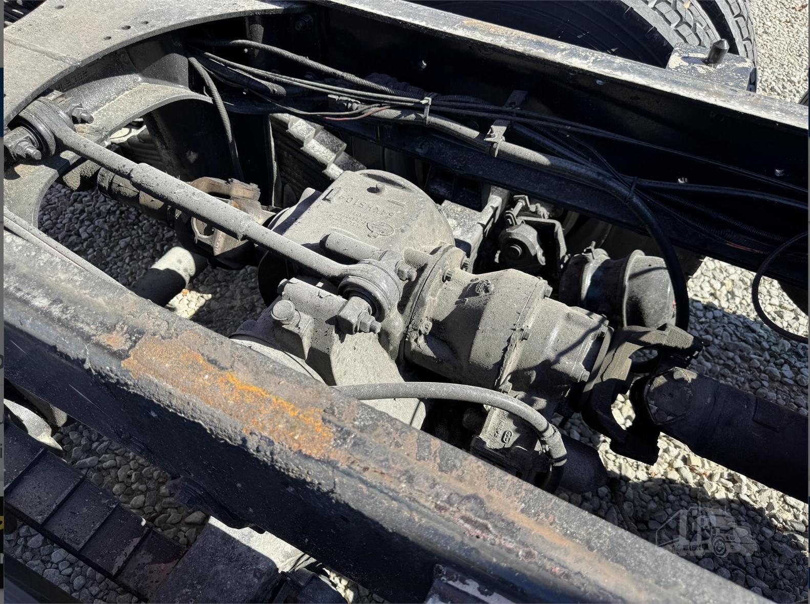

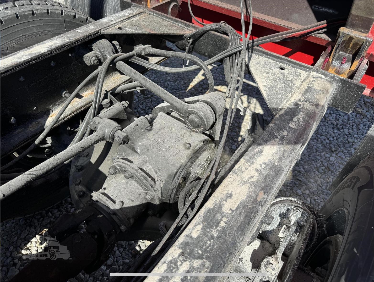

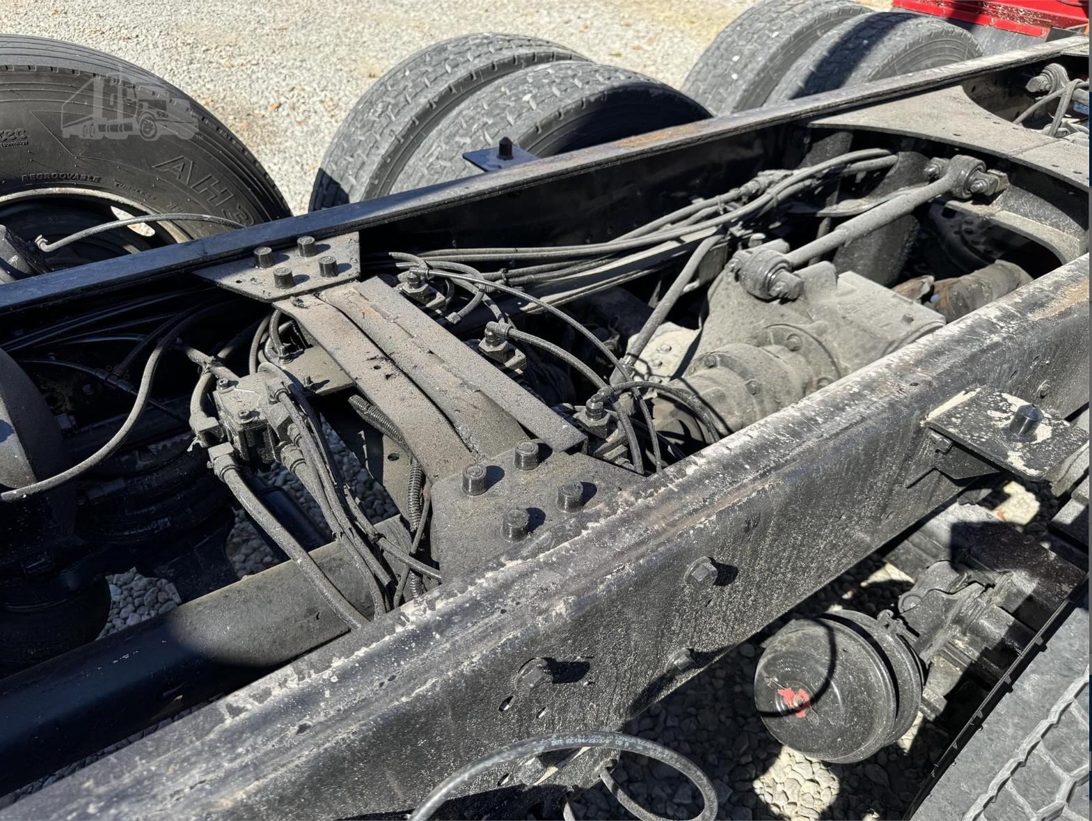

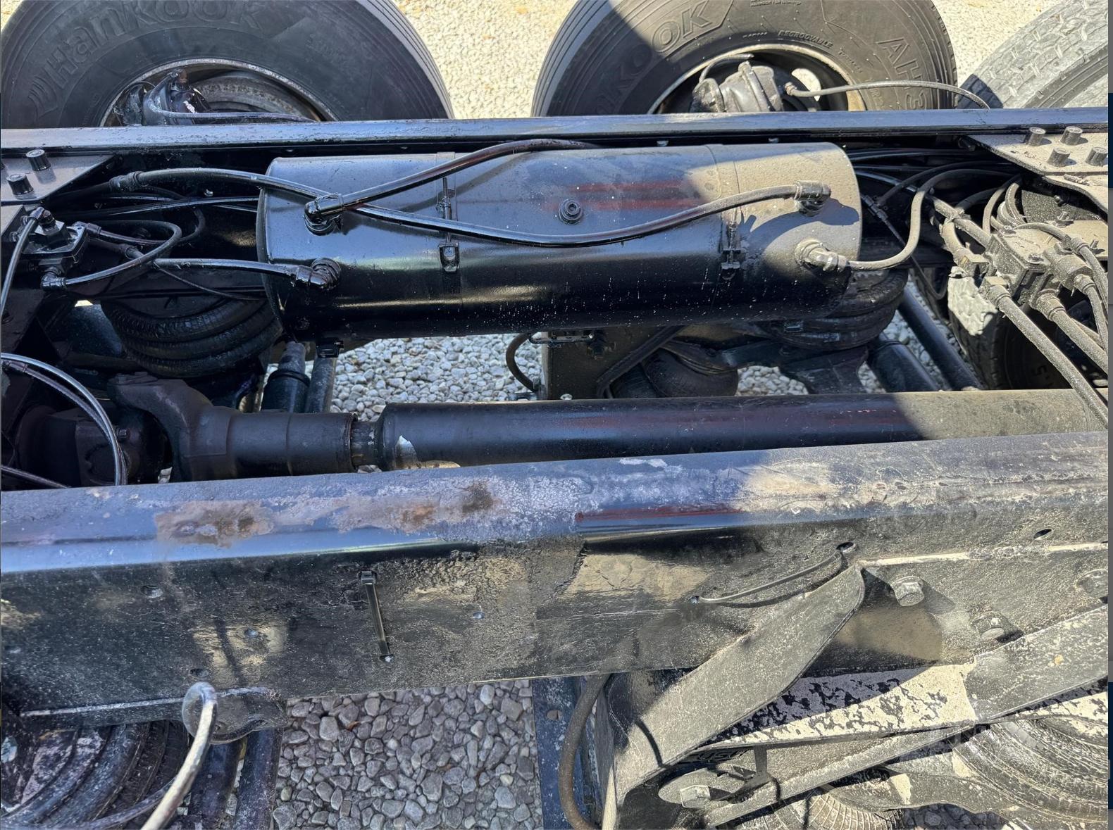

Looks very clean, a minor amount of rust jacking just starting, but a lot of life left in that frame. Only thing I don't like is that they welded the lift axle to the frame in a few spots. Don't think that'll cause you any problems, but welding on frame rails is something you're not supposed to do...
  • Thanks 1

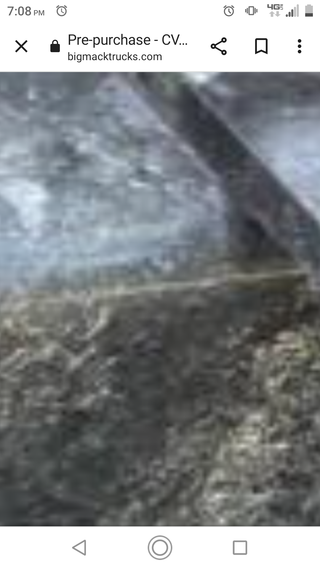

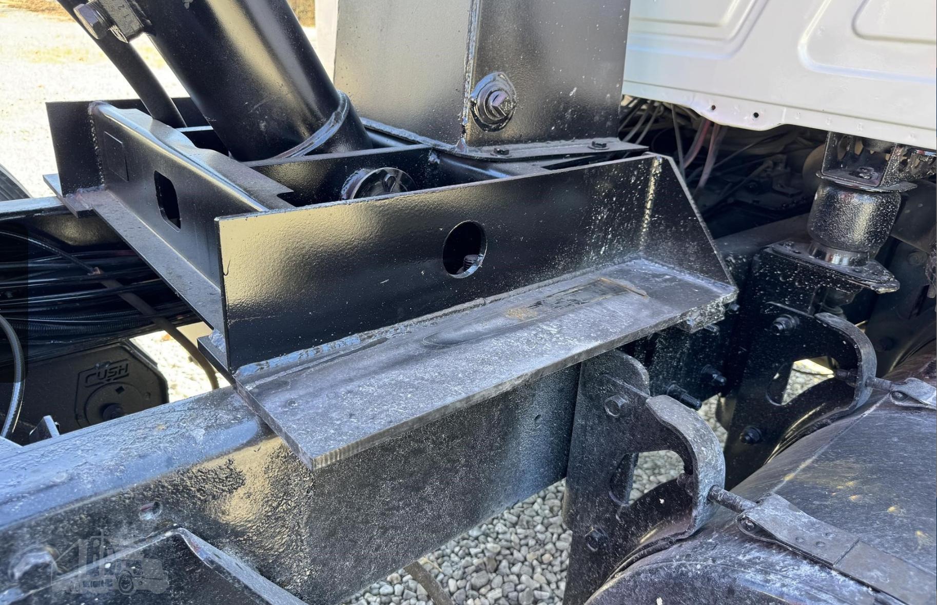

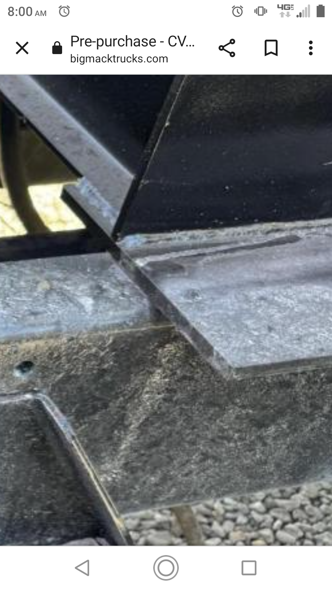

Second thing I don't like:
It looks like the frame has cracked where the base of the hydraulic ram rests on the frame.  This would be a major red flag, truck needs a frame if it's actually cracked there. This is a high stress area, I don't think I'd be welding that spot back up.
  • Thanks 1

Thanks for all the input so far everyone.  Not sure I'm seeing the crack by the base of the ram but will be sure to look that part over really well.
What's the best practice for mitigating the rust jacking toward the rear of the frame?  Or is the ball already rolling on that and it's just a time bomb at this point without a full strip down?

Apart from that one spot by the hoist cylinder I think that is a great looking truck, frame and all.

Ok I see what you're looking at now.  I'm going to verify if this is a crack or not before I fly out there.  Thanks a bunch.

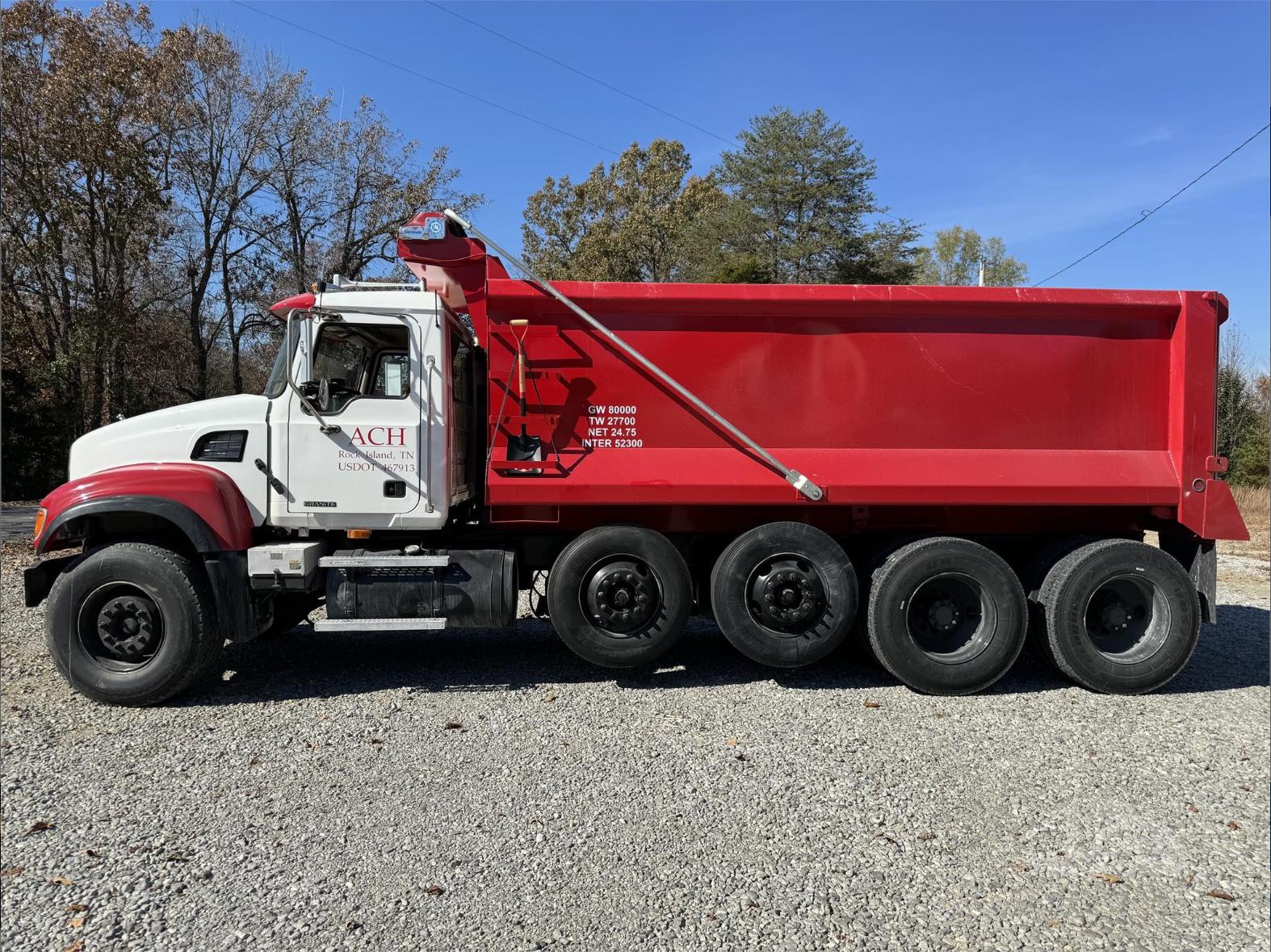

Shoulda just posted the listing in the first place but here it is...
2006 Mack CV713
I know it's probably overpriced but this market doesn't offer a much better deal in this price range.
