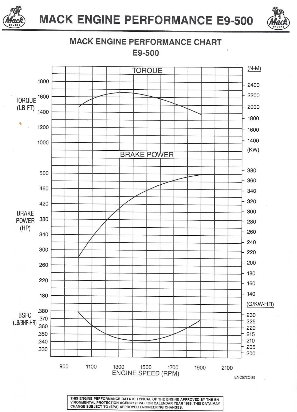

Mind you my #1 answer was a superliner with an E9! That's what I would buy! But parts are hens teeth for those motors I hear. Other than that, a true Mack motor (non Volvo mp series) only gets you 12 liters, which probably doesn't meet his needs.
I'm unwilling to go near an MP engine any time soon.
The E9 was probably a big deal back in the day but honestly is not all that impressive by today's standards even when compared to a "puny", modern 12 liter engine. The E9-500 didn't even make 1700 ft*lb of torque. Torque is a very arched curve peaking at 1650 at 1400 rpm. An MP8 has constant 1860 ft*lb from 1100 - 1400 rpm. and The MP8's 505 hp is almost constant from 1400 to 1900 rpm. The E9-500 is only making 440 hp at 1400rpm and gradually climbs to a peak of 500 at 1900rpm. All else being equal an MP8 would easily out pull a stock E9-500. and a 605 X15 Cummins would blow the doors off the truck with the E9. My guess is keeping the MP8 running and out of the dealership service department would be problematic though.

E9-500 specs pictured below.....
