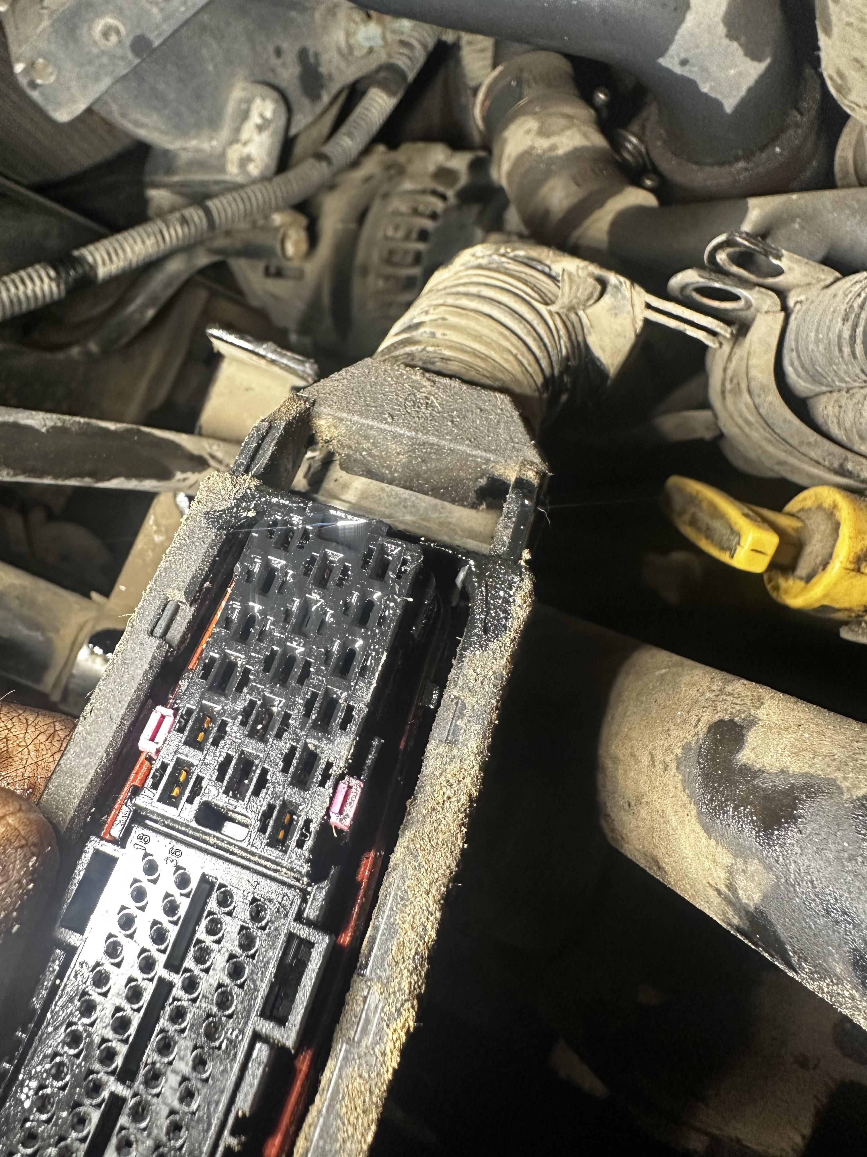

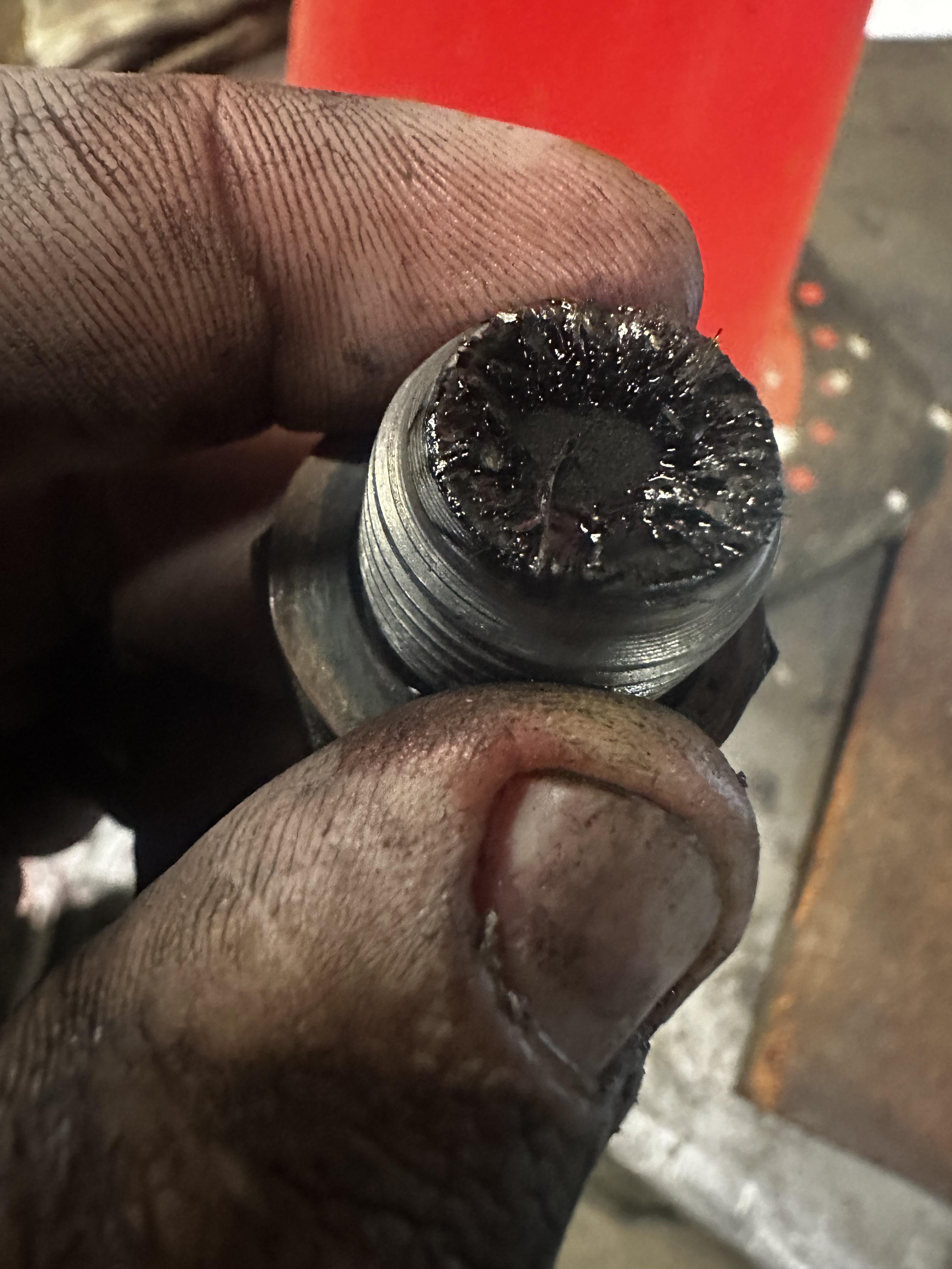

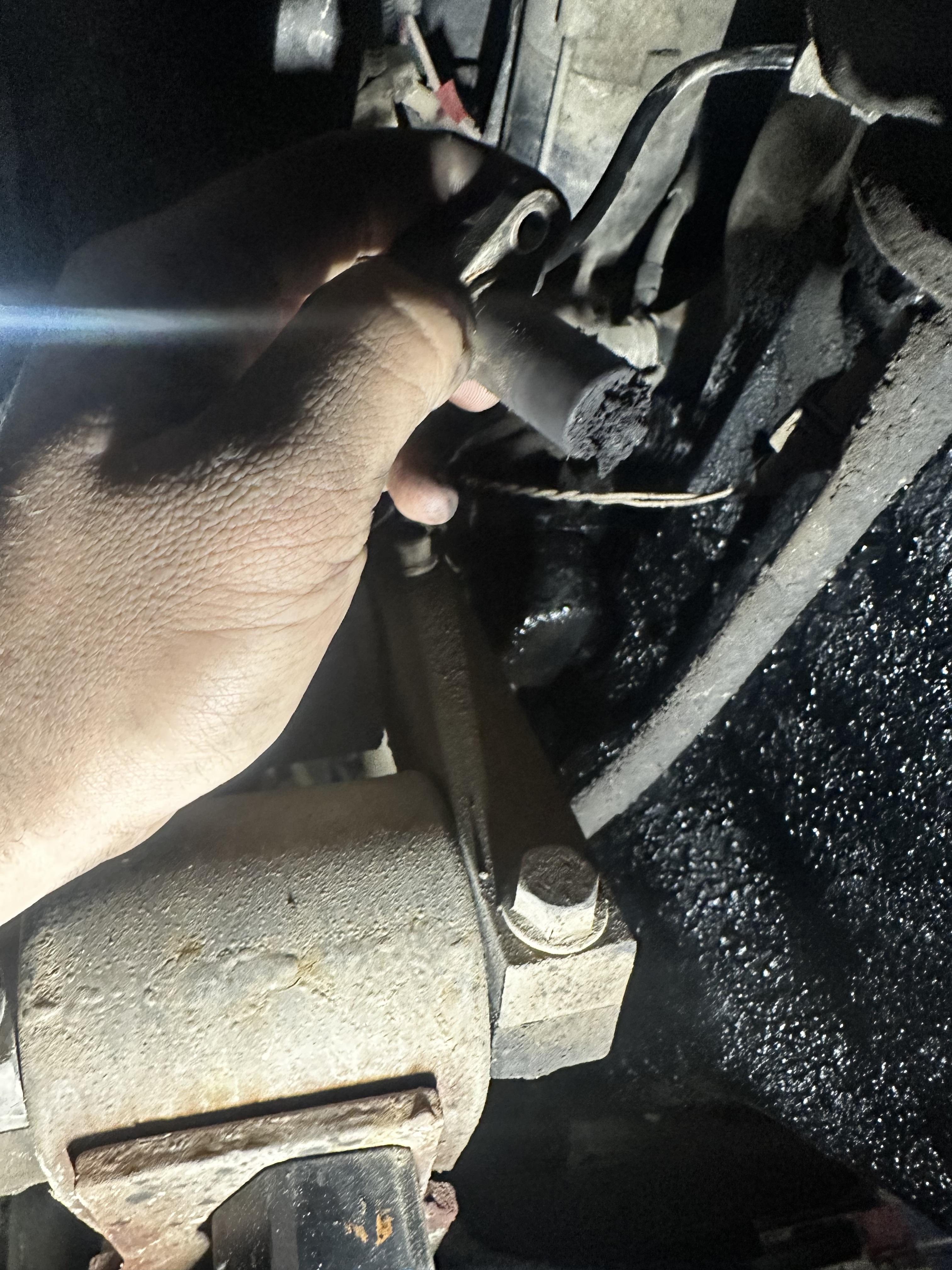

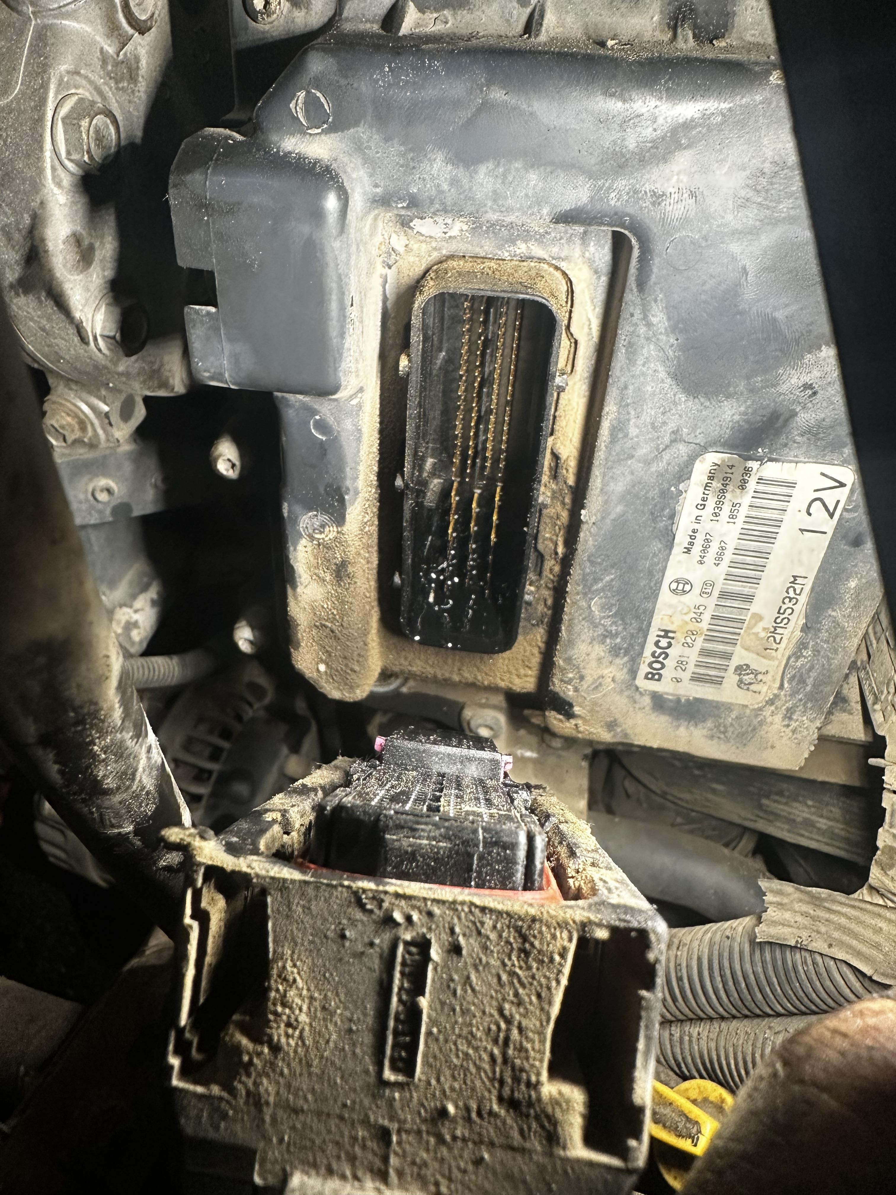

     The truck was run out of fuel, they started it with a ton of ether, it ran away for a short period of time (under 30 seconds) it’s got a miss now, I’ll type the codes I pulled below there all memory codes at the moment. I pulled the cam sensor and found metal on the end of it possibly from a failing throw out bearing which could obviously cause a rough idle, I disconnected the main plug harness going into the injection module and found engine oil inside the plug, on the module. Is it possible the oil pressure sensor failed and oil got pushed through the wire and up to the module? I have no idea how else I’ll could get up there
which seams to be where the oil filter housing meets the block

IMG_1226.thumb.jpeg.f065f8c41195057837951b20c5d6e111.jpegIMG_1224.thumb.jpeg.f1bafd481e5fec7e4439335f0cbd5528.jpeg
the metal on the plug is pretty light,,  the metal on the RPM/TDC sensor is heavy,  I would check the condition of the wires for that sensor as far up as you can.
Have you checked the push rods and valve bridges,  basically everything under the valve covers?

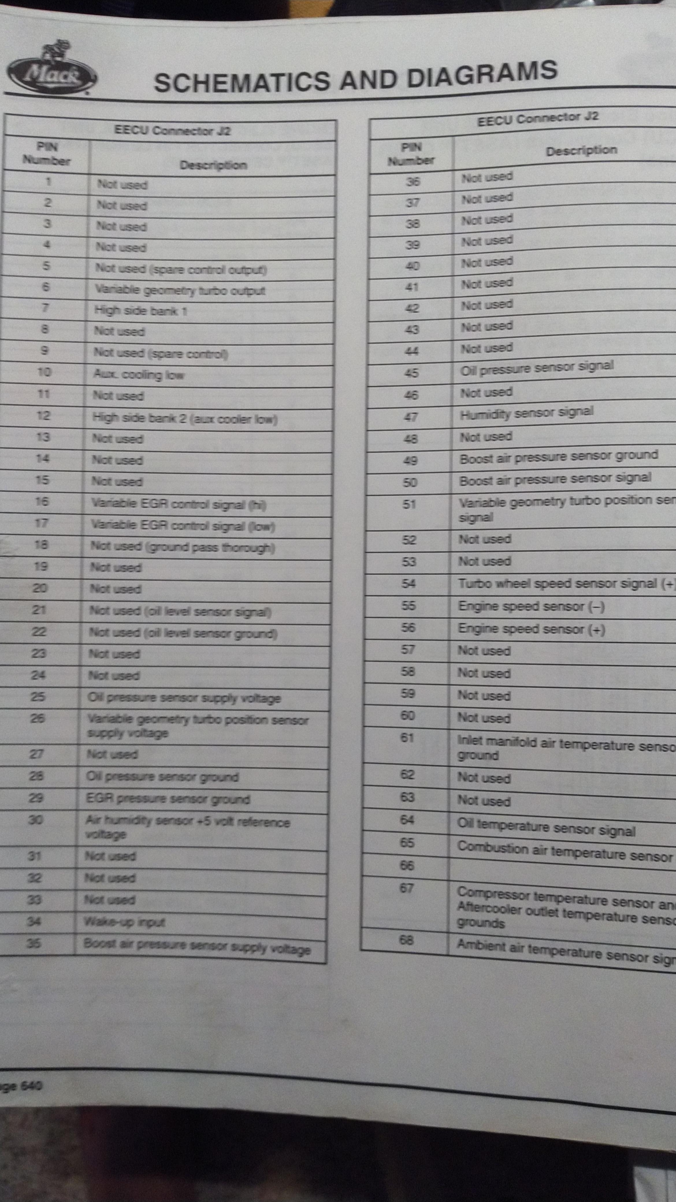

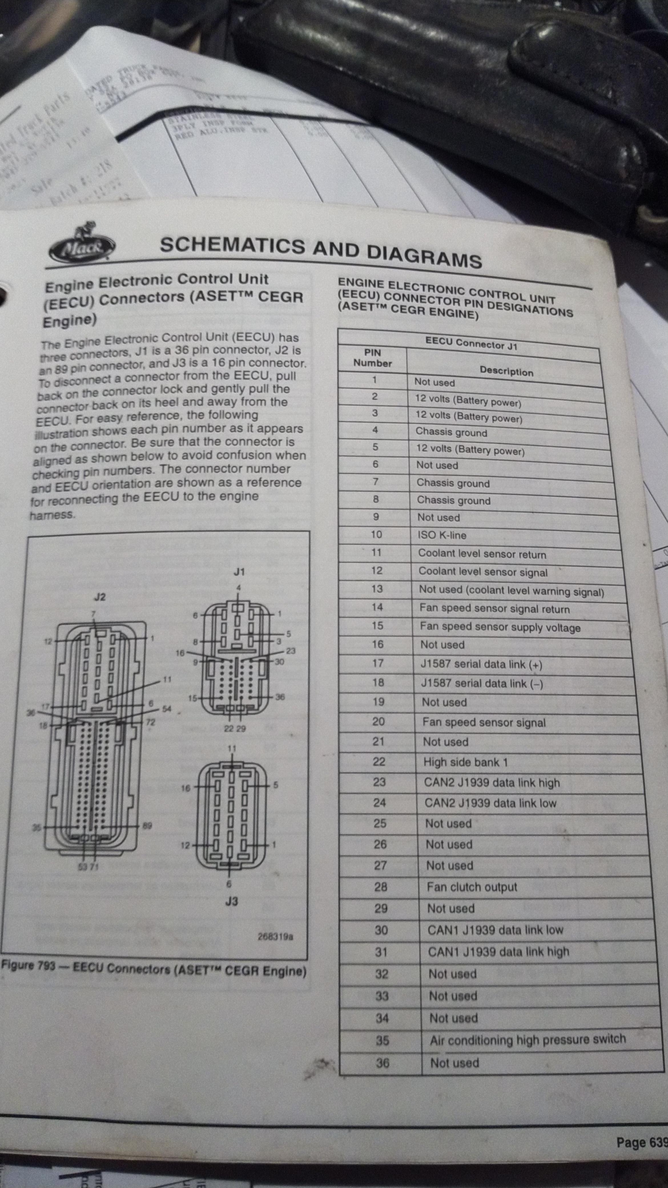

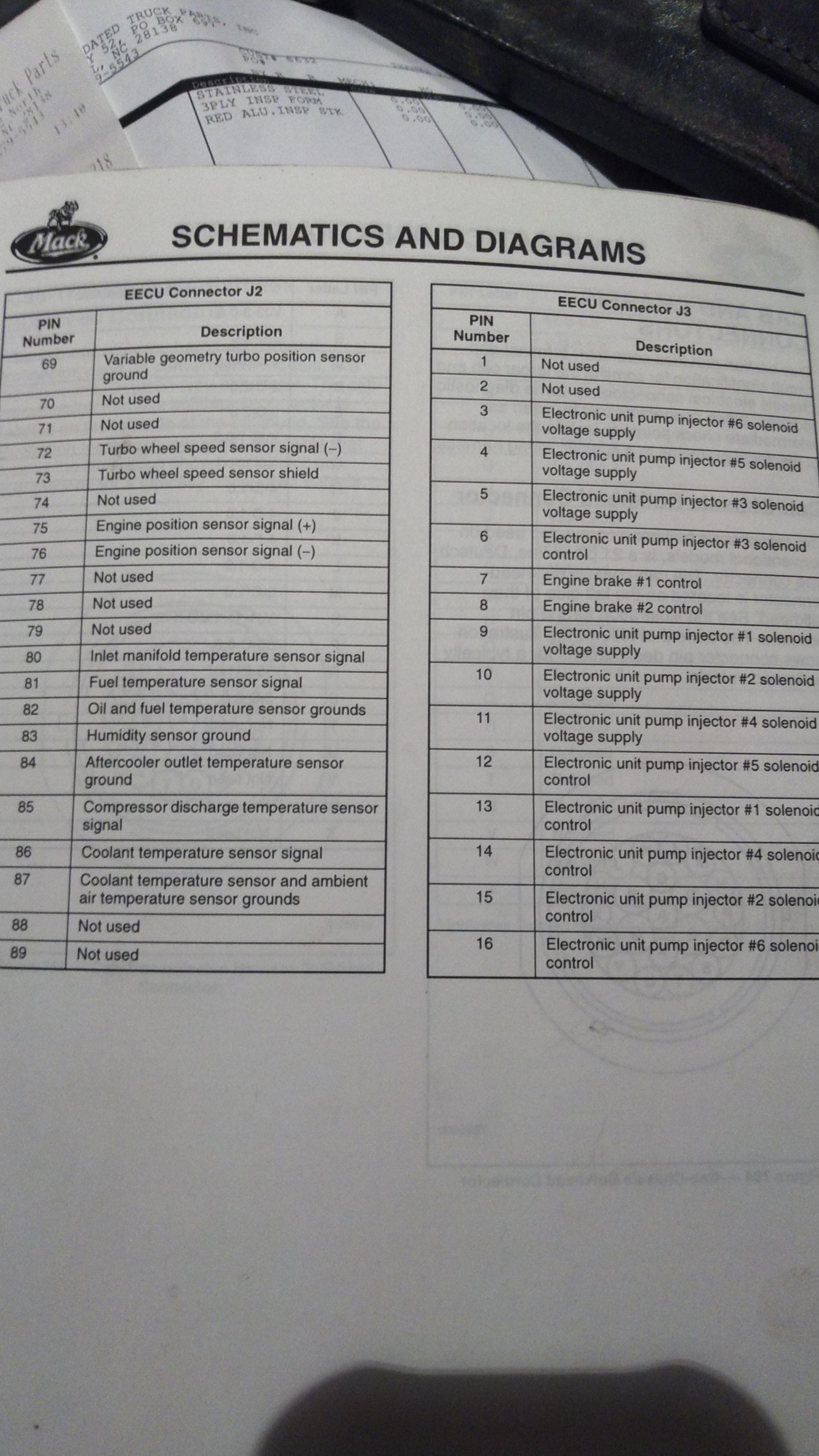

Not yet I’m going to do get under the valve cover this morning have you ever seen oil get up through a wiring harness like that I can’t think of any other way the oil would have gotten there. Id like to find a pin diagram of that plug to try and narrow down the possible culprit. Thank you again in advance you’re always a huge help!

Yes sir it’s an AC427 ASET
3 ecu plugs 1 big 2 small and the only thing that should be pushing oil through like that would be the oil pressure sensor correct? And if so I could just pull two new wires through the harness? And thank you for the diagrams thats perfect

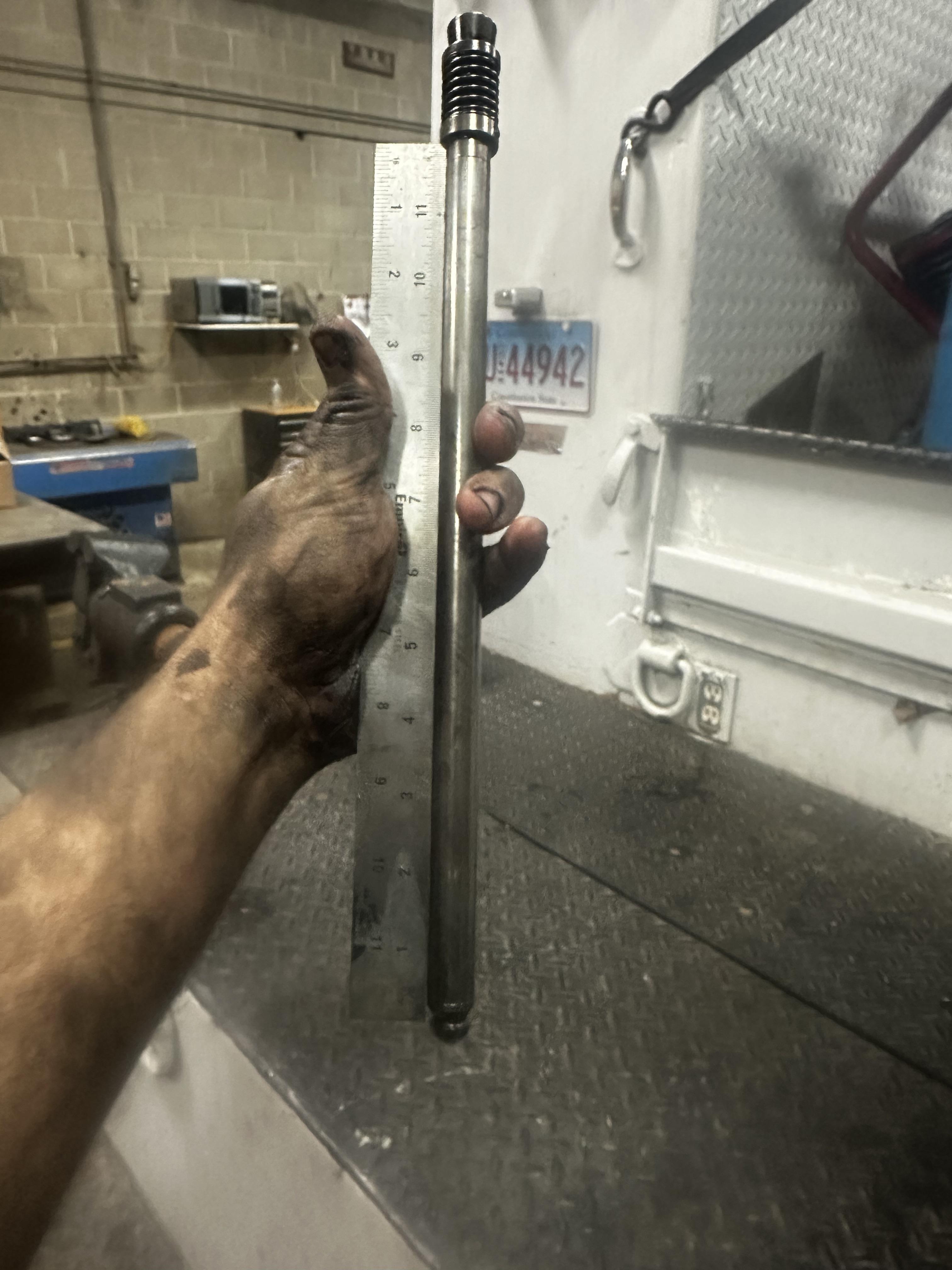

Actually I’m realizing I’m on the exhaust and the slop I’m feeling is in the spring so I may have jumped the gun as I went over the rest feel ok should I be able to collapse the spring on the exhaust side?
yes, when the valve is not being opened by the cam..  with respect...  how well do you know how to adjust the valves?

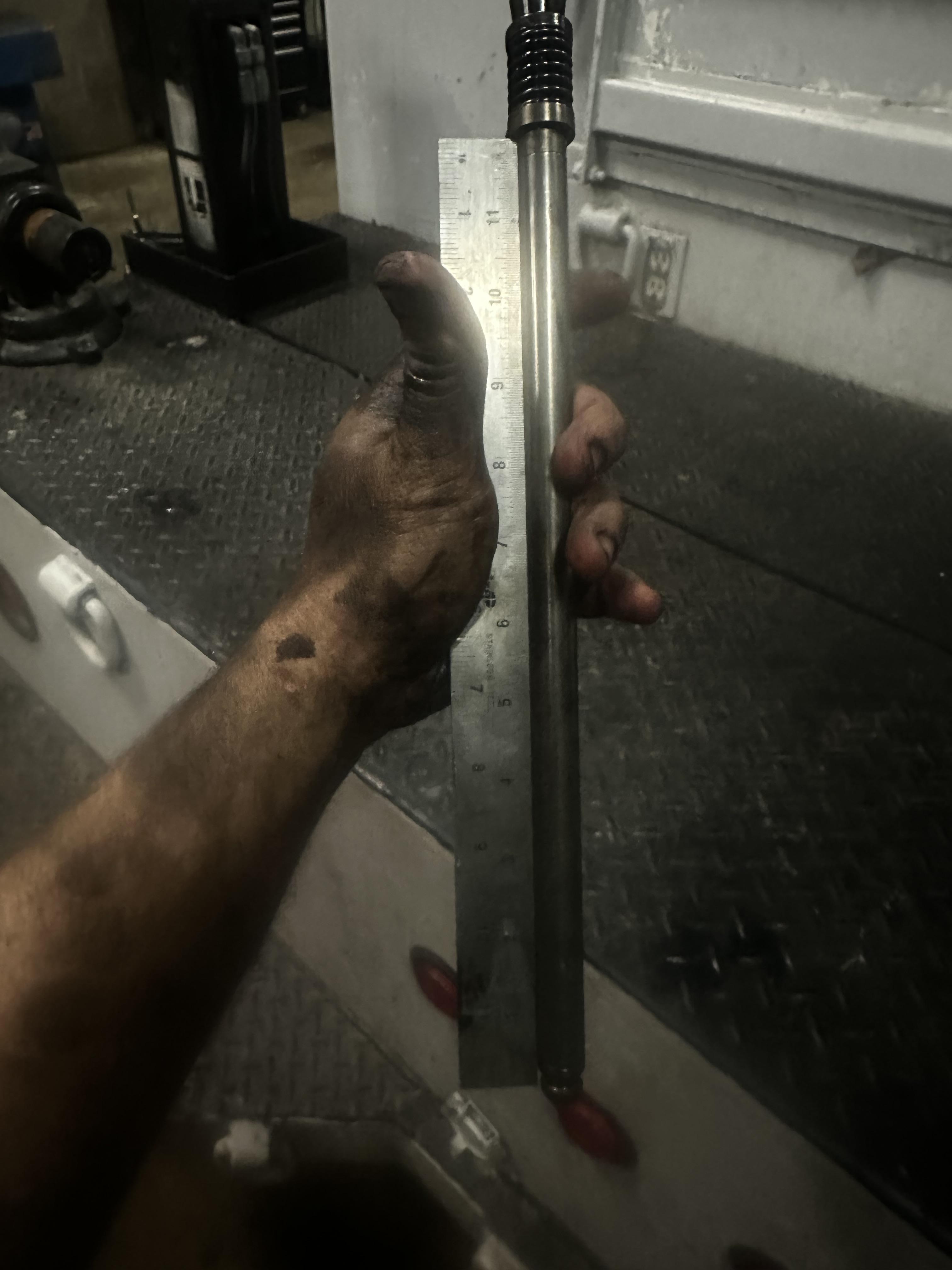

Pulled the rear rocker shaft and pulled the exhaust pushrod from #6 it dosent seem bent to me I rolled it on the bench and put a straight edge against it I’ll post the pictures below. Is it possible the over rev when it ran away could have knocked an h-ring loose? And as you said with ceramic rollers with that much play I imagine there’s a chance that one’s already done.
    As of right now my game plan tomorrow is going to be to drop the oil pan and take a peak from underneath let me know if you’ve got any other suggestions. As always greatly appreciate the wisdom.
