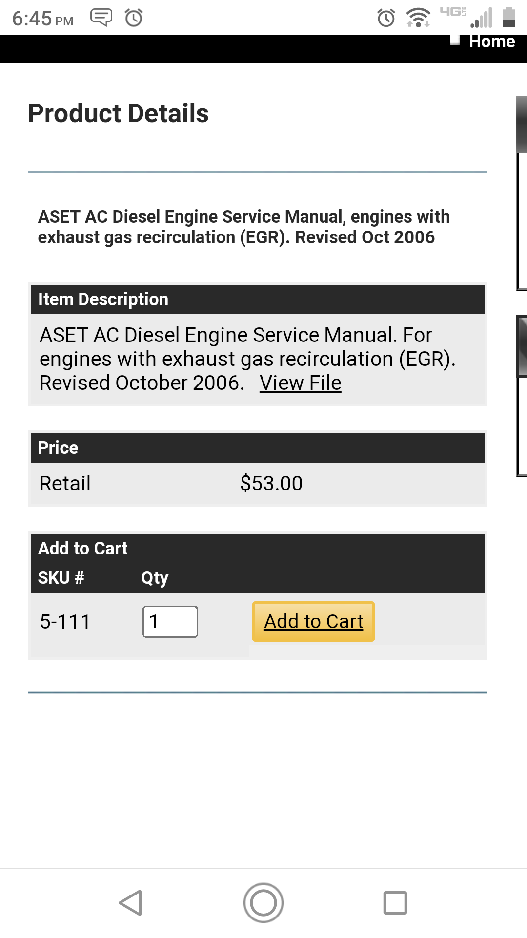

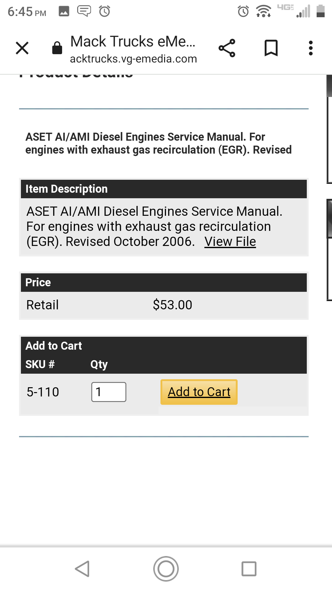

Since this is a 2006 I assume the motor is an ASET AC motor, I'd recommend the ASET rebuild/overhaul book over the ETECH one. It'll cover the minor differences on your engine regarding EGR system. The ETECH book doesn't have that info I believe.
Below are screenshots of the ASET AI book and ASET AC books on Mack's emedia website.
5-110 is the AI book
5-111 is the AC book which I assume what your engine is.  External EGR system.
The AI engines use an extra bump on the exhaust lobes to open the exhaust valves on the intake stroke to suck exhaust back into the engine for reburn.
