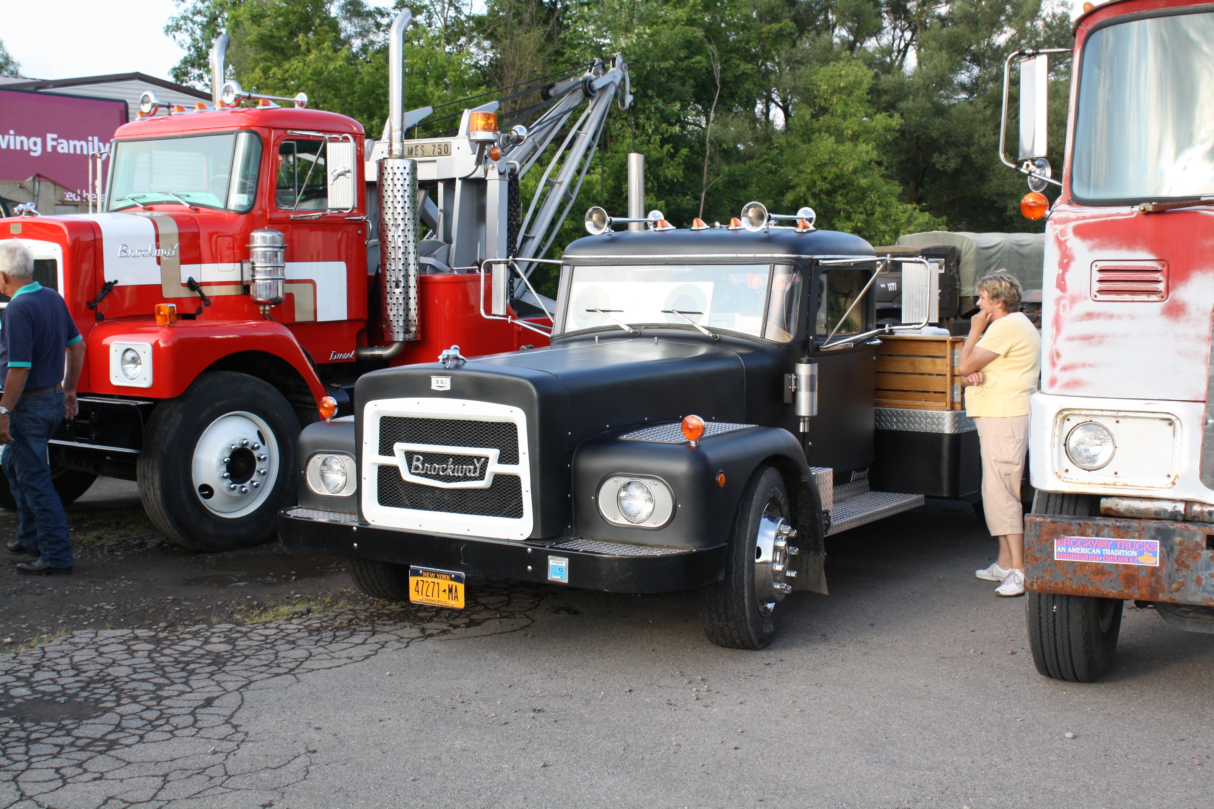

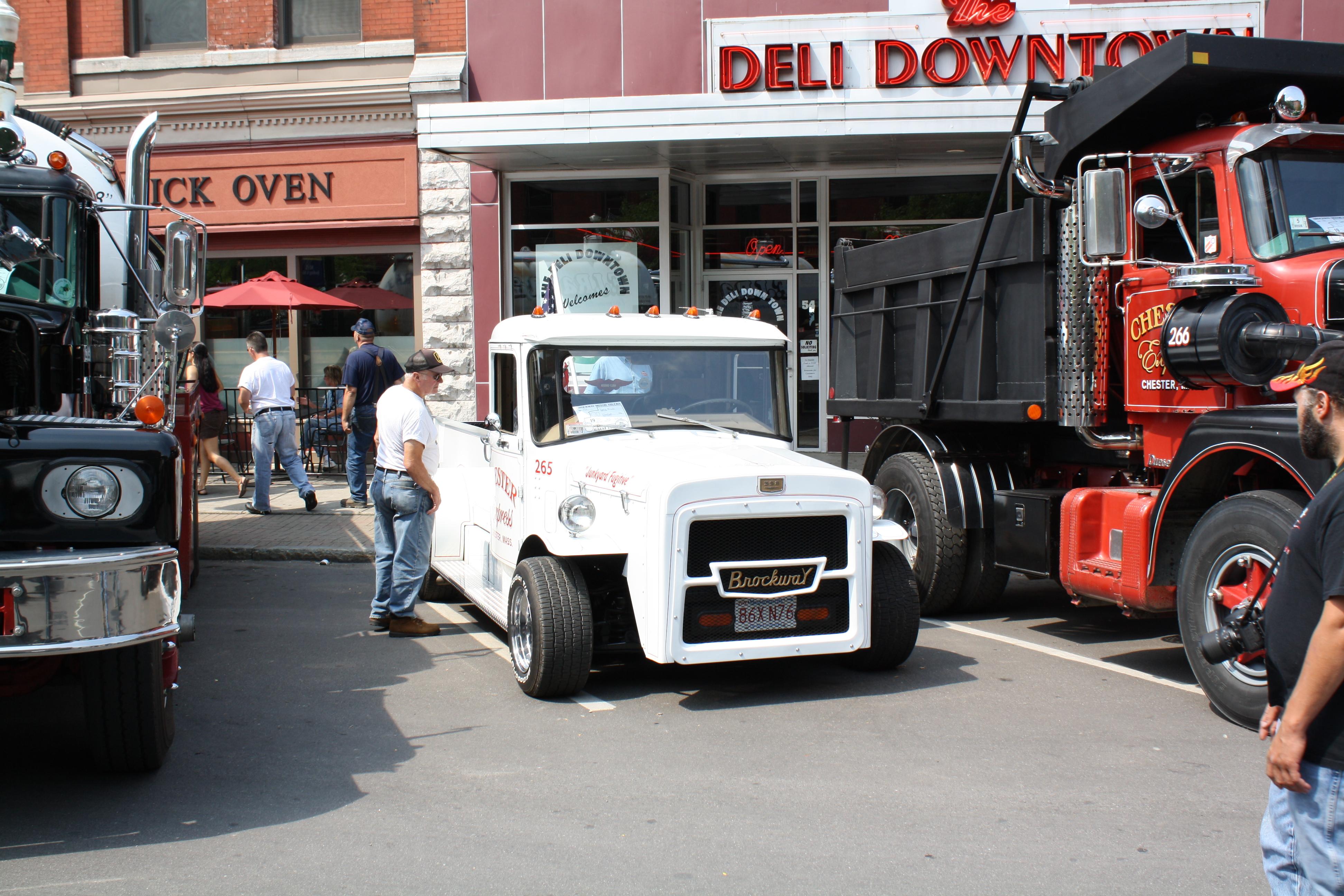

many yrs back my '77 F-350 dual wheel truck was showing signs of age and rust. a local road sealing co had small short nose Brockway used for back up emergency.  flipped the idea of a cab swap. would have made sharp looking dual wheel flat bed Brockway. like rest of my life everyone else iron took preference. time went by /sold the F-350.

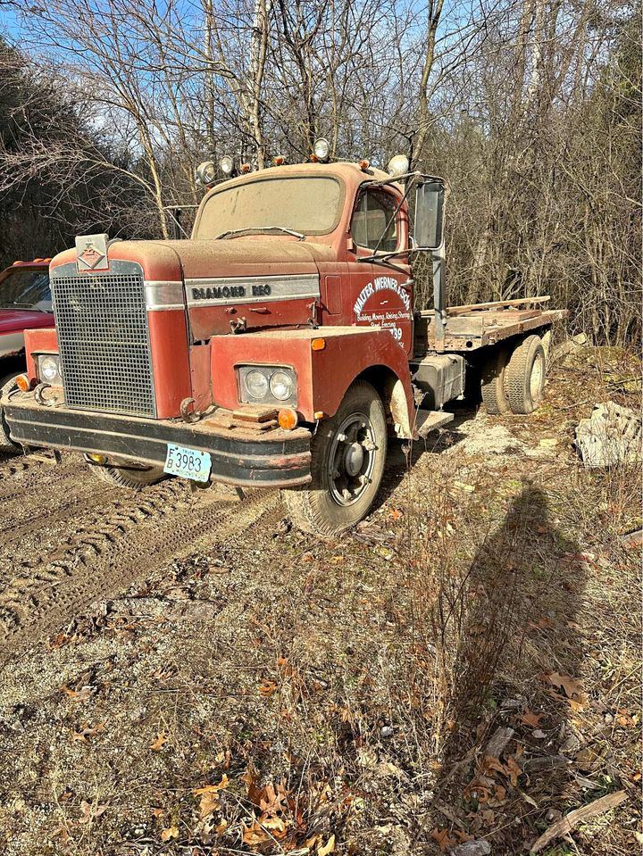

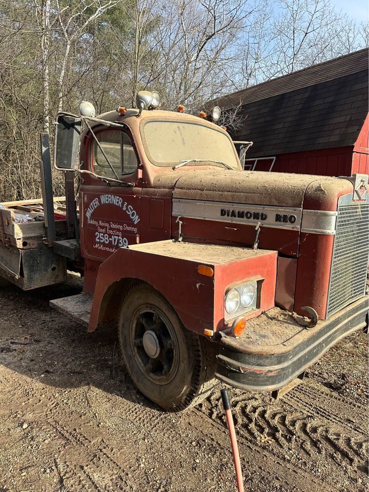

I also found this Diamond REO truck that would almost just right, but I think it is a little too big.....hence the interest (from what I THINK) is a little smaller cab in the Mack B.  The Diamond would, in my mind, be ripe for a 7.3 swap.....the issue is the two speed rear end.  How would that work out?  I don't mind a bouncy ride, but I don't want something that shakes your fillings out of your teeth.  Would one be able to add air ride to a cab of these ages?
That Diamond REO has some good possibilities!!! Do some cab interior measurements, that REO cab may be bigger than a Mack?? Then measure the operators, I am 6'4" / 250 lb and do not fit well in a lot of the older cabs!!That is the REO cab, BUT BUT NOT D/R fenders!! They look homemade?? Diamond T, Diamond Reo, REO and White 2000's all used the same fenders so you should be able to find a correct set. Is it a gas job or diesel??? If it is a gas job and you swap in a diesel, you will probably have to change the rear?? First you must make your choice of engine, the 5.9 and 6.7 Cummins are very good engines, Then determine the engine's operating RPM's and the cruising speed you want, then do the math to come up with a workable rear end ratio.. You may be able to kill 2 birds with one stone by swapping in an air ride single drive axle????
Please keep us posted on you thoughts and progress.
I'm 6'0" / 200lbs, I'm no giant, but my concern is just having a giant truck.  I had a 1993 Kodiak, that was too much.  Anyone know how this Diamond compares?
The Diamond is a gas unit, 2 speed rear end.  I love the idea of the Cummins, but they are always soooooo expensive!!!!!  Is it possible that the existing transmission could be used with a Cummins?  Anyone know what the highway speed of a truck like this is?

Here are some more shots.

You have a LOT of research to do before you make any decisions.. I do not know how much a skid steer weighs but it would take a pretty good sized old farm tractor to get above 10,000 lbs.. The Brockway in my top picture was a U-Haul IH chassis (one of their big vans) and power train on 17.5 tires, which is a good size, and long enough, for what I think you are thinking of building?? I took that picture in 2012 at Cortland NY so God only knows where it is now to find and contact the owner!!! Contact the Public Relations office of your state's "Diesel Cops" as to what licence category you will need?? Most states if you are only going to use it to take stuff to shows and DO NOT DO  any revenue generating work you may not need a CDL??

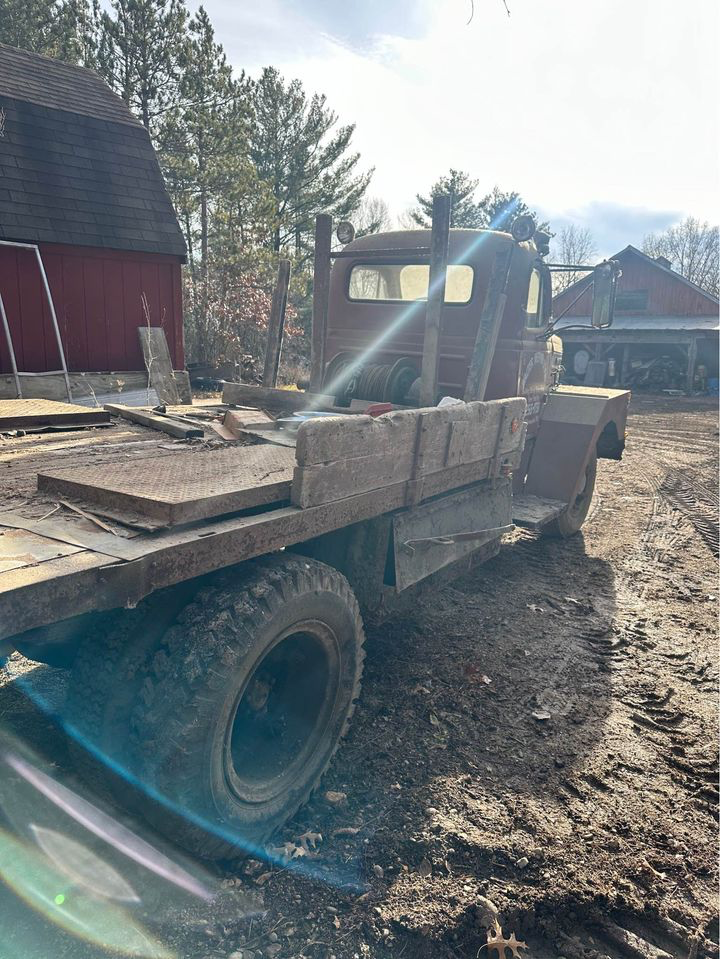

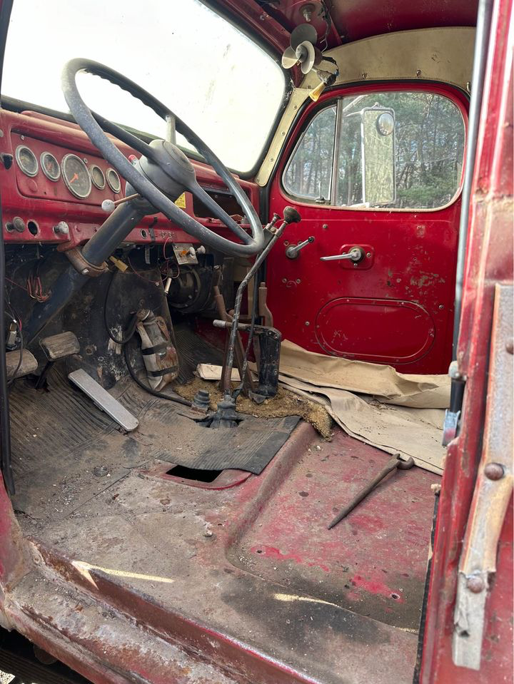

The seller added some photos and added this info on the Diamond REO:
Engine Model: 6-170
Transmission: 282V
Rear Axle: 16220   H-1760
Front Axle: 32550   HX67
Steering Gear: HPS70
