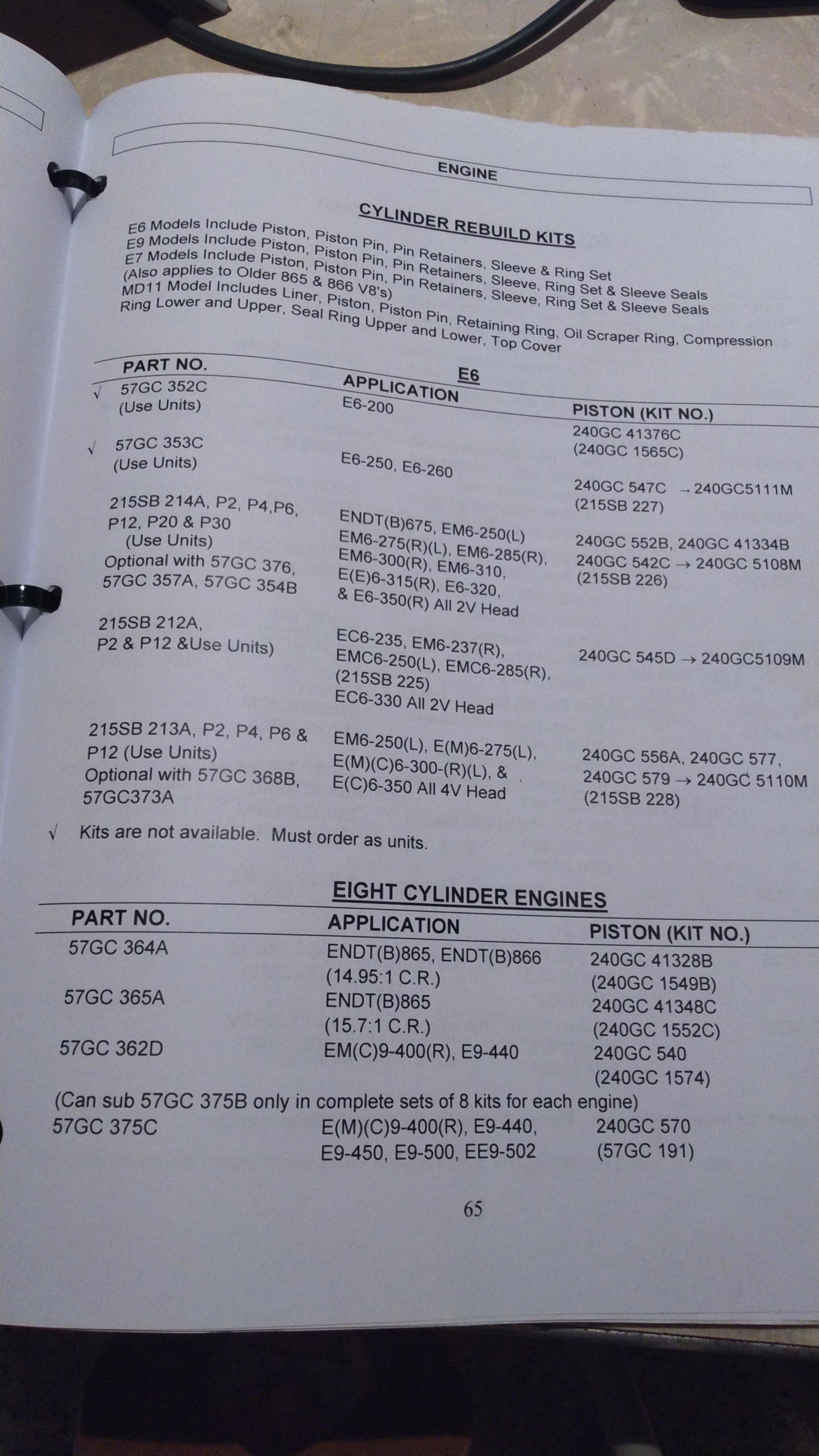

KIMG0511.thumb.JPG.4820828a97039de81460e28729f122d6.JPG    Keith S,,  If you can get a hold of this book, it has a ton of part numbers..  however, I did not see the # for 18 bolt head gaskets..

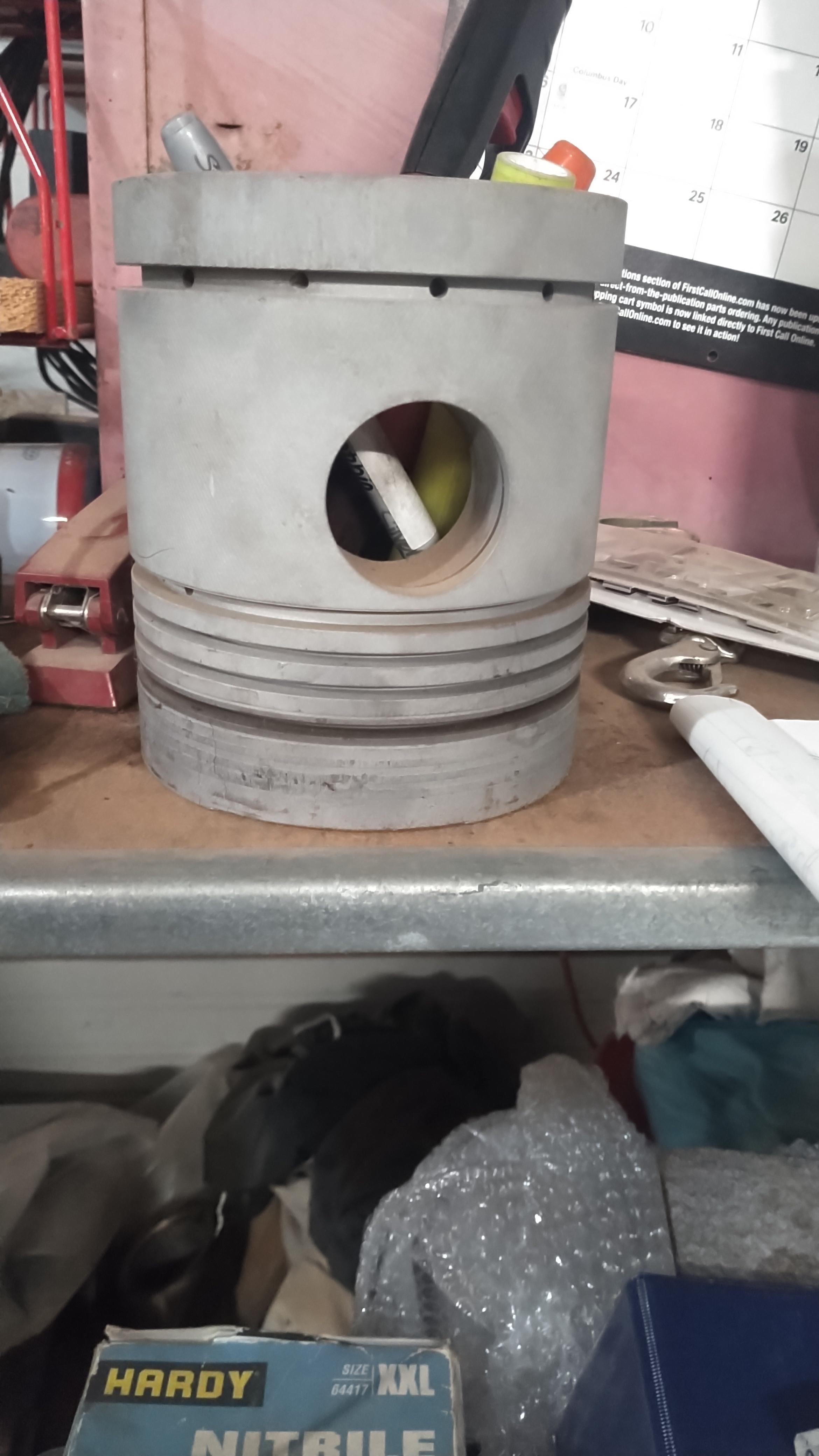

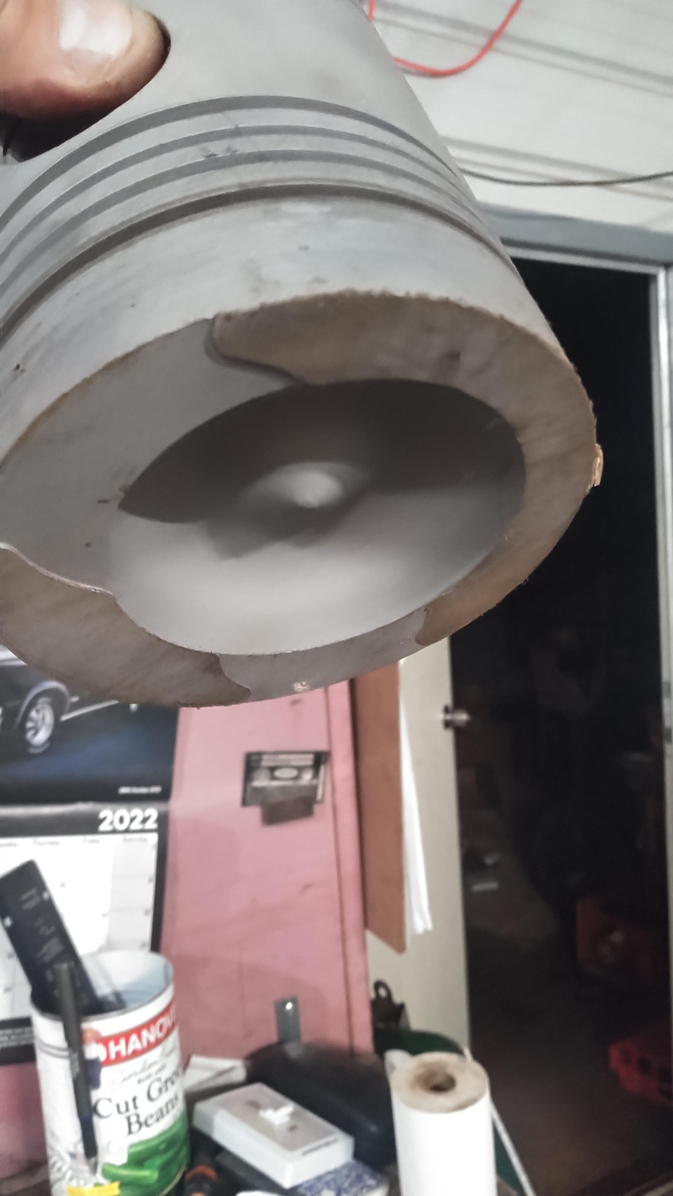

I know that one of the END's I took apart had one piece pistons that were longer with more rings. But I think I put updated 2 pc. pistons in...   I dont know why I am forgetting..  As you can see,,  for me the old pistons are good for pencil holders.. :)
they may hold a lot of pencils today ;;but those one piecers  pushed a lot of horsepower back in the day. pencil holders are in government offices today. LOL just sayin.  now  jack daniels wait your turn to speak.
  • Haha 1
there is a machine shop in Charlotte that said they could ceramic coat the old pistons for re-use..  we opted out, but I would love to see them installed and see it run, for a couple years..
