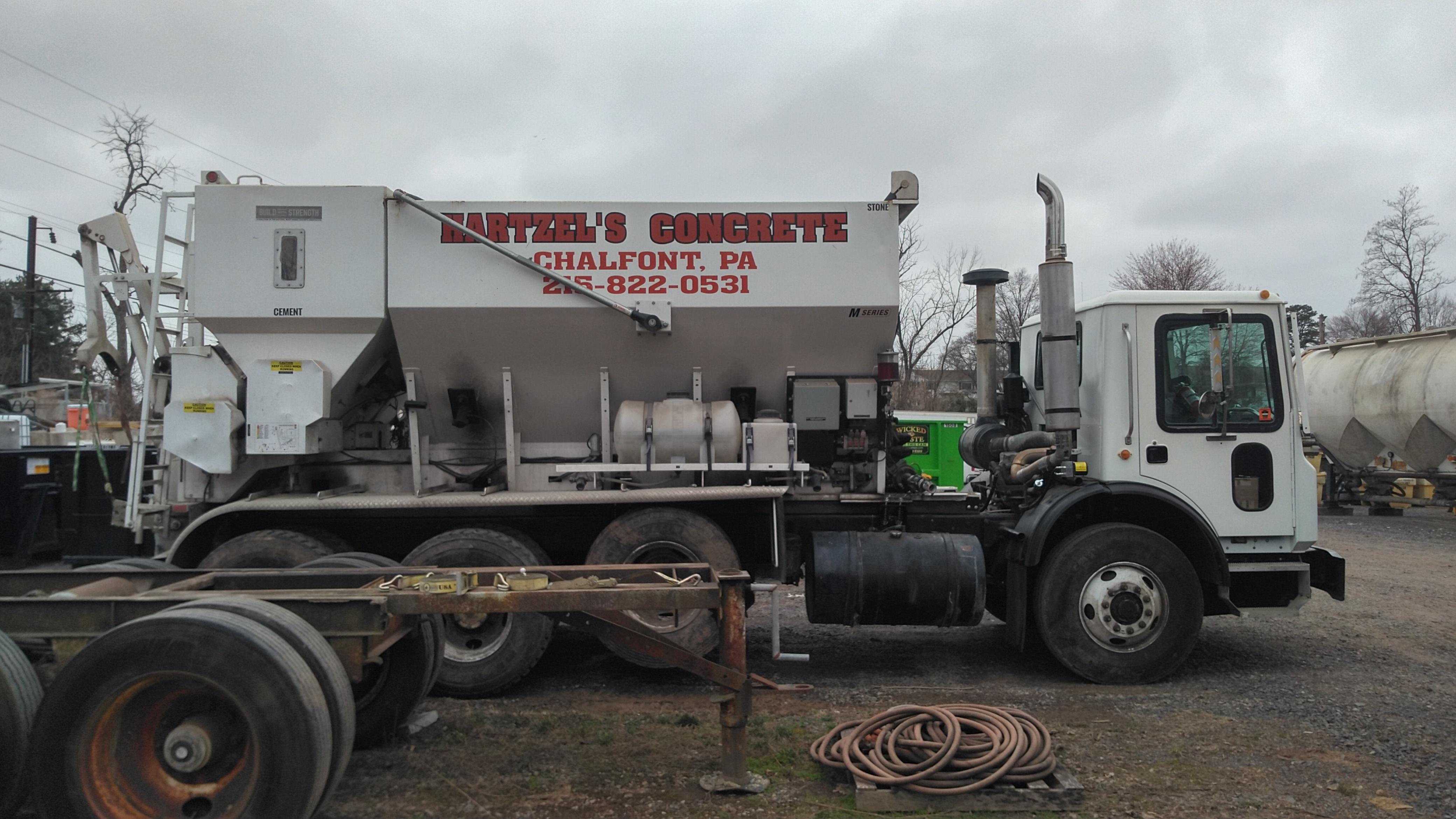

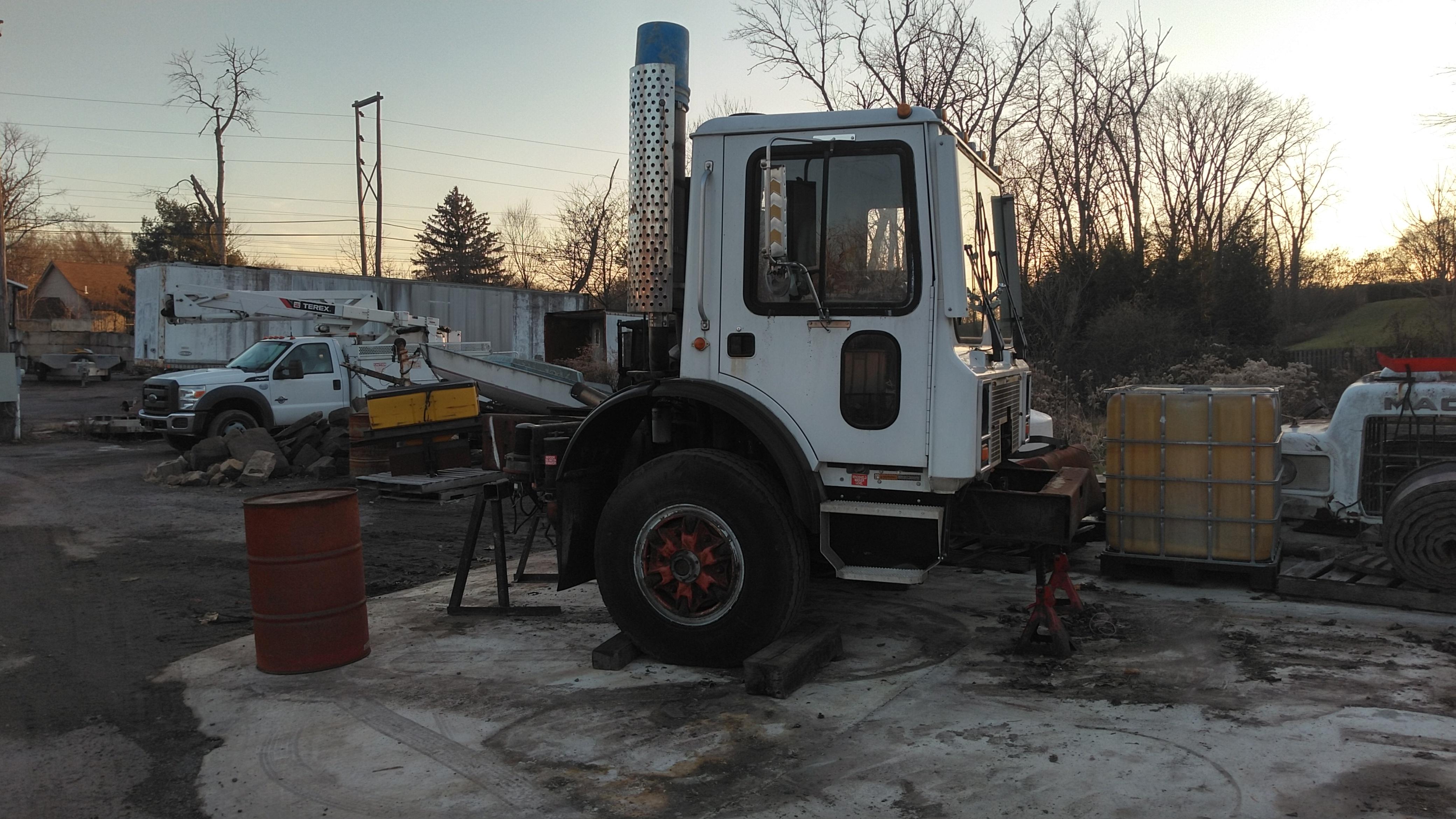

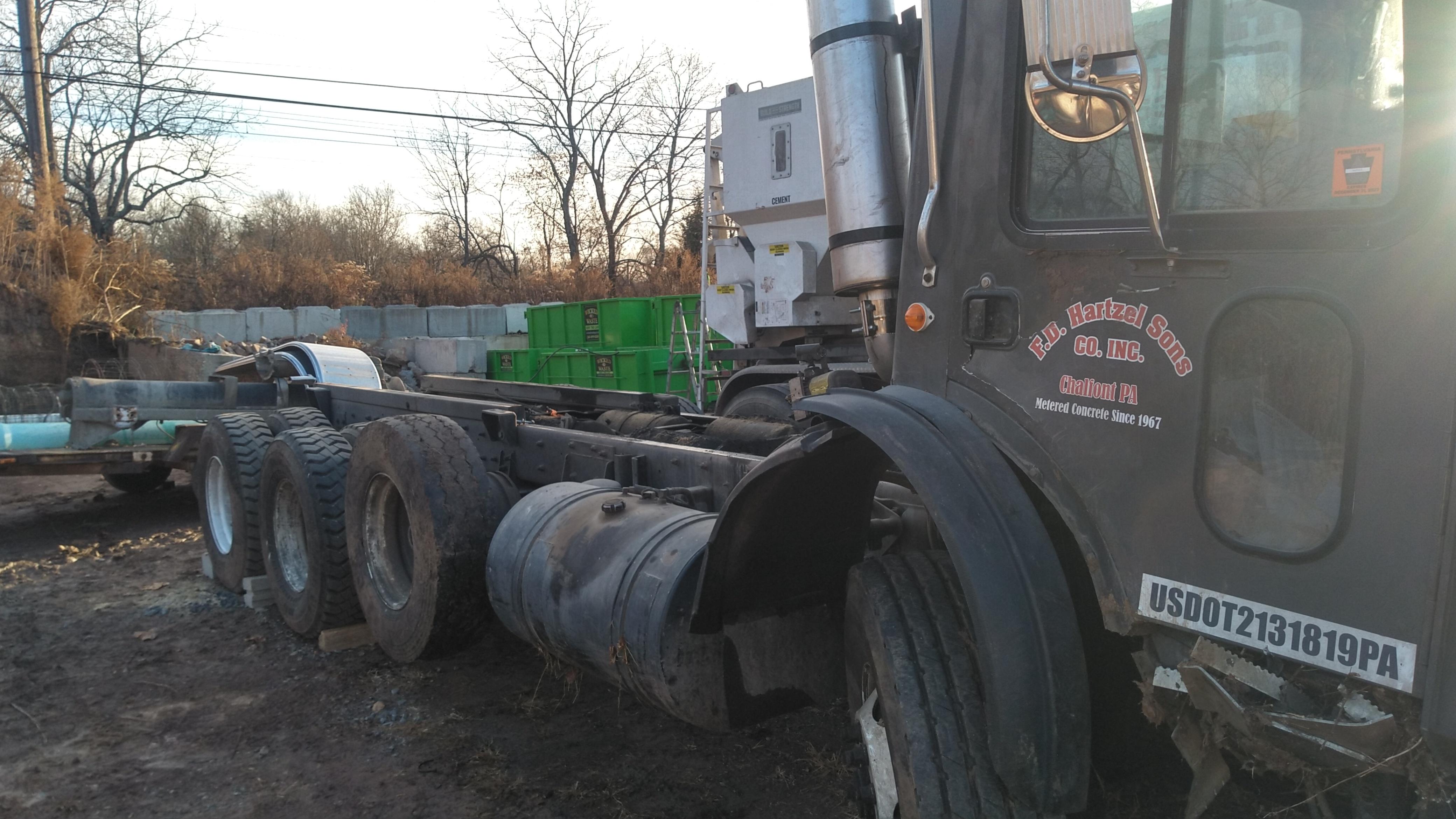

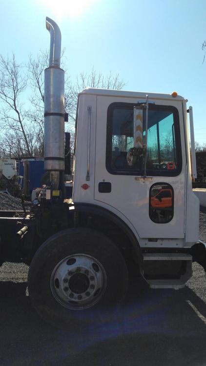

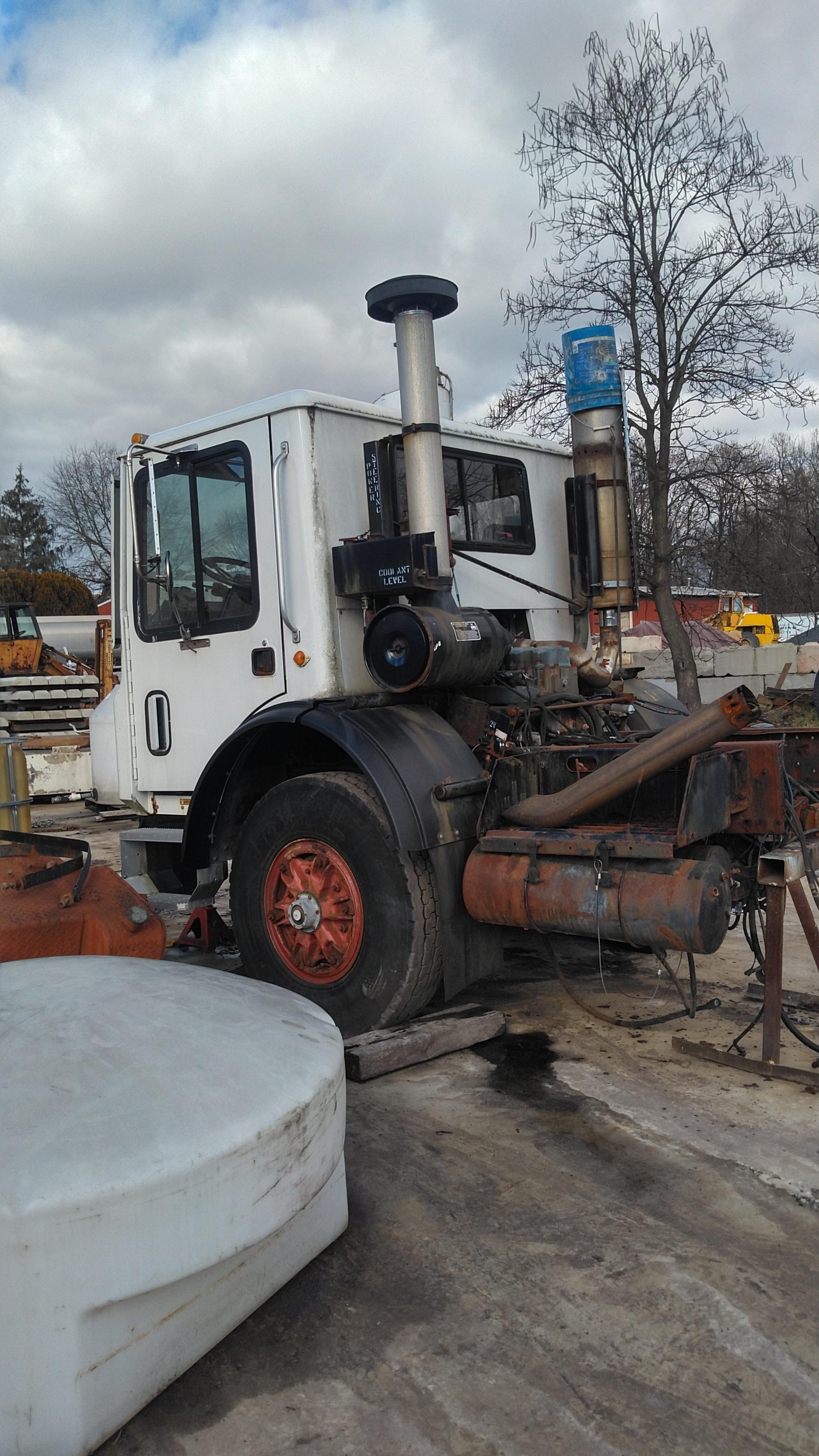

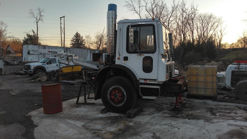

In the grand scheme of things the exhaust bracket was pretty low on the list, but yes it needed to be done, lol.  Nothing bolts to that stand other than muffler, plastic fender piece, and the cab jack pump. Mack wanted about $650 for the stand, but I think we got it straight enough...

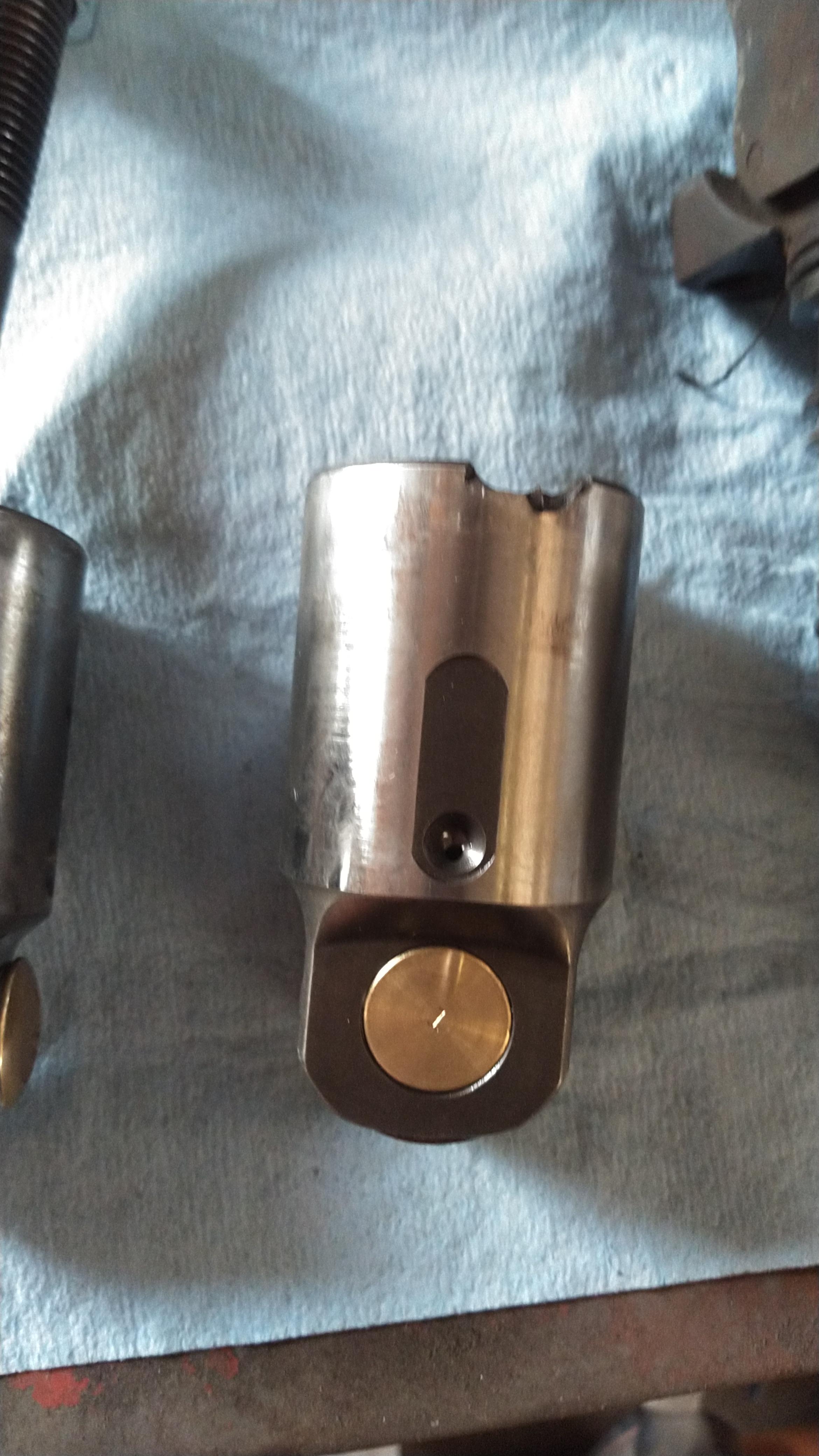

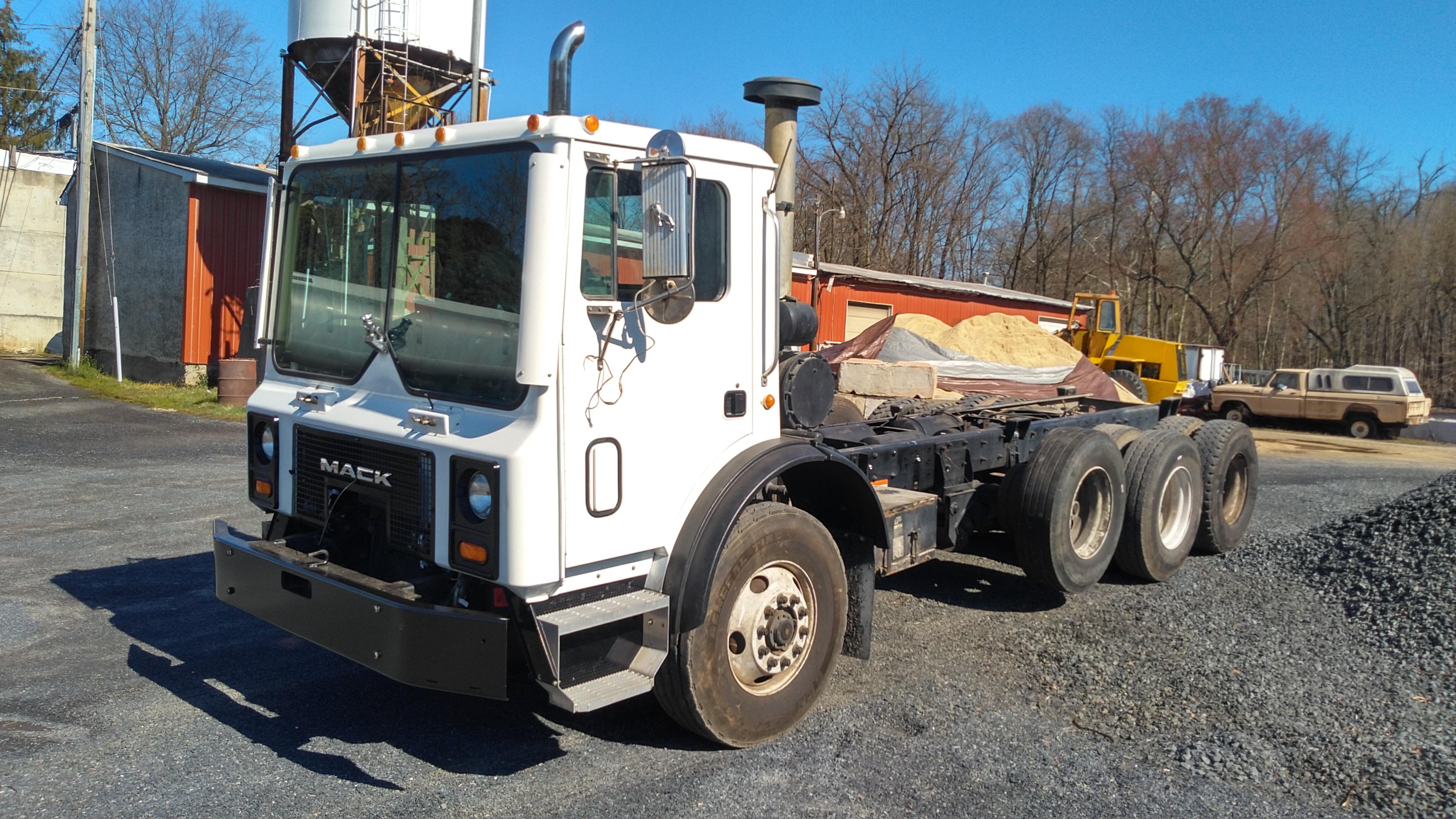

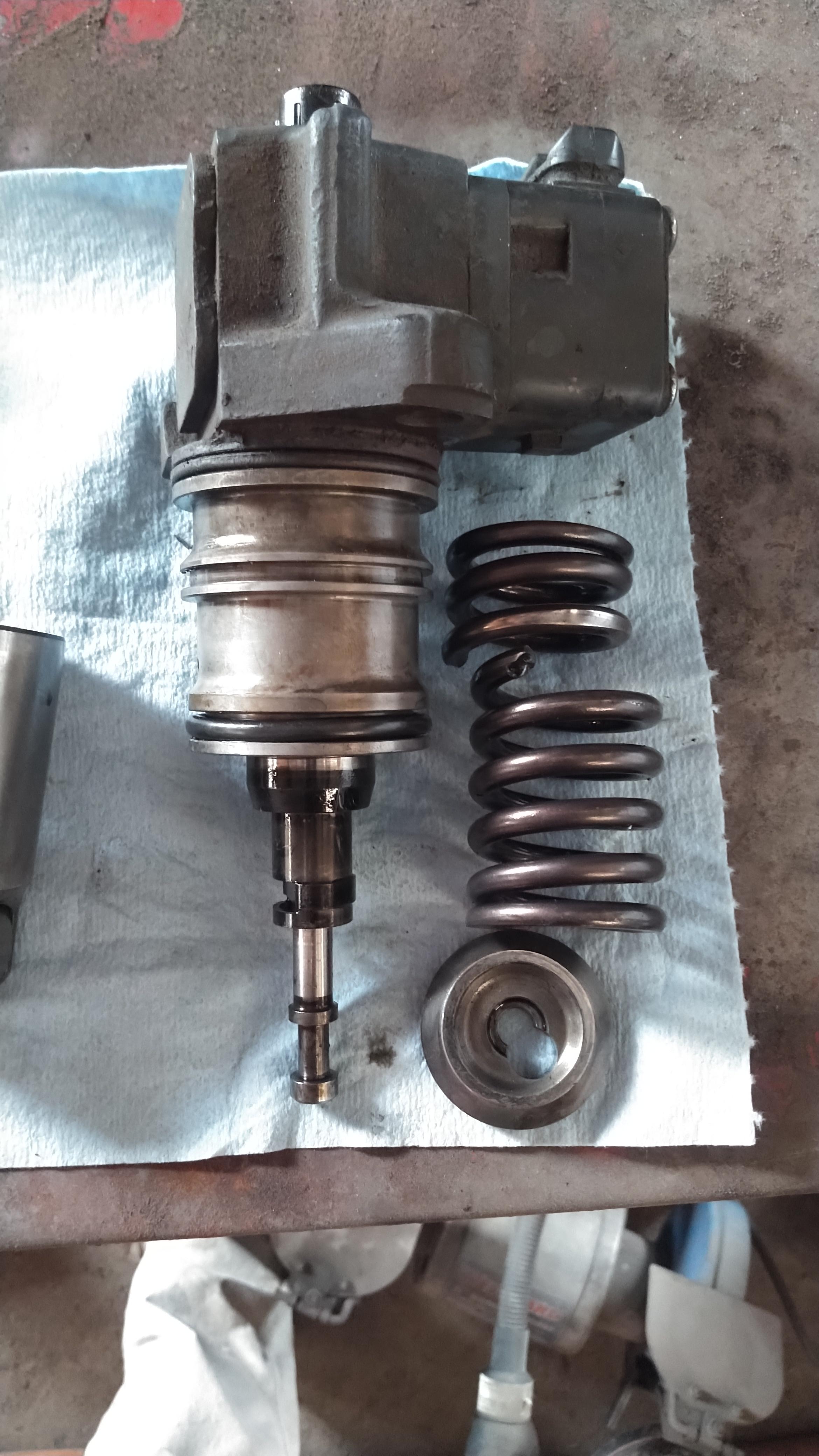

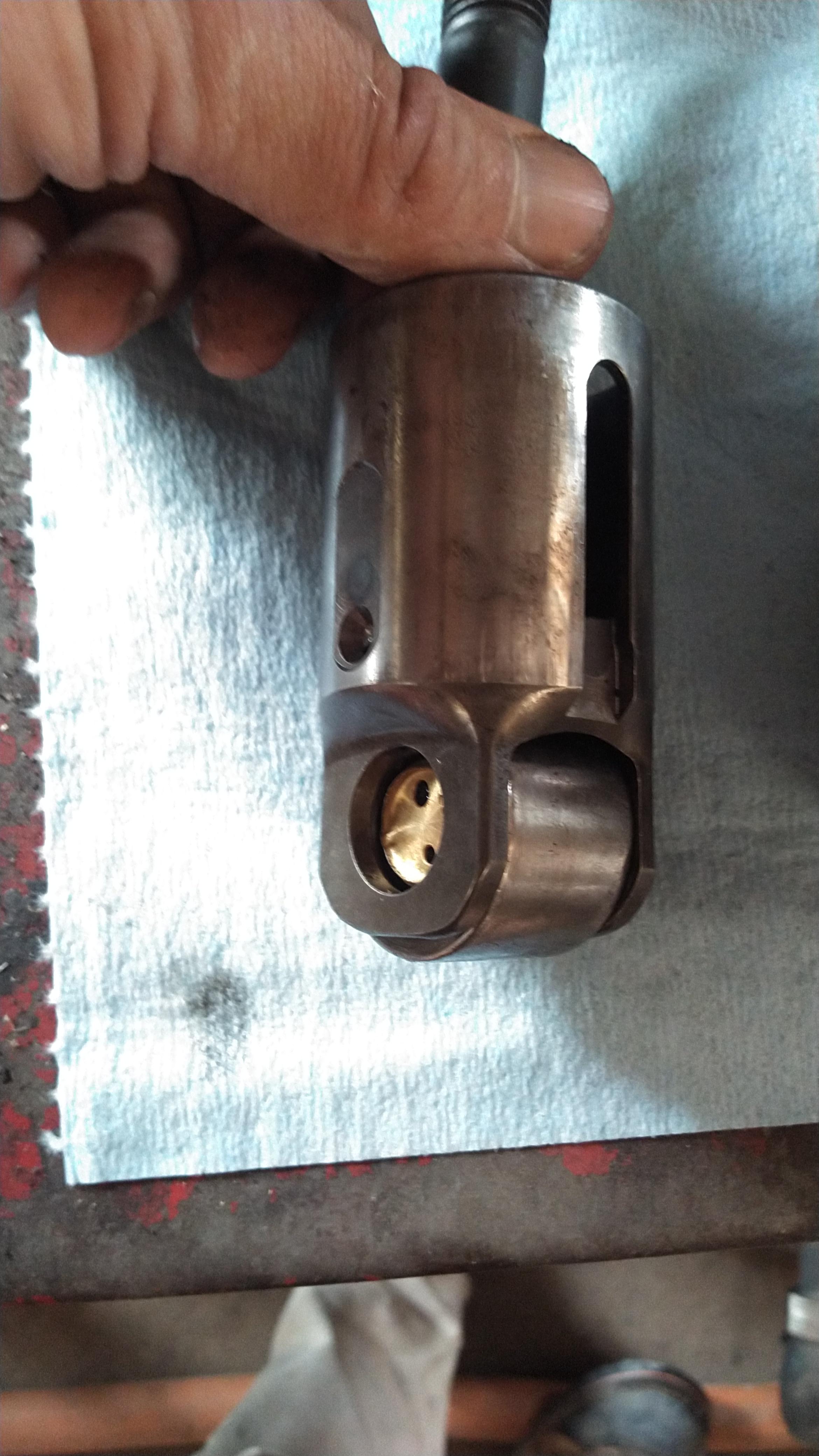

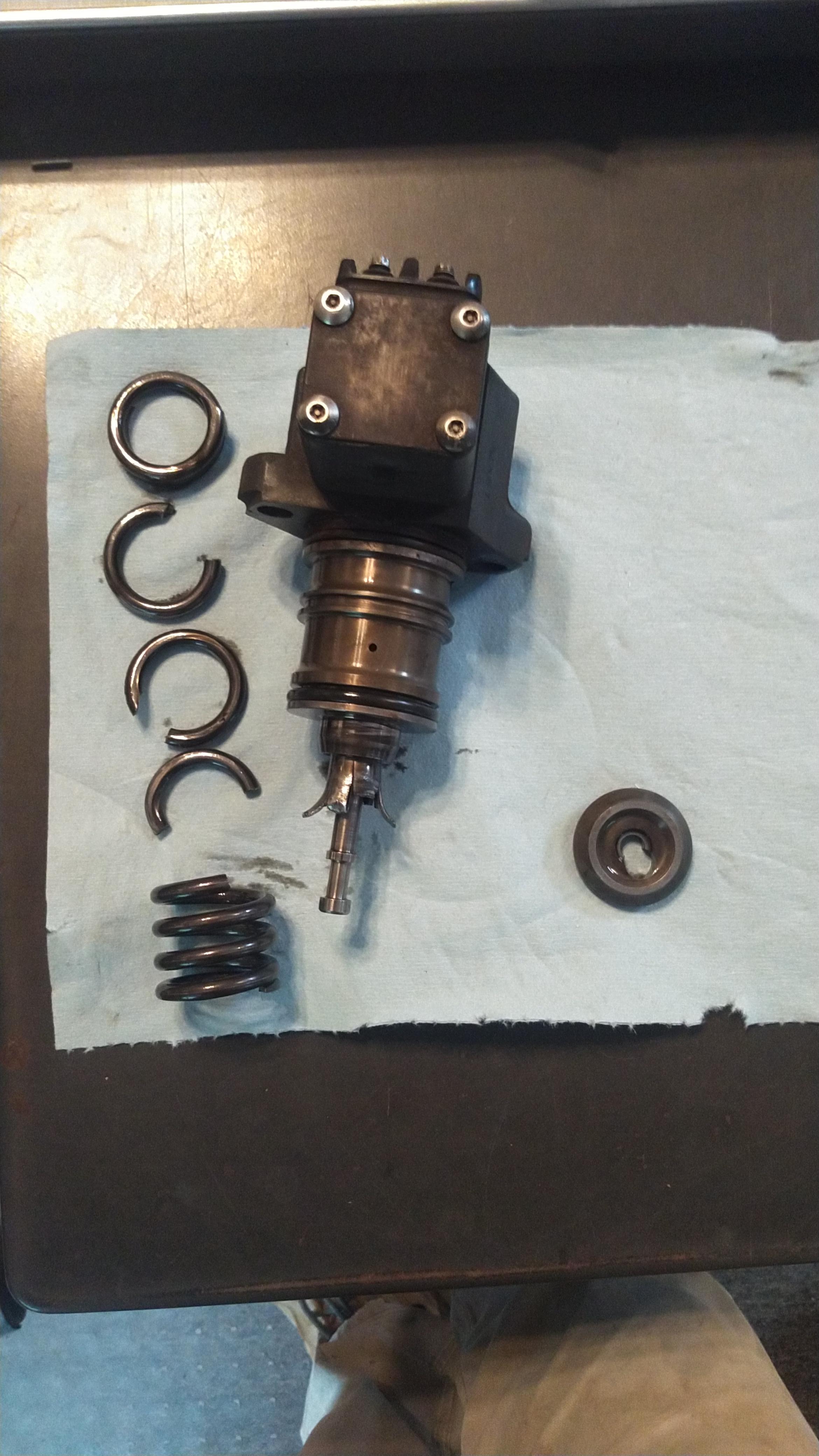

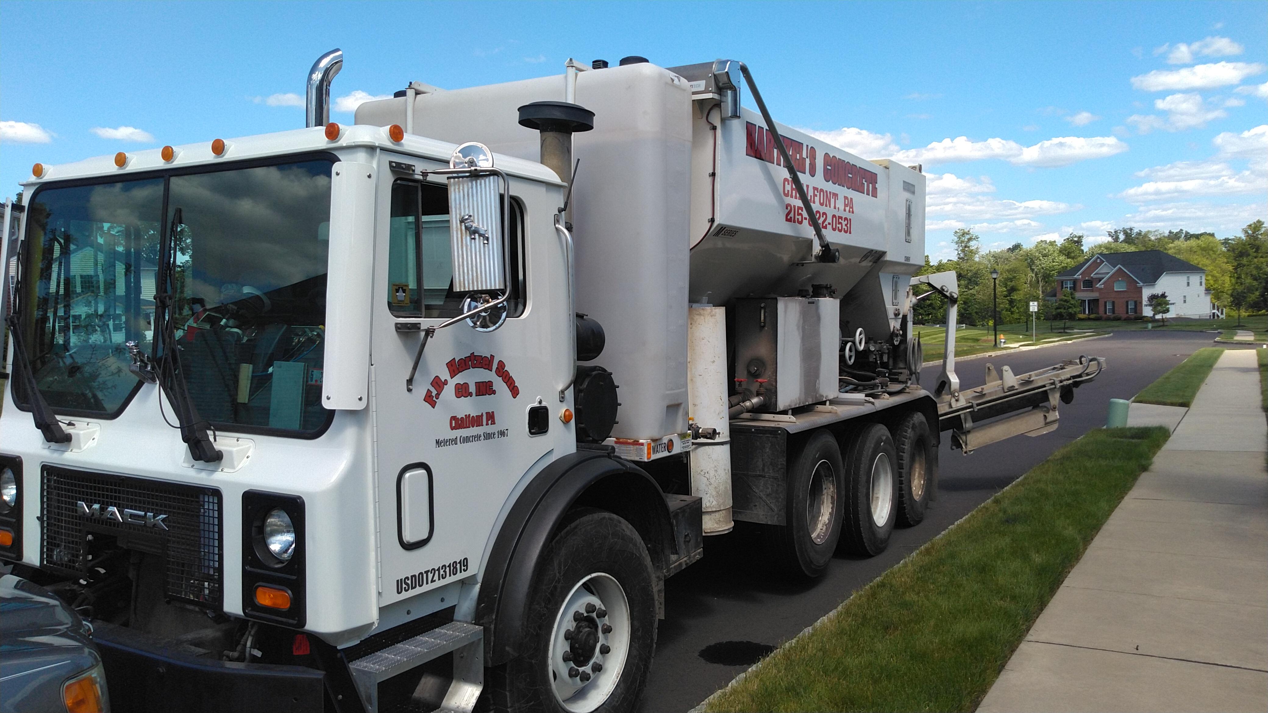

Truck is at the dealership getting the go-over and so far with the stumble all they've found is a failing valve rotator, which yielded some small bits in the oil pan and an out of adjustment valve. Cam checks out ok, they don't suspect eup's as there's no knocking sound from the eup "jumping" off the lobe. Cam also looks great from underneath, and they measured the cam lobe heights with dial indicator on the valve stems.
They'll put 2 reman cylinder heads on it, plus whatever peripheral junk goes along with that.  It's gonna cost an arm and a leg, but I have no doubts regarding their competence, and it's gonna be done a whole lot faster than doing it ourselves.  And we need this truck done ASAP.
