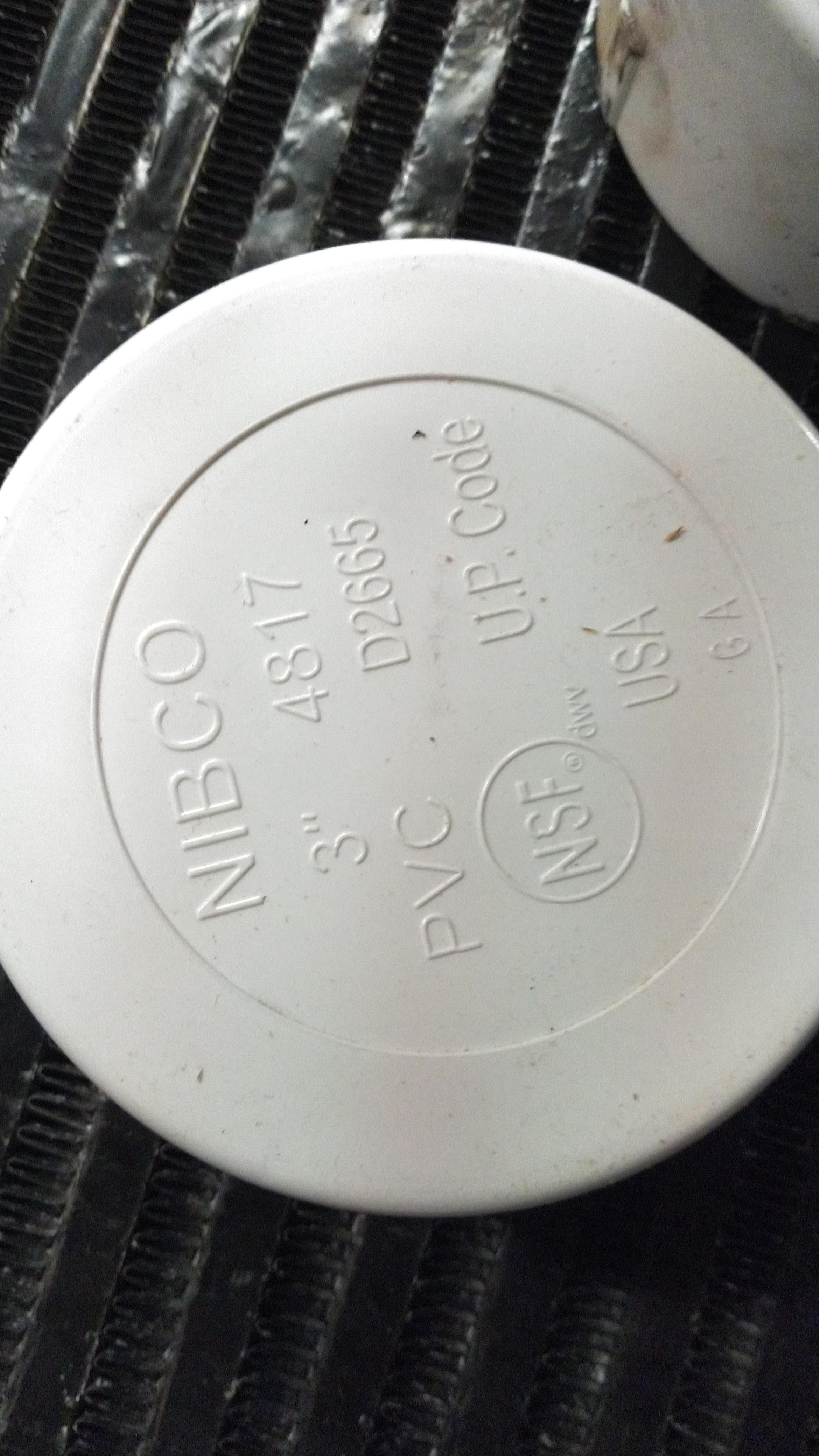

My CAC testing kit. Two 3 inch PVC pipe caps from Home Depot, one with a wheel valve stem for pressurizing. Third fitting is a 2 inch cap wrapped in electrical tape to make the difference to the 3" required by my MR688S. Uses a different size CAC outlet than my RD688S. Just tossing this out there into the Abyss of BigMackTrucks info.
