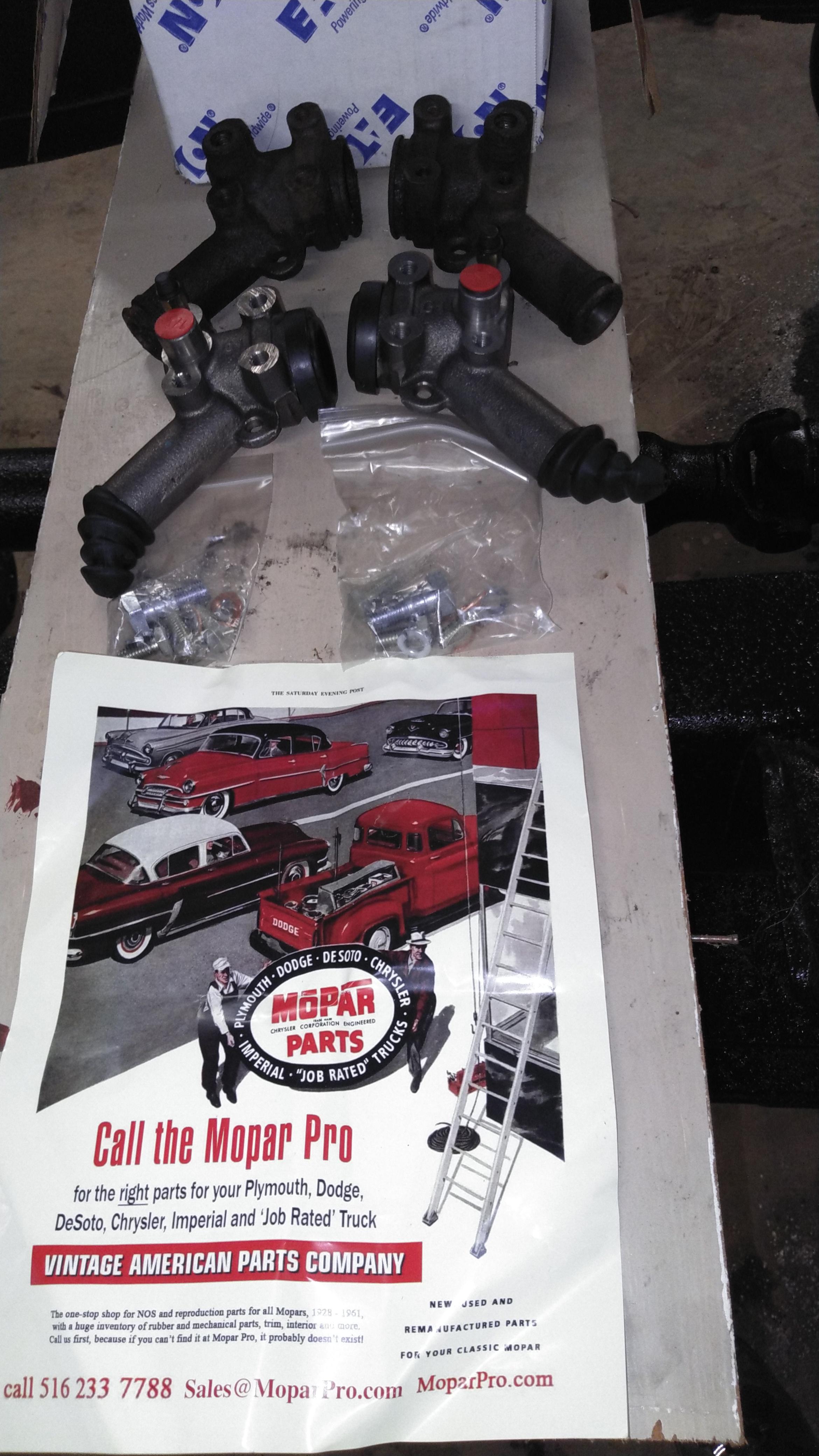

Well I ordered from Friday parts and got the wrong cylinders so I’m awaiting their return options! There are several options for this machine and it’s by serial number! I ordered 20000 vin or less and what came was wrong ,my vin is 16000 but I still need 20000 plus the difference is the bore size 7/8?vs 1 inch I need the one inch😡
I feel your pain.. The same thing happened to me with my KB-7 wheel cyls.. I got lucky, the seller sent me the right ones before I returned the wrong ones..
