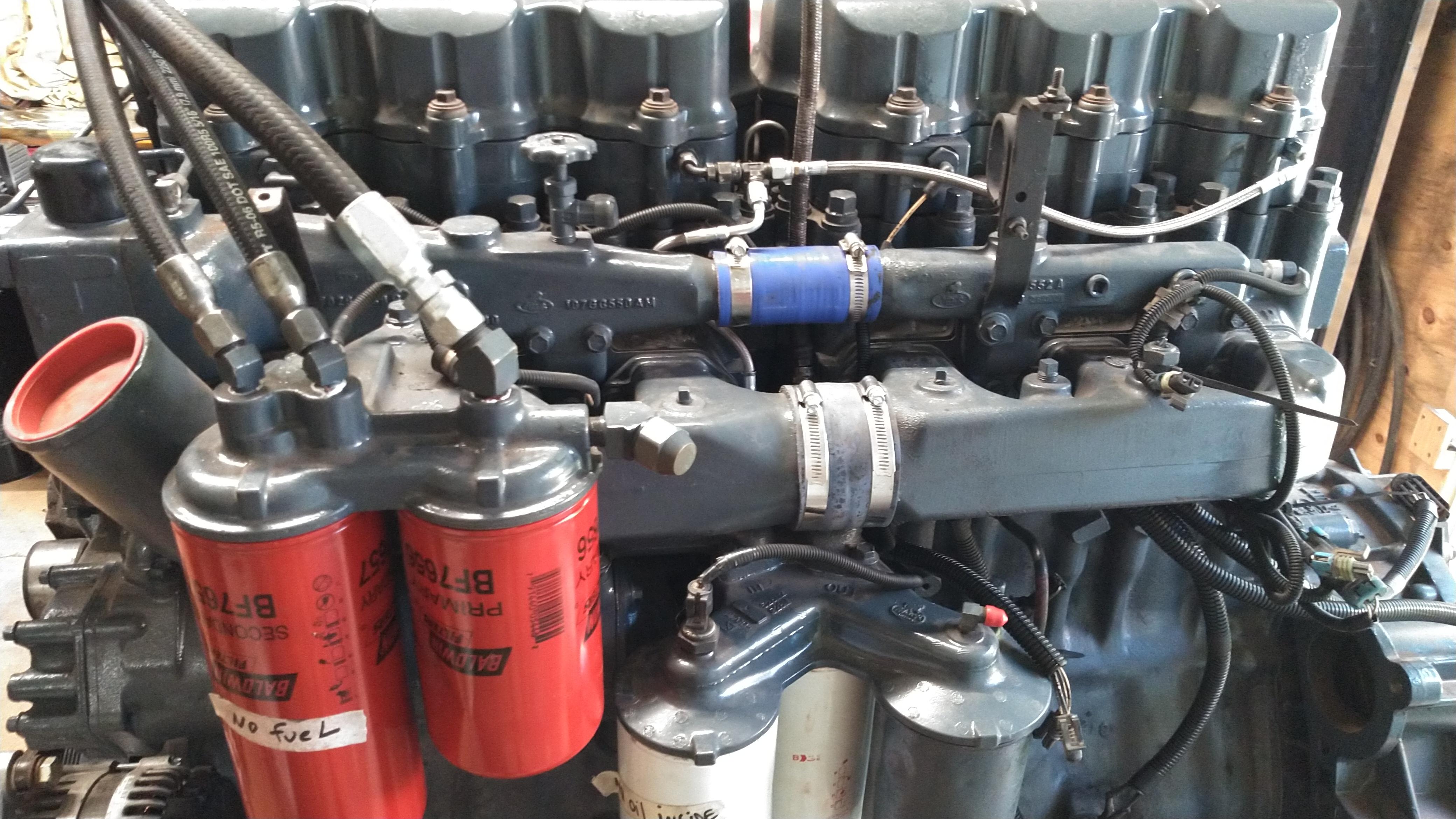

4 hours ago, Joey Mack said:
maybe I need to post an ad..  Bring me your E-7/ E-Tech's and I will rebuild them.  $5,000.00 labor, plus parts.  You can supply the parts as long as I approve of them.
Here is what it will look like when its done..
What not painted !! LMAO> looks good. hopefully questions on other topic discussing new lines and fittings will look at this picture to see older style fittings vs new two piece fittings. new style #8 going in older style #6 out/return?
