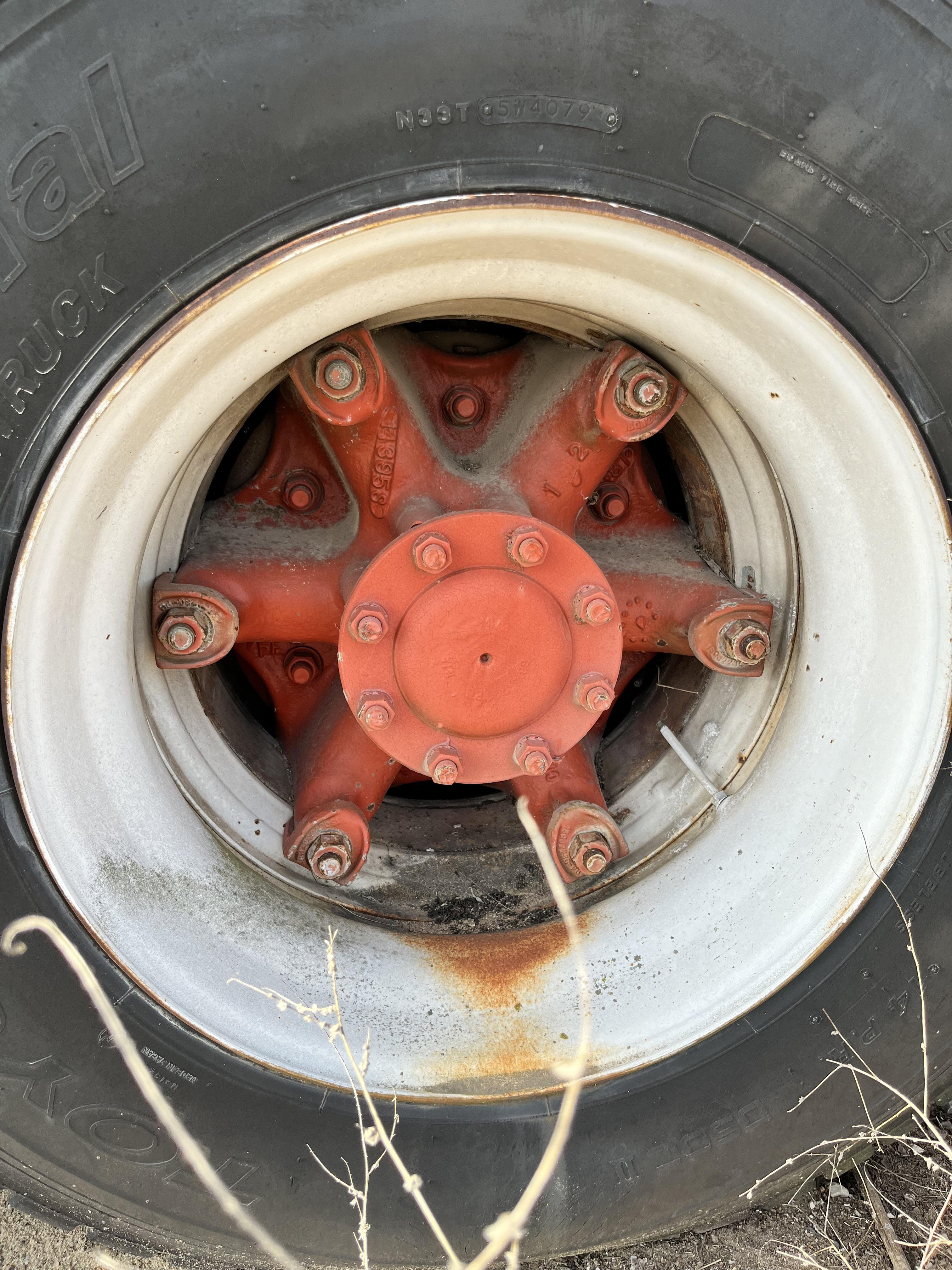

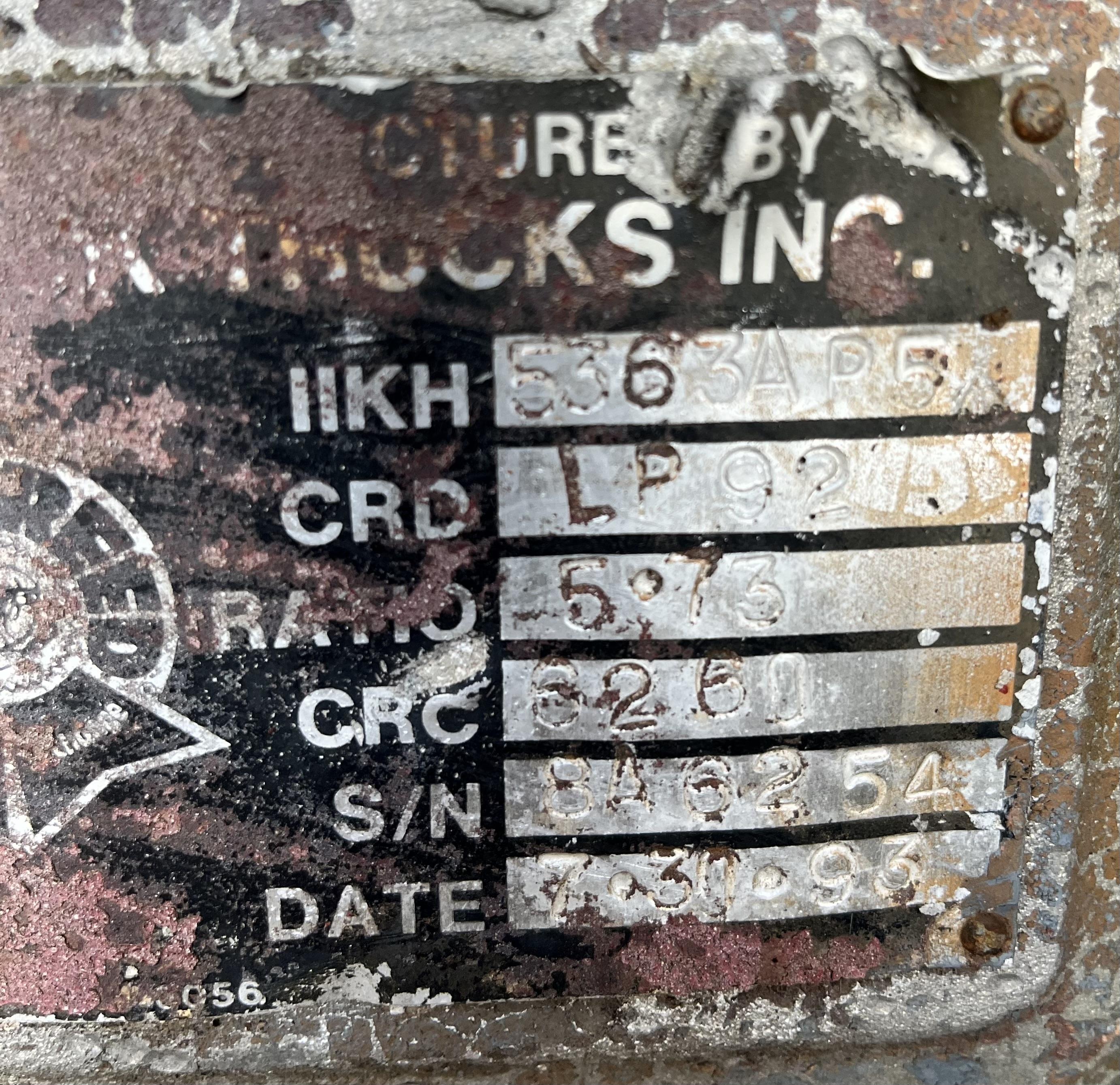

Oh no worries bob its all good. Talking trucks is talking trucks as far as i care. Lol. Im curious about the rear suspension as much as anything because its not camelback its just a walking beam with no springs. The engine finally died in my R so i was offered this old 690 as a complete parts truck because it has a compatible engine. EM6 4 valve. Kinda think its a T2080 transmission but not positive. So i was hoping to clear up wjat transmission and rears id be getting as well. Having said that he has not ever given me a price for the truck. He’s thinking about it. But he offered it I didn’t ask.

Yeah I understand the parts thing bob that’s why I’m so interested in this parts truck. Where I live theres no old macks around and zero older Macks in the only salvage close. I bought that hood from a place up north and paid as much freight as I paid for the hood. So i get it. This parts truck has a 300 4 valve. I’ve never driven it. I only have experience in tbe 2 valve engines

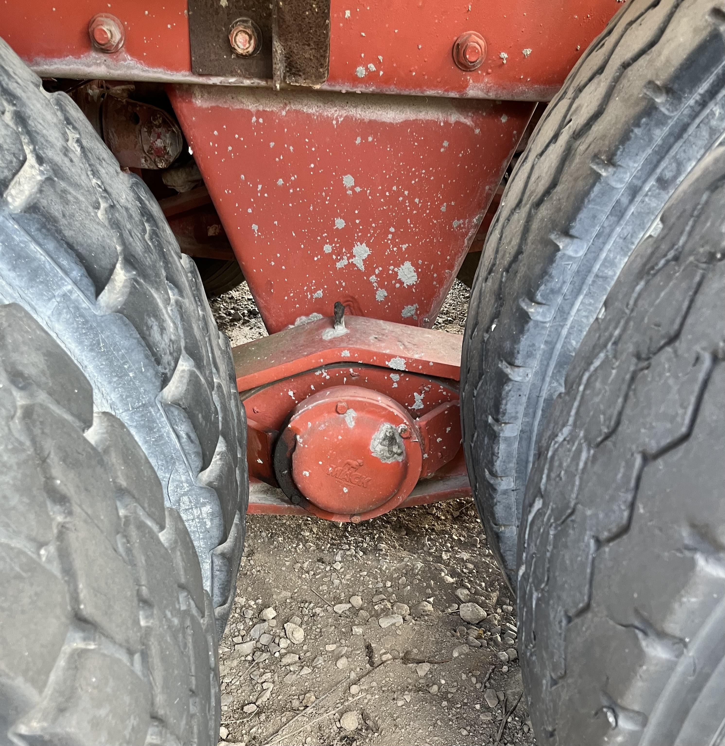

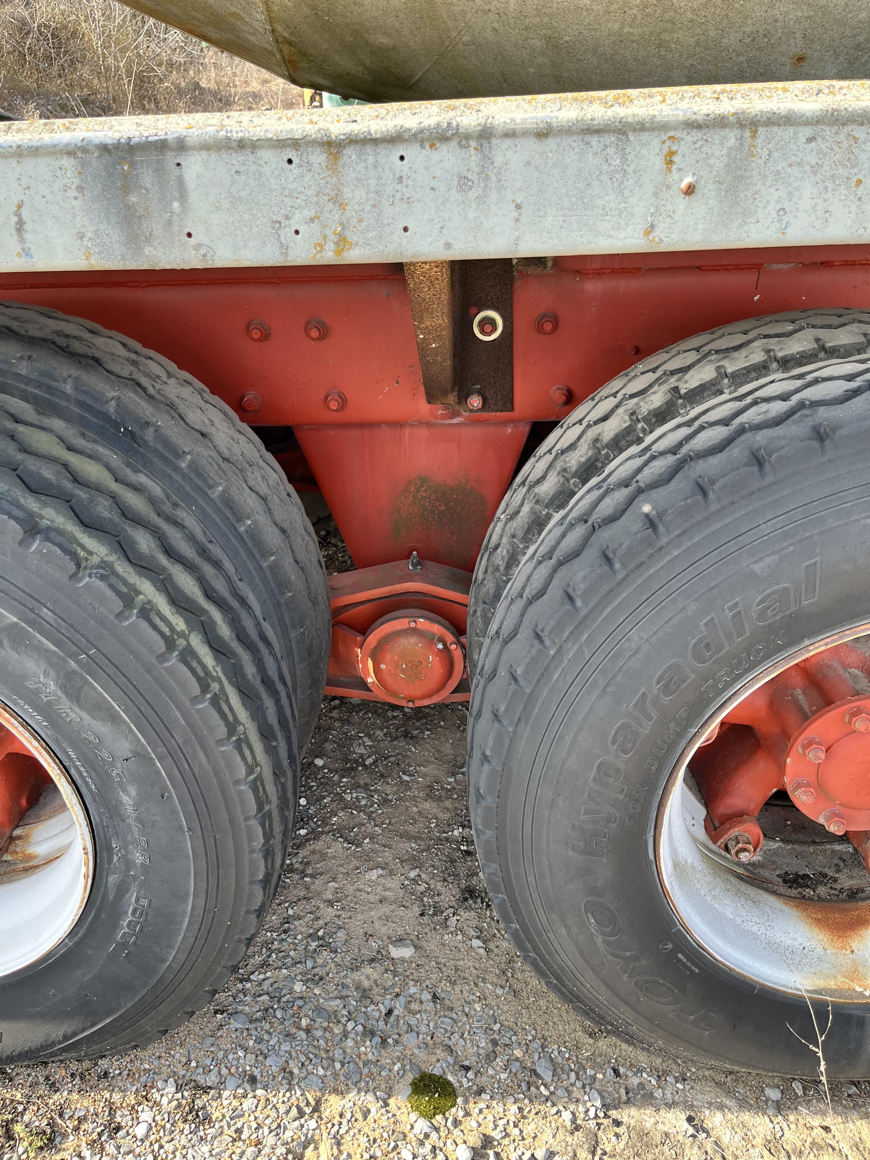

My old r has 38k camelbacks and they have a broken leaf on one side so I was wondering about the suspension in the parts truck as well. I  wouldn’t mind a stouter rear suspension than the 38’s they seem a bit light

No apologies necessary at all. I don’t mind at all. Lol. And tbank you for that information. I do somewhat understand the model number meanings but not great. My truck was originally a R685ST. I know that meant a endt675 or 237. Tandem drive. Someone before me basically made it a R686ST as when I bought it there was a EM6-285 tip turbine under the hood.
now the RD690S im looking at is a 1988 or 89 and was a dolese brothers mixer truck since new. It has two hydraulic drop axles in front of the drivers and a fold up drag axle behind. It has im sure a 18k or 20k steer. Has  385-65 float tires on front.
josh
https://www.bigmacktrucks.com/topic/73910-rd-specs/#findComment-547220
  • 0
Being a factory built mixer truck I can’t imagine it having anything less than 44’s but I don’t know how to tell. I can post some pictures of the rears and tbe tag on the axle housing. I posted them in the suspension section but haven’t gotten alot of responses yet

I think I have the same exact suspension in my DM. Also, I ran that 300  4 valve I wasn’t impressed with the sound or the power. Had 179,000. It sounded like a Cummings and I didn’t think it pulled very well At all but then. I did get out of a 350 Thermadyne it was a E 6 now that thing was a pulling SOB
