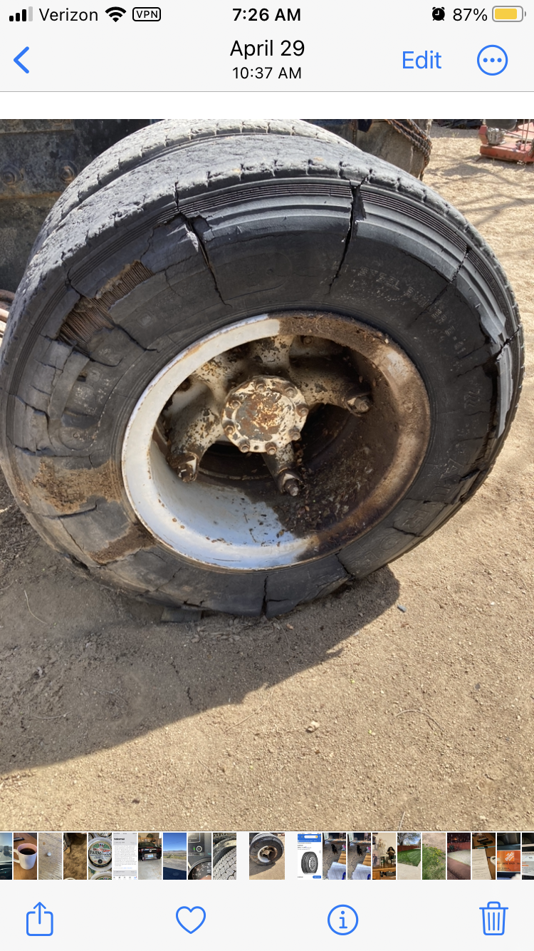

Yes, one of the fellas out here turned me onto double coins. They’re about the cheapest around. I’m finding them online for under $100. I know the Michelin tires we use at work are around $500 apiece just for a recreational vehicle. No I’m not gonna spend that much. I railer look around for used which is still very rare in this area size.1000-20 tube type but they still use them on container chassis
https://www.bigmacktrucks.com/topic/73910-rd-specs/page/2/#findComment-547235
