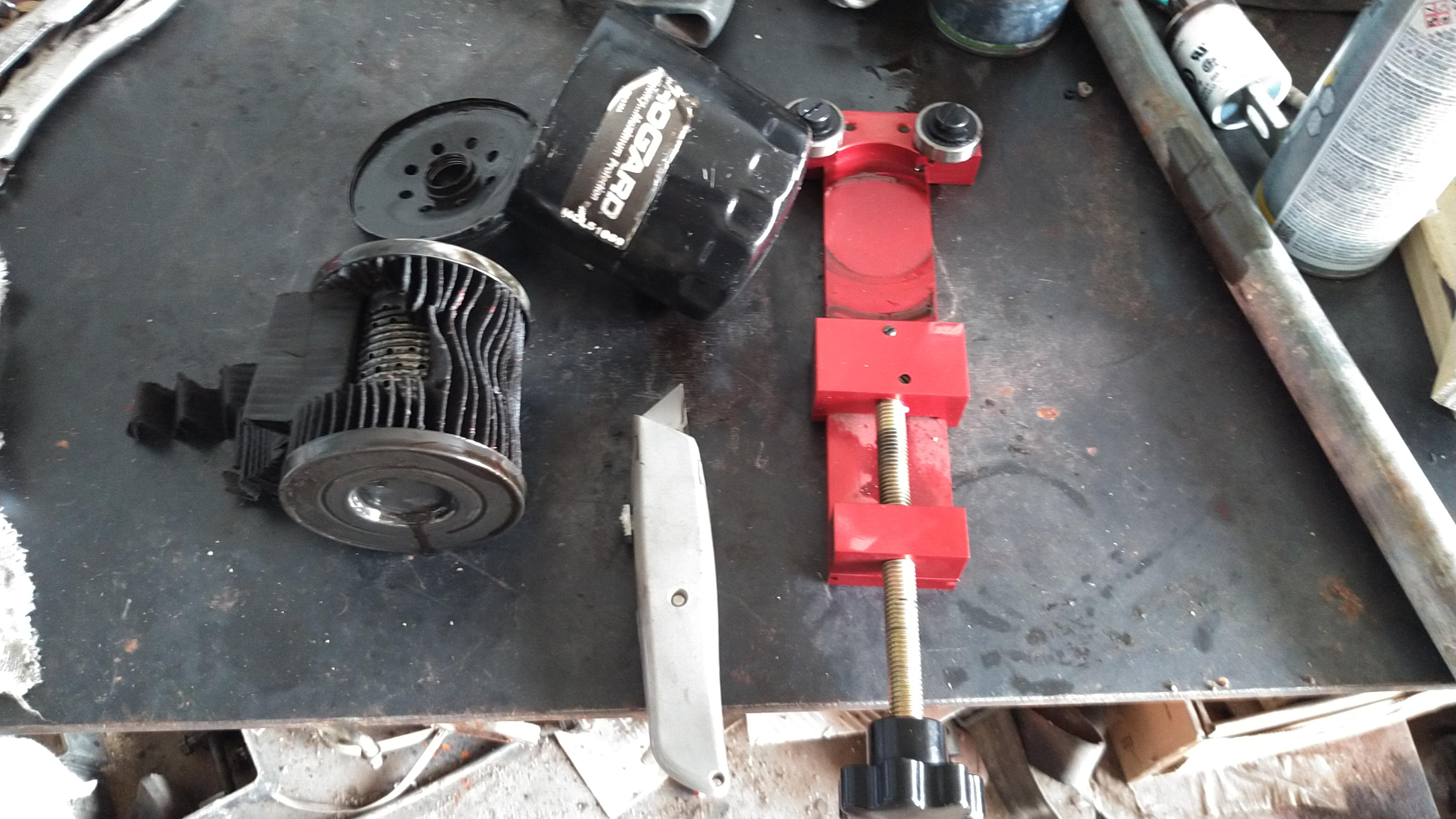

back when i was new at this, Earl Harnden, (my old timer) taught me to cut filters open..  I have been doing it ever since..
