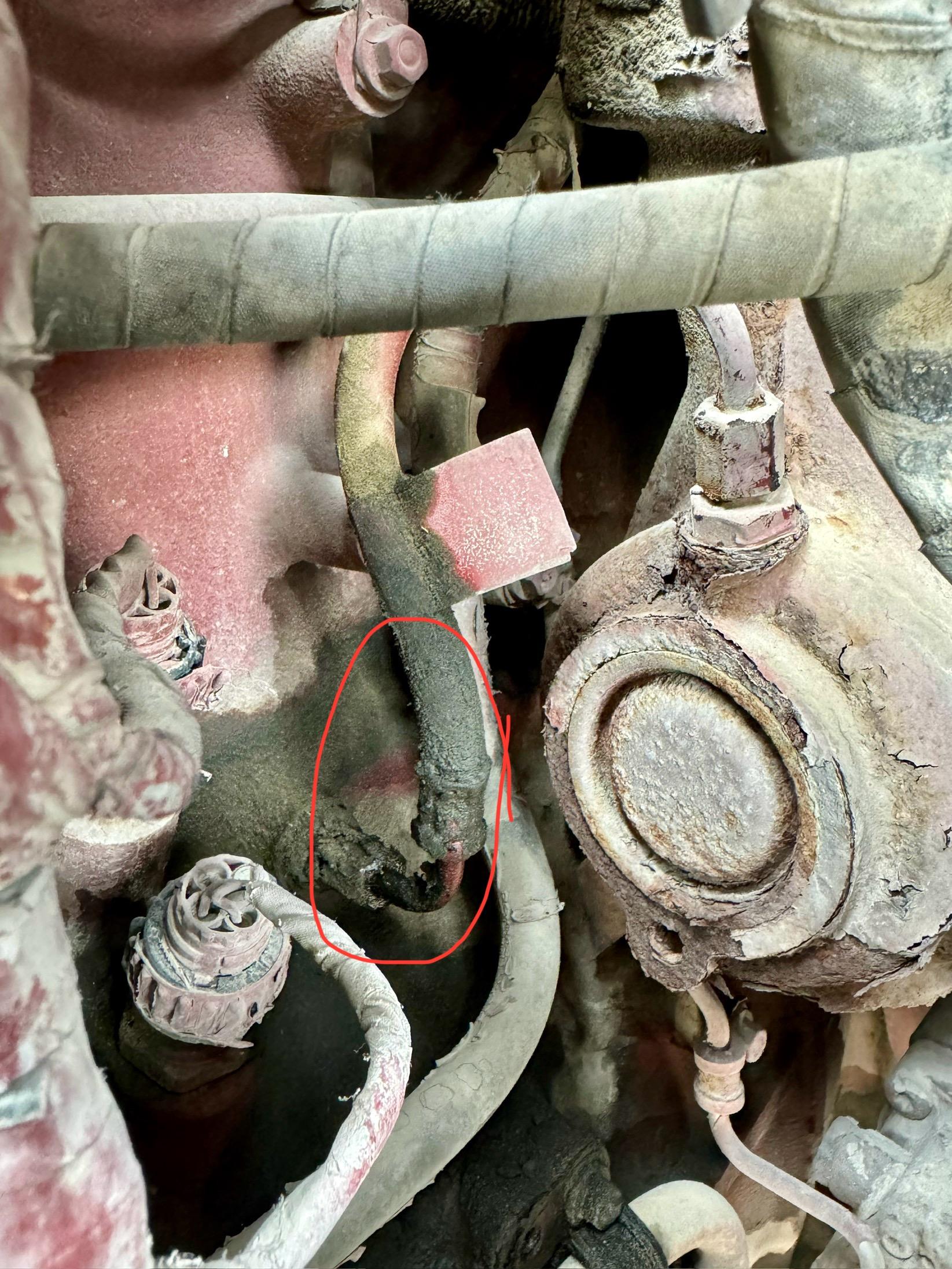

Can anyone confirm if this is the oil supply line to compressor ? My is leaking oil where it connects to the engine. Is this will be a straight forward replacement of just loosing two nut at each end then swap out with the new line ? Any oil will be pouring out …? Thanks for all the help.
You're right, it's the oil supply line. Just be careful with the o-rings on the two nipples on each end, unless you match up with a kit from a parts/hardware store, they only come on the piece themselves. Most of our techs end up requesting them, but I doubt most jobs NEEDED them.
