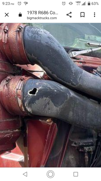

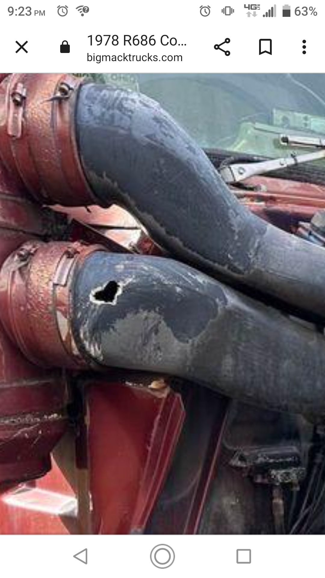

I am looking for medium size Dump Truck to move soil around for some planned property improvements this spring. If I get a truck I'd prefer it to be A MACK. Turned up a 6 wheel 1978 R686.
Looking over the truck it has 377000 plus mile. Started the engine and if fired right off stone cold. Checked the coolant after the engine ran for 5 to 10 minutes. When I removed the cap the radiator was pressurized, the level was low and I couldn't see coolant. I asked the owner if there was any problem with the cooling system. He said they just replaced the water pump? He assured me there wasn't any known problems or issues with the truck. A little concerning. The seller has contacted me asking if I am interested in the truck. I told him I might be if he tops off the coolant, if I can further inspect the truck and take it for a test drive.
One thing I found strange, odd or unusual. When I pulled the dip stick the side closest to the frame (facing me) was clean with no oil. I asked about the oil and I was told the oil was just changed. I re-dipped the stick and it came out clean again. Wiped the stick with my finger and the dip stick on the engine side had oil. Dipped the stick again and the same results. The frame side was clean. With the stick pulled I turned it over and it showed full. What the heck is up with that? Anyone ever had that experience? Goofy question - Is it something to be concerned about?

Great trucks; you're going to want to fix this intake tube though, keep rain from getting in and ruining a nice truck. Also its letting unfiltered air in.  This radiator has the reservoir in the top, you should just barely be able to touch it with your fingers.  You can spot coolant leaks by looking for salt trails, common leak spots are the freeze plugs on the driver side, as well as the crossover hose (very short) between the front and rear head water manifolds, also on the driver side.
Does seem strange that the oil is only on one side of the dipstick. Next time check the oil before starting the engine.  I have an E7 that if I check it 5 minutes after shutting off it'll be a gallon low on oil, but if I check it first thing in the AM it's full.
.If you think the coolant is pressurized. You can bring a fairly cheap co2 tester with you. You will want the truck to run for a bit to see if combustion gasses are entering the coolant.
RELD Head Gasket Tester Kit Combustion Leak Detector for 50 Tests https://a.co/d/4va7zaw

Second, (2nd) I wound up passing on the Mack. My little voice inside just said NO. They say first impressions are everything. There was just something about the truck and the hard sell tactic the seller was pushing. One of the first flaws I noticed on the truck was the hole in the intake tube. That would have been the first thing I would have fixed. How obvious of an easy fix would it have been for the seller to just temporarily fix the problem with duct tape. I have no idea how long the truck was run that way. It is an issue I didn't ignore while looking at the truck. I don't want to talk bad about the seller but there were a lot other issues that turned me away from buying it.
