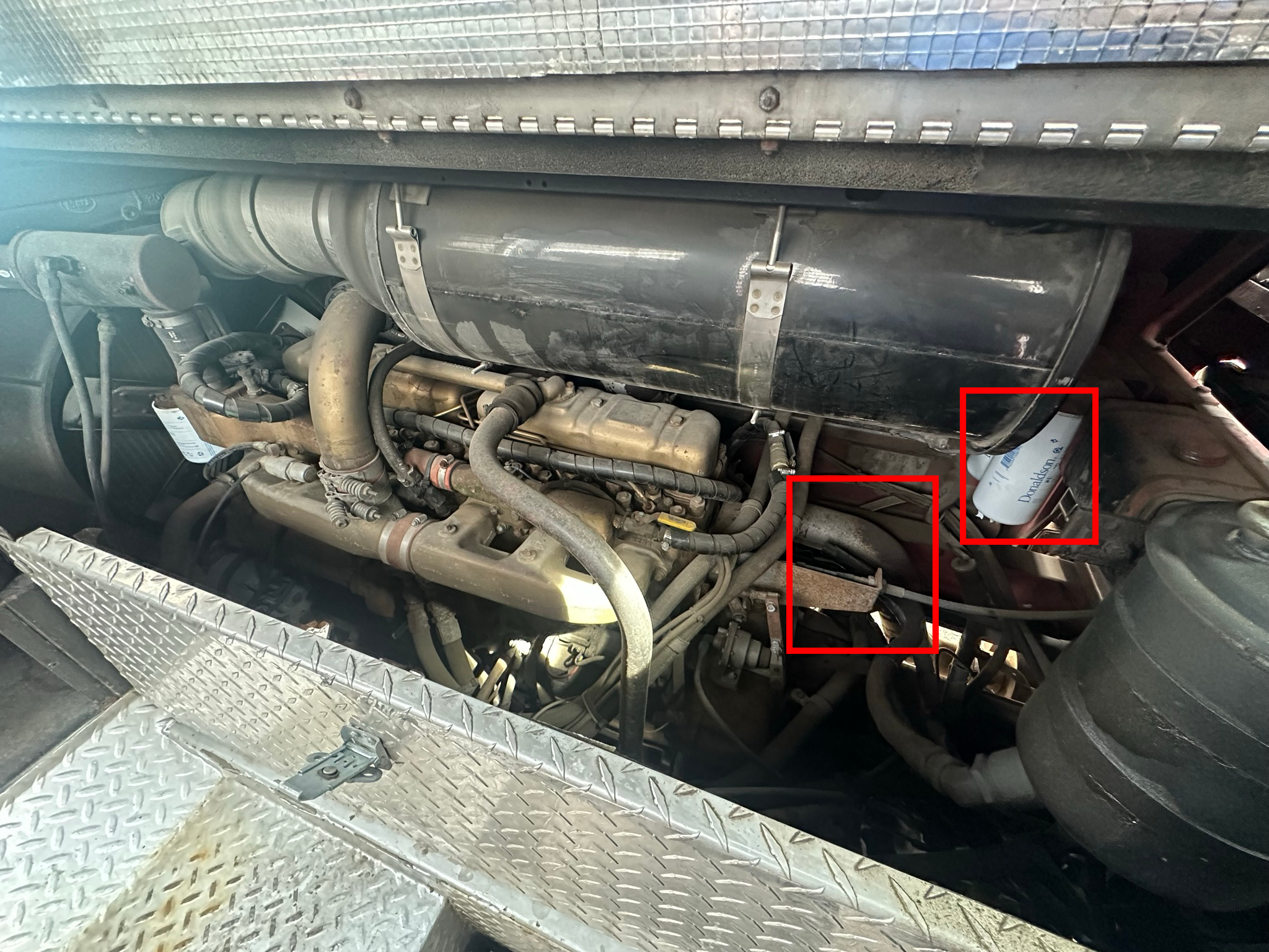

Bit of a long story here so I apologize.
I've owned my 1977 CF600 for about a year now. ENDT-675 motor.
Admittedly after driving it about 4 hours on the highway to get it home last May, I parked it and drove it maybe a couple more times before letting it sit for a few months, including over the winter. Priorities.
I came back around two weeks ago to a truck that wouldn't start. Two dead batteries which is an easy fix. I should have removed them for the winter but didn't even think about it. Replaced one of them and still couldn't get it to start. Cranks like it wants to start but just won't.
Now I'm thinking fuel issue because it sat all winter. Replaced the fuel filter and added some diesel 911 + some fresh diesel. This is the first diesel motor of this size I have dealt with so I'm really shooting in the dark just hoping something will work. Still no start.
I then read a post where a gentleman says he puts his foot to the floor to start his rig and cranks for 15 - 20 seconds, so I try this. Fires up after maybe 10 seconds, tons of white smoke, but all seems fine. I then drove the rig around for a little over an hour, came back and parked it. Everything seemed normal.
Couple days later (today) it cranks but doesn't start again. Open the drivers door and it smells incredibly strong like diesel fuel. I go to look in the doghouse and see white smoke coming from the exhaust in multiple different places. Not a lot, but a noticeable amount coming from the muffler and some holes in the exhaust pipe. I've read that white smoke when trying to start isn't an unusual thing but it made me nervous so I stopped.
So a few questions:
What am I missing?
Why did the rig start the other day but today it cranks and won't start?
Should I get another battery and see if it just needs both to start?
Is the white smoke just a sign that I'm getting fuel, or something to be worried about?
What about the strong diesel fuel smell?
Also:

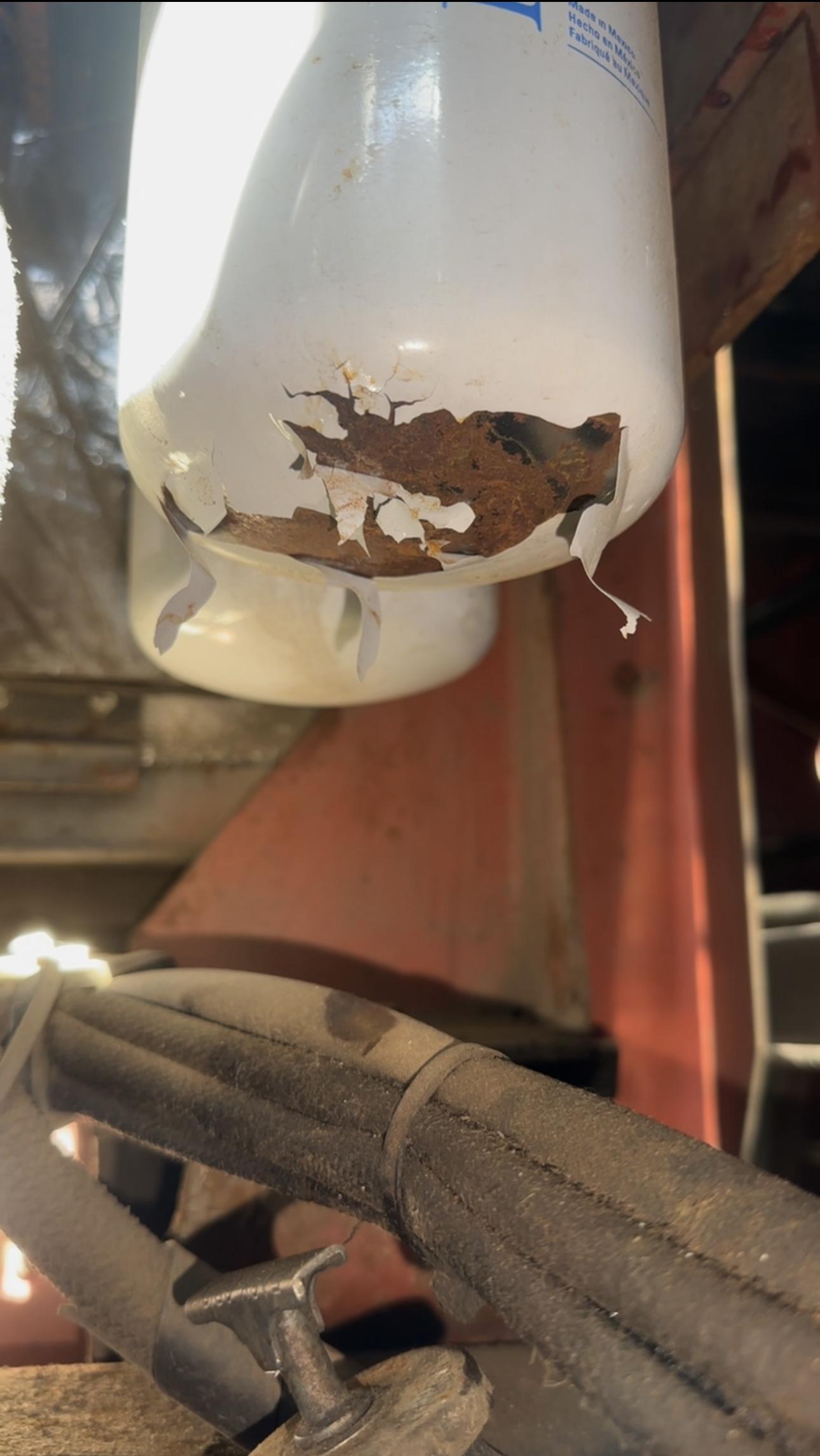

I noticed this peculiarity happening to one of my oil filters when I checked the doghouse. Something to be worried about, or should I just replace the effected filter and build a heat shield in front of it? I'm guessing it's coming from the incredibly hot exhaust coming off the turbo. I could also wrap the exhaust with heat shield in hopes of stopping whatever is happening (I assume just too much heat).
Thank you to anyone with any insight. Much appreciated.

Are you sure those are oil filters?
mine has an 865 but they are on the side of the block like most motors.
Could be fuel filters or trans filters. From the sounds of what you describe, it could be loosing prime when sitting. If it ran fine before a doesn’t after this winter I’d suspect air in the system. If those are fuel filters, it would make sense.
id change them either way.

They are Donaldson lube filters, P551807. Well, at least the one that is affected is. I can't see the text on the one next to it.
The fuel filter is in a pain in the rear spot next to the passenger front wheel. Took me forever to even find it.
I think most of the filter locations were moved at some point and have spin ons.
As for losing prime, any idea where to start on what could be causing that?
