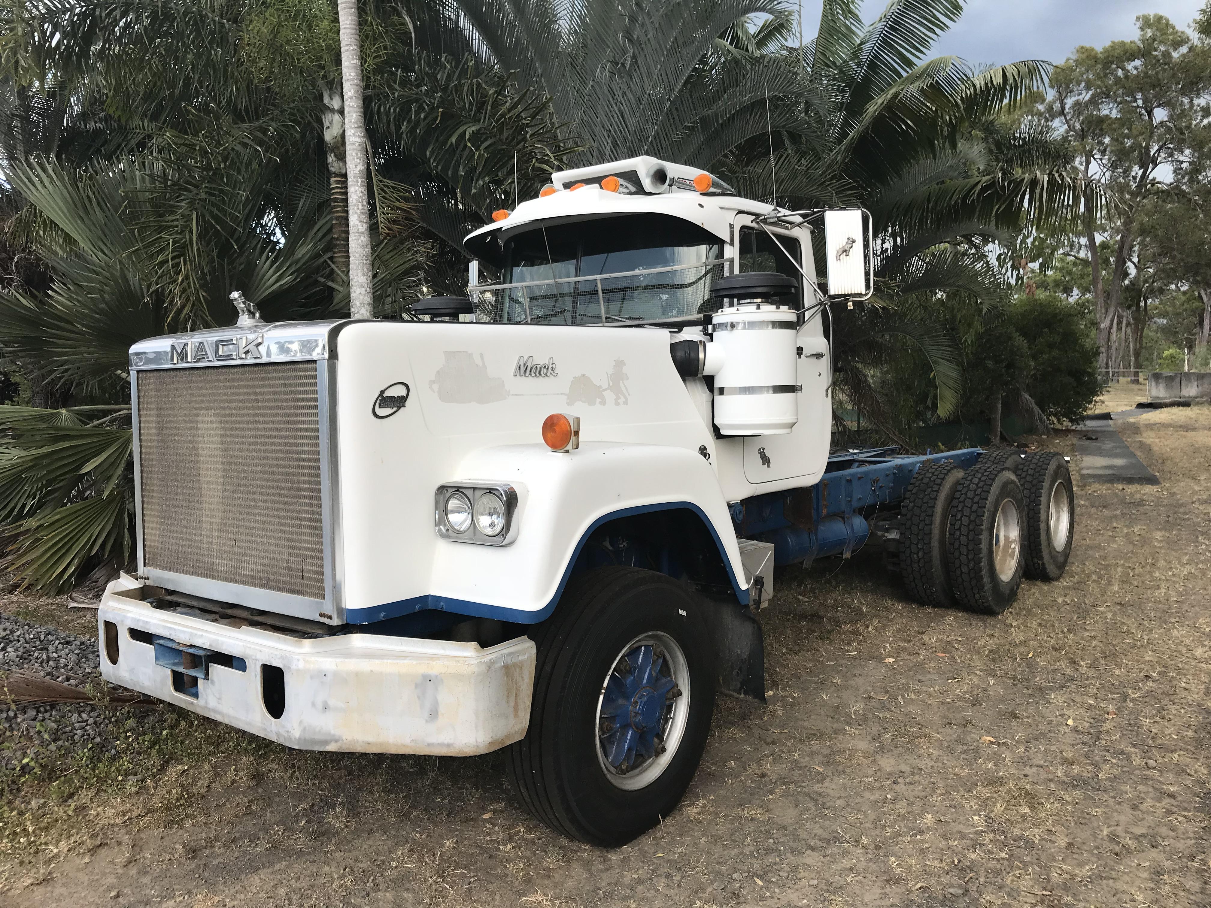

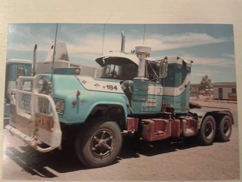

Length I reckon will be the issue
Here is a pic of a R700 a bloke in Australia owns and he put a 3408 in it
Bonnet is severely modified to make it fit
And remember it started outas a R 700
With the 375 as made
Much later, same truck with a 3408
Paul
https://www.bigmacktrucks.com/topic/73976-3408-swap/#findComment-548643
  • 0

Mechohaulic, it's a Superliner with a long long sniffer
Does it make it a Superdooperliner then
The owner contacted me some time ago after watching me rebuild my old bucket of bolts on youtube
He explained a lot of details, both the owner and the truck are retired now
The 375 endt 866 went kahput and the E9 was still under development so a substitute was found
A huge tropical radiator was shoved in and the chassis extended  to accommodate all the mods
The owners  words "a lot of fellows are aghast at the extra length, I personally don’t give a f**k"
Anyway, it's not my story to tell, it sure is a different looking truck and has served the owner well for many decade's
Paul
