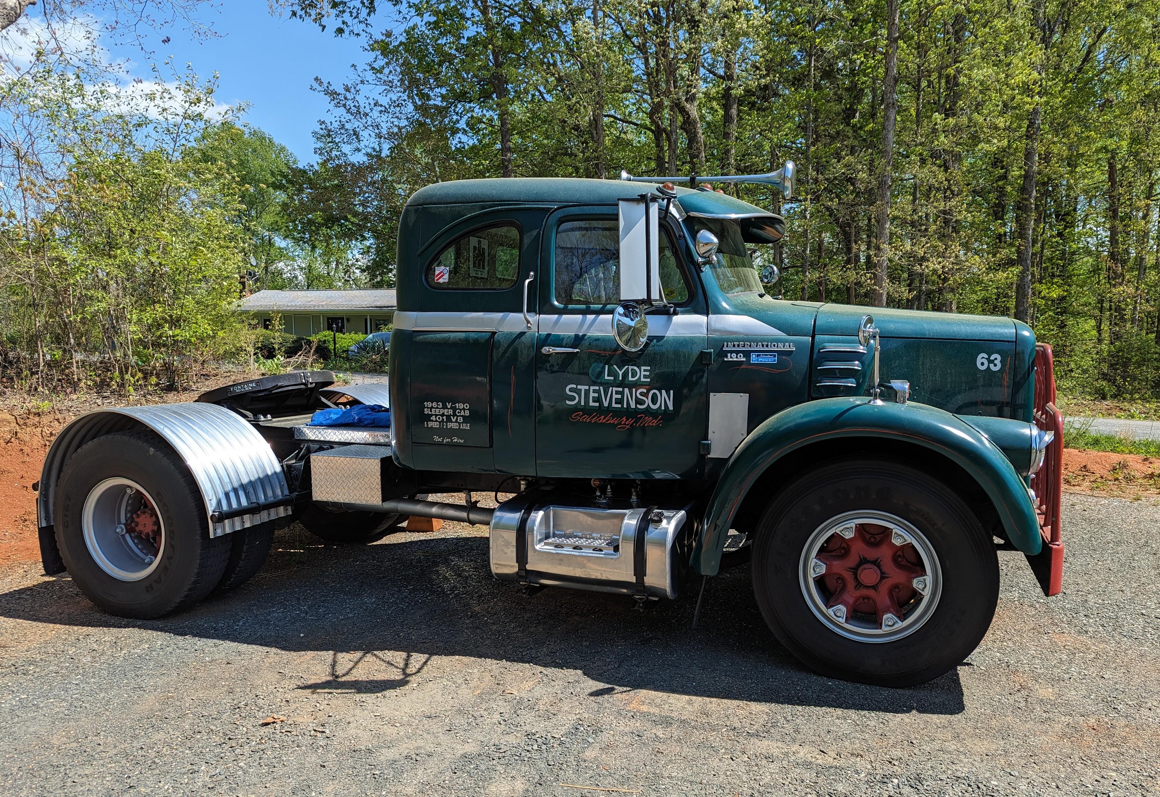

Got that tank on today. It has some issues, but it's on.
Has about 3 1/2 inches of gas in it, according to my stick.
SWEEET RIDE THERE Ralphie 😆 😂 😆 🤣 😂
trucks looking real sharp. the alum tank definitely sets it off . it is  with out a doubt different then most. not just the model of the truck it self but the sleeper cab/ vizor/ and the one large trumpet on top just to name a few of the oddities .
