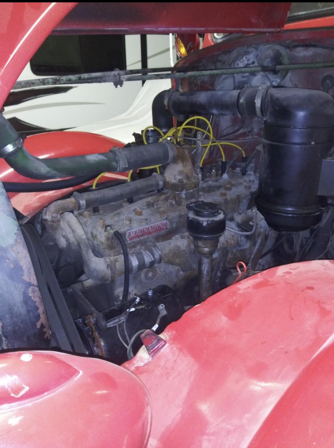

Hi All. I am brand new to the sight. I am working on a 1951 A-40 Concrete Mixer. It has a Smith mixer on it. I am trying to figure out what the engine is. I am having trouble locating anything on it. The engine is a Maxydyne inline 6 Gasoline engine. The number, I think is on the front right (passenger side) corner on the block. The Number is E 1(or capital I) 377 43 65. I set the points at .020 and it started up. It hasn't ran in several years. It needs a new fuel pump. This truck was  restored in the early 90's. It was used in parades. When I get it up and running. And, cleaned up. So, I can get it outside for some pictures. I will post them for ya. Any help would be appreciated.  Thanks

Hi all. Just an update here. I was able to read the engine number better after we got it out of the shed it was stored in. The number on the block is actually EN 377 43 65. I still cannot find anything on this. But, While driving it back to our shop. I drove it in direct. 1st and 2nd worked well witth plenty of power. When I put it in 3rd (direct), it ran good for awhile. Then it started running very rough. If I shifted down it would clear up and run fine. Almost like the governor isn't working under power. If I can figure this engine out, I can figure the governor out too. Thanks   Pat

Your engine is an EN 377. Serial number 4365.  Bore and stroke 4"x5", 377 cubic inches.  Almost all Mack gas engines of that era called for a point gap of .022", you're real close. Are you looking for any specific information?  With any old truck that has been sitting for some time, you have to suspect some crap in the fuel system will cause you trouble. But in the other hand, it could be any number of things making it run rough. Good luck.
I have a 405A firetruck based on the A40 chassis.  It also has a 377.  I agree with Steve.  It’s probably not getting enough fuel.  I had a new fuel tank made and put an electric fuel pump on mine and it runs great. Both the old tank and the old fuel pump leaked. I don’t have any manuals. Michael.

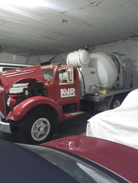

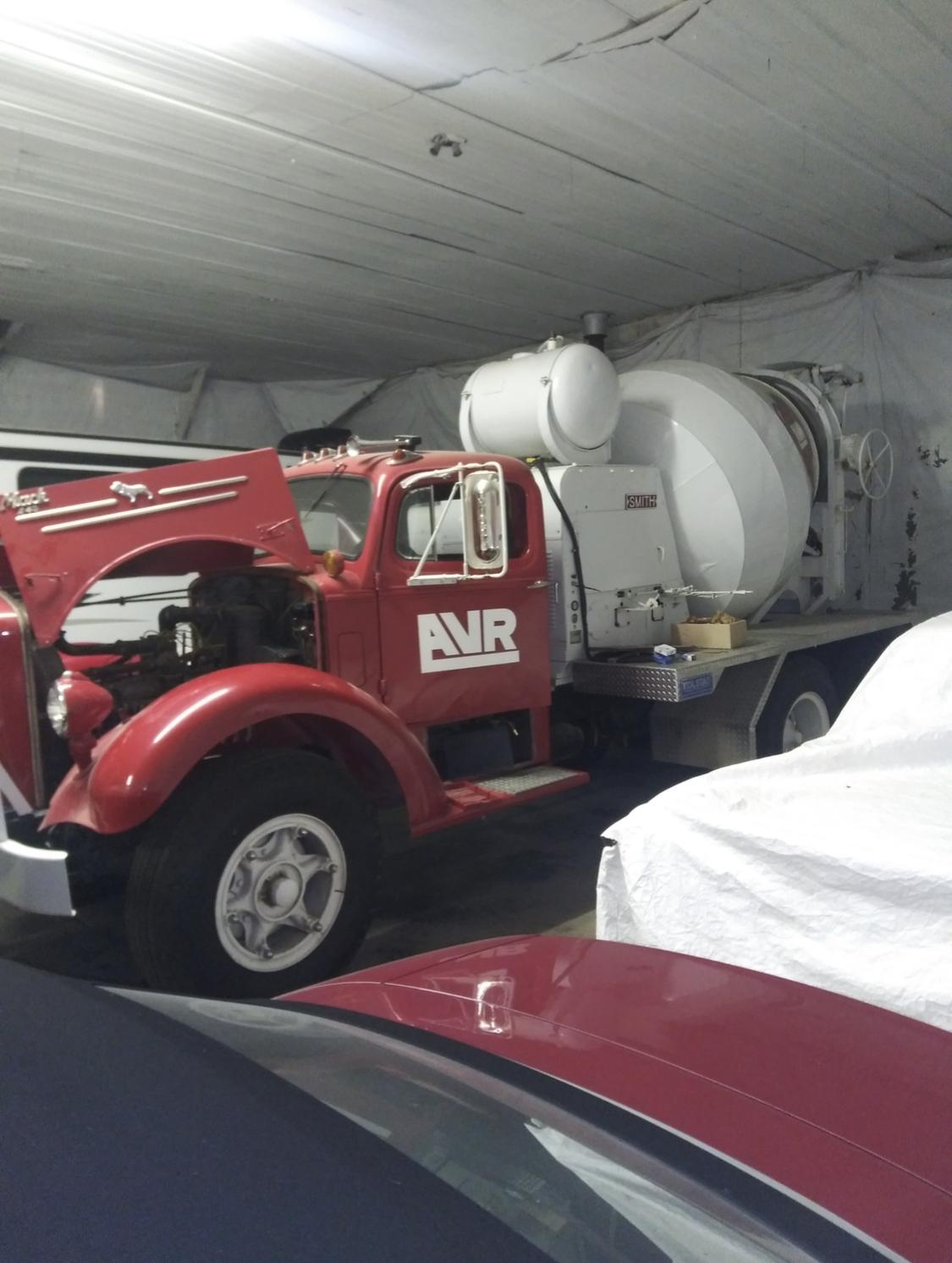

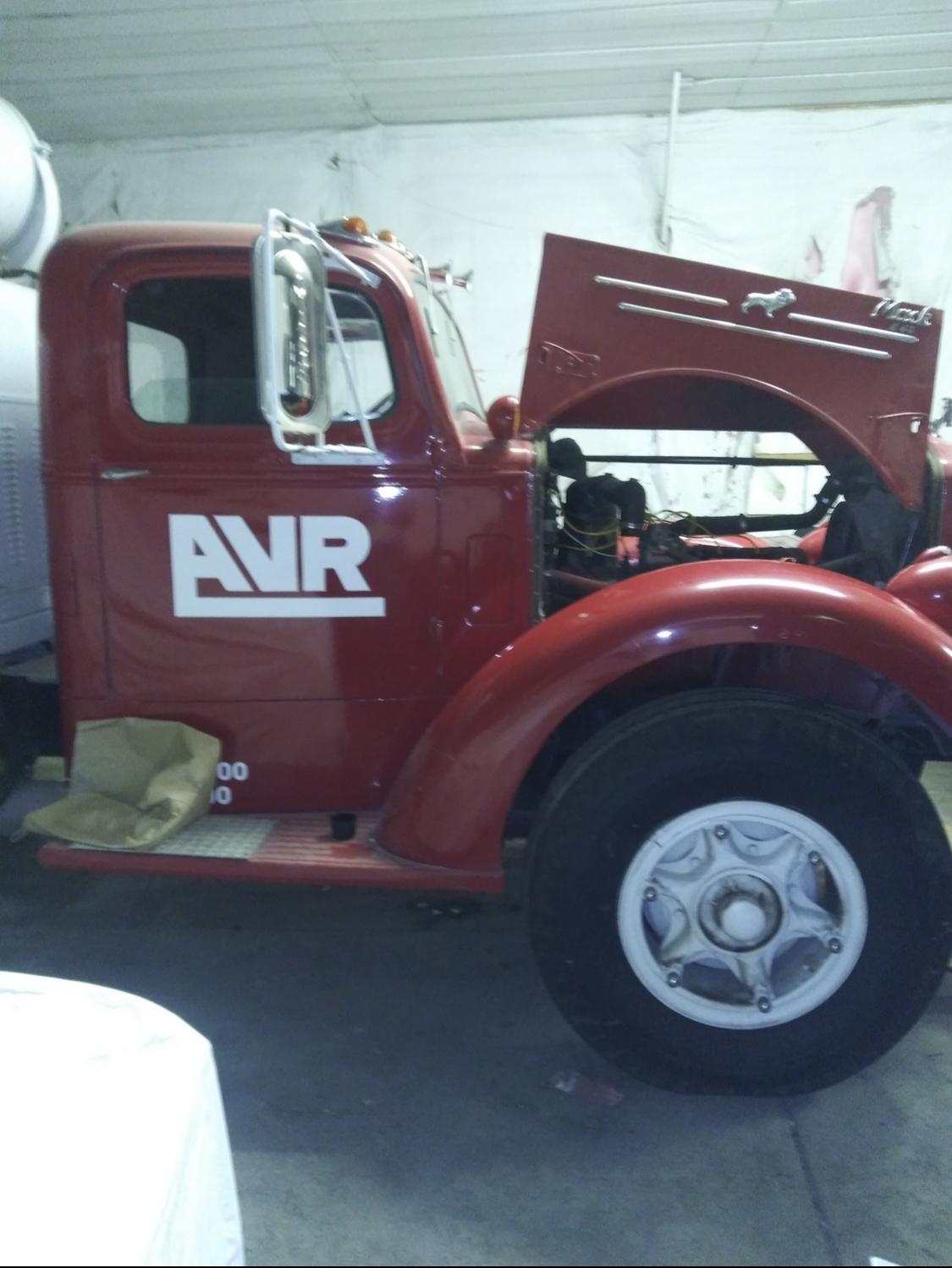

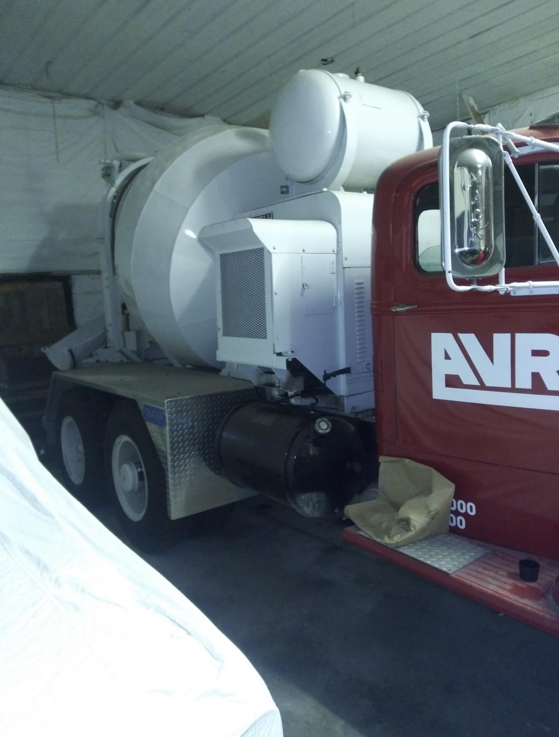

Thanks all for the welcome. Also, for the info. I was thinking a fuel issue as well. It does have a Carter electric fuel pump. I am suspect of it. I had to tap on it to get it to pump after sitting with no fuel in it. The in cab tank was rebuilt when the restoration was done 20 years ago. The truck only gets to go outside when paraded or going to a show. It gets ran out of fuel when stored. I am not a believer in that. I recommend that it be ran and driven at least a few times throughout the year. But, I am not in charge. Here are a few pics while she was inside the shed. I will get more when I have it cleaned up and outside.

So I don't think you have a Maxidyne as they were diesel

Pretty sure it will be a side valve motor

What a cool truck! Most people chucked the flatheads but I'm glad this one was able to be preserved. Magnadyne is such a cool name for an engine
