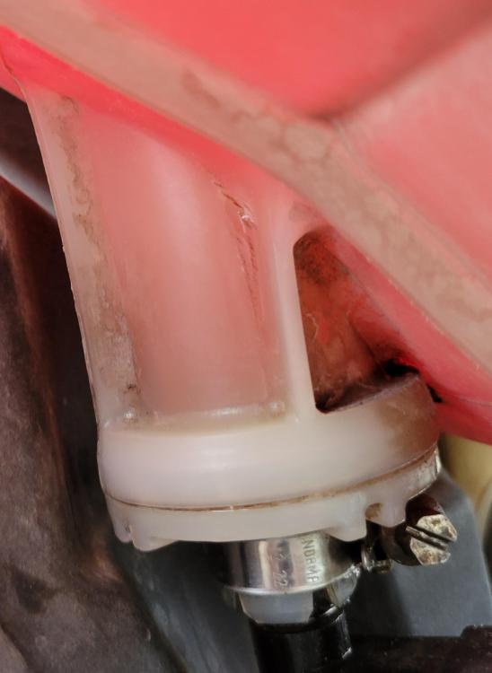

Leak around antifreeze sensor

I assume its one of the plastic lines from the coolant tank to the ????  I forgot..  Been away for about 5 years now..  I remember that the ends and the oring loosen and just replace them..  sad, that you cant just fix it..

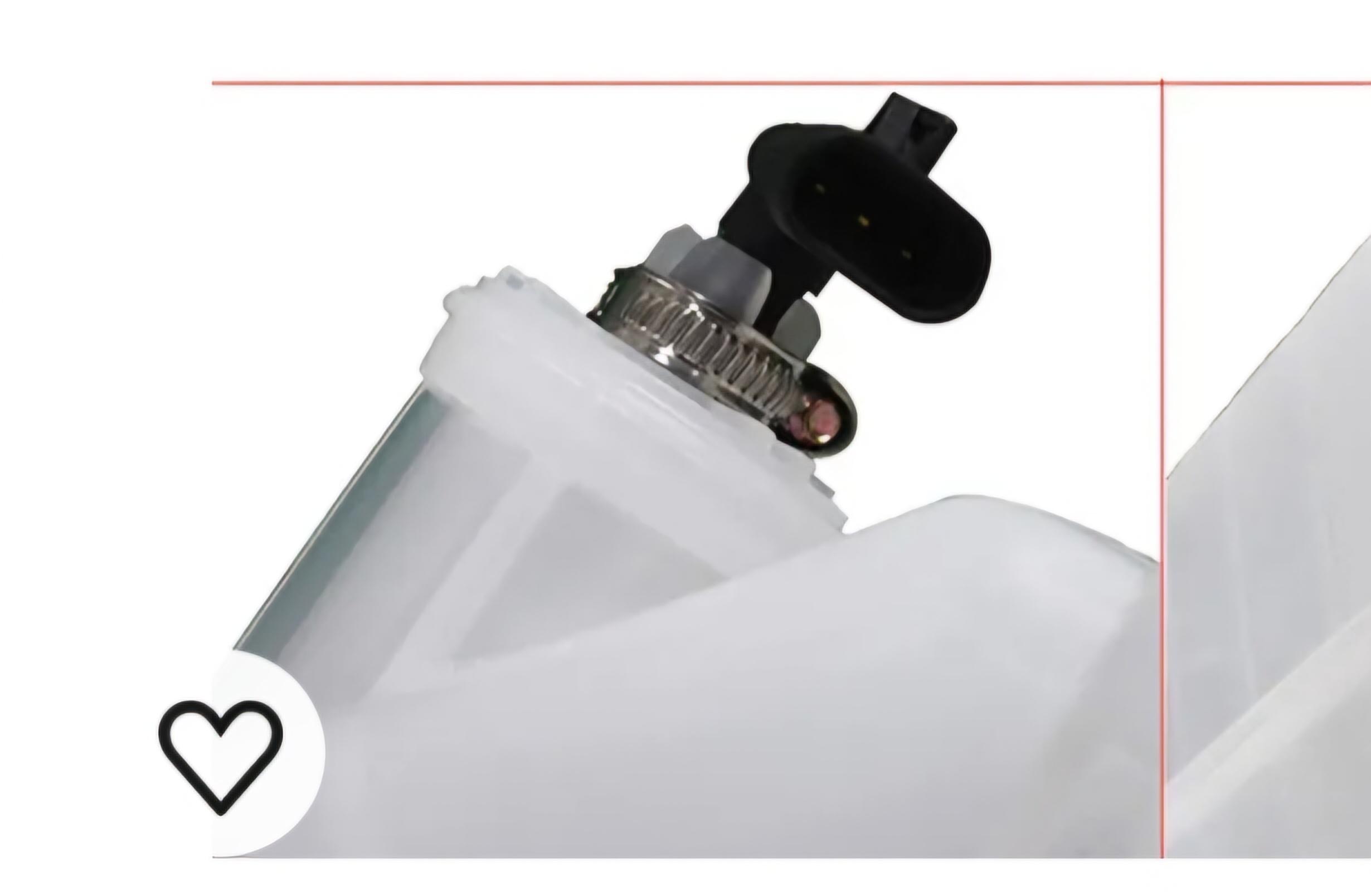

The sensor 22564822 has an o-ring on it, but your expansion tank could have a crack too if it's old/wore out. PAI has no stock, but the OEM is readily available right now. If your local dealer has Automann access, they are much cheaper. Automann expansion tanks are also really good quality, it's about all we use thanks to availability.
