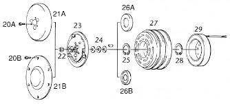

Isnt the clutch on that model internal?  If its the Sanden that i have seen before, you wont see the clutch engage. G.W. makes some good points though..  was the expansion valve replaced recently.
I wasn't aware of any trucks that were "clutchless" compressors (variable displacement) that turn the shaft all the time like some cars, but stand to be corrected on that. Those types have a control valve in the compressor that move the swash-plate to 0 instead of a clutch. Big pain in the rear. All others have a clutch on the front that can be observed.
 Sanden's I'm aware of all have clutches, with it turned off the center bolt will not spin with the pulley.

Actually, there is a clutch, it just isn exposed. It is behind the pulley..  i dont care for them.  Im with you G W.
I've never seen what you are saying it has, do you have a picture? How is the pulley retained if the clutch is behind? How is the air gap adjusted? Where is the electo-magnet  and how does it pull? It can't push the internal plate out so must pull something.
 In automotive there are some totally clutchless compressors the have a movable swash plate  and a shear point on the shaft in case it locks up. Supposed to 0 out if it is low on refrigerant, and supposed to shear if the compressor locks.
 Lots has changed since I got out of commercial work, so am open to learning new stuff I haven't (yet) seen.
I am not able to answer most of your tech. questions, GW..  but what I do know, is it makes trouble shooting A/C issues harder, especially on a road call, and you dont have a laptop with the correct programming.  Even with A-Pads on the truck I have struggled with them.  I dont like to just throw a compressor on as a guess, I want to know why, before I spend the customers money..
Ahh, I see I suspect that front cover that is screwed on is a dust cover keeping water and dirt out, and is a conventional clutch below that.  Kind of like the old chafe shield on the Harrison A-6.
 I think I can see a clutch coil behind the pulley.
 If he has one of those, I would pull the cover so I could see what the clutch is doing.
 I haven't run up against one of those yet.
The clutchless are a worse almost throw-a-way compressor.
 I was pondering how it could push instead of pull, now I don't think it has too.
Thank you for the picture.
 I never thought much of the APADS, make it more complicated than it needed to be.
 I had mine set up with Hi and Lo cutoffs, and the low would lock-off until re-set. It would shut the system if 25% of the refrigerant (or there abouts) had leaked, and there was a secondary low pressure that would prevent clutch pull in below about 45 psi on the high side.
 One pound loss on a 4 lb system and you might not even notice it in the cooling unless very hot.
 It would throw some for a loop, but was like the old thermal limiter fuse GM used to use, it could shut down before all pressure is lost, keeping some oil in the compressor.
typically 50 PSI of freon is enough to start the compressor, one of my issues was not being able to jump start or test the compressor with the engine off.  it is a 3 wire harness, unlike the 2 wire harness we know..  wont hurt my feelings if I never learn how to fix this disposable compressor.
