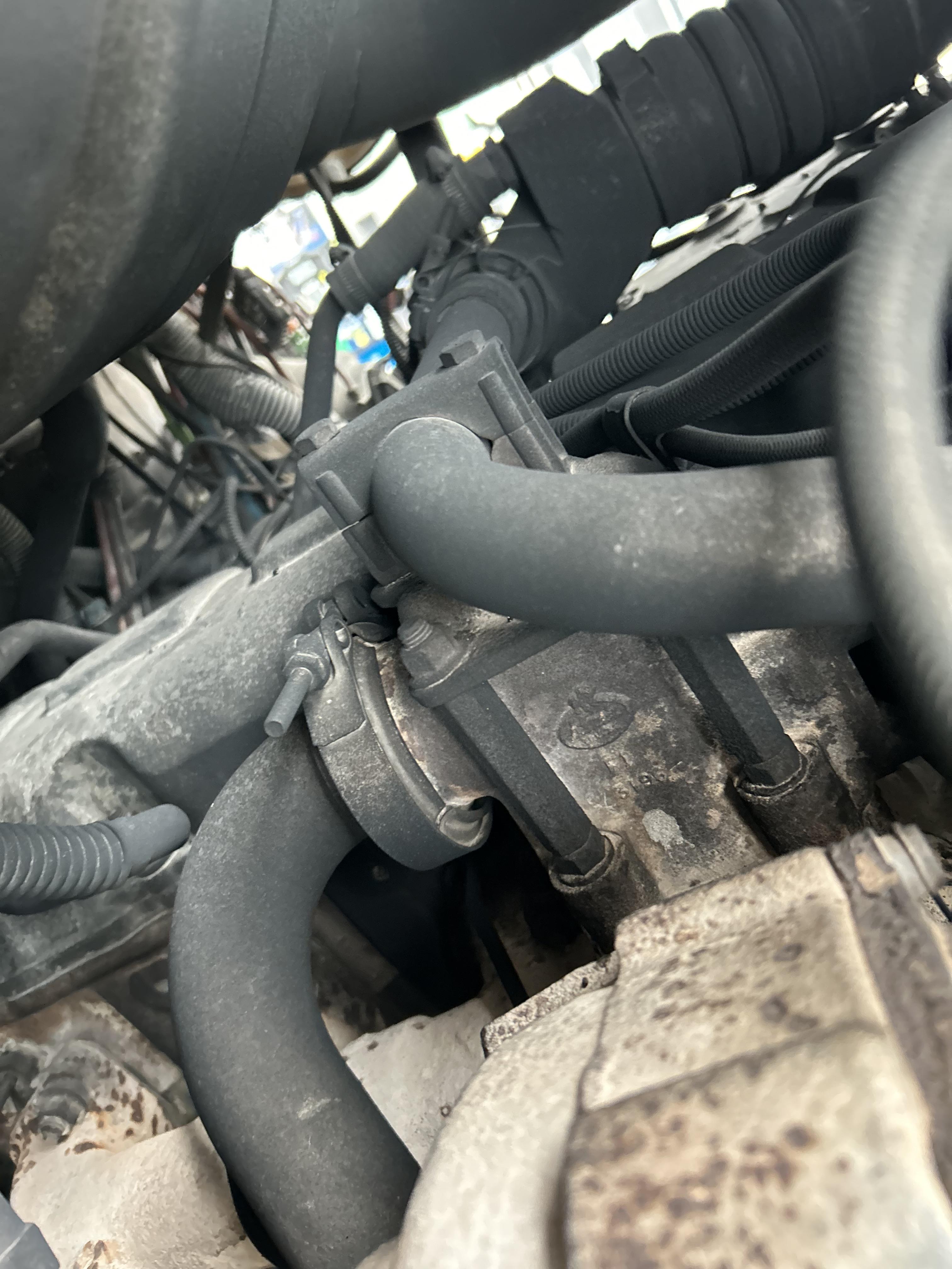

53 minutes ago, Artful dodger said:
Can the egr be completely removed and capped off?   what kind of aftermarket support is there for this?
yup have seen this done never done it !  however no support! Essentially  if you put a plate beneath  the EGR valve and the manifold flow is stopped no need to arouse suspicion! mums the word! removing the cooler means you got coolant line and stuff to plug just extra work!

I gotcha I understand now what you’re saying and I can see that that manifold flow would stop now that I’m picturing this in my head I’m just trying to figure out how to eliminate some of the things that aren’t working anyway, so they’re either taking up space or leaking you know what I’m saying

You first need to check the operation of the vgt ! as stated if it strokes correctly once you confirm that and plug the egr if the egr valve is commanded open by the puter it won't matter no egr gona flow and it will not loose any ability to spool the turbo! essentially becomes a normal engine !I did this to a customers truck 2005 chn  years ago the truck lived a long life aside from a the check engine light being on all the time the truck did over 1 million miles!  no problems to speak  of !

Hi, I did this to our 07’ CHN during a total overhaul.   We made a plate to remove and cover the opening for the valve using 1/4” plate steel, cut out a template on cardboard and traced it onto the steel, used new gaskets and bolts.  For the oil lines I went to my hydraulic shop and got some plugs/caps to remove the lines completely from the source. We made caps for the two coolant lines and the egr intake port. Disconnect and remove all egr associated wiring.  We removed the entire egr valve, crossover tube, egr cooler, and all the lines.   The result was a much cleaner engine bay, the truck runs perfect and I’m satisfied knowing it won’t introduce exhaust gas back into the engine. The only side effect will be the engine light permanently on. Other than that, the truck has been running great for almost two years since we did it.
