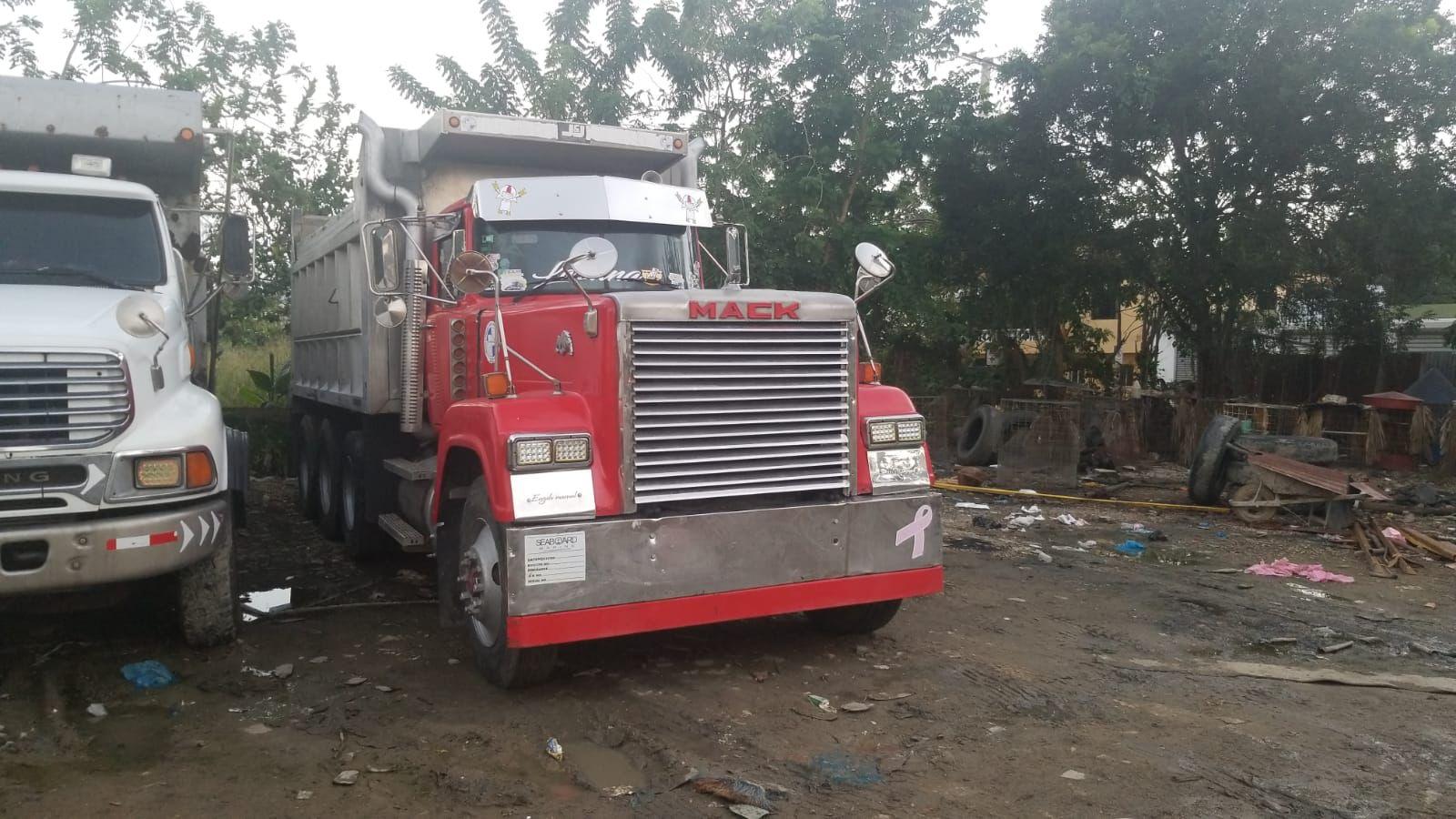

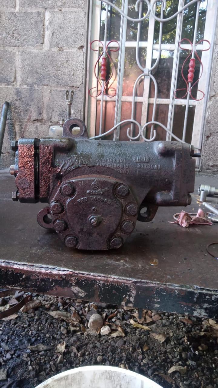

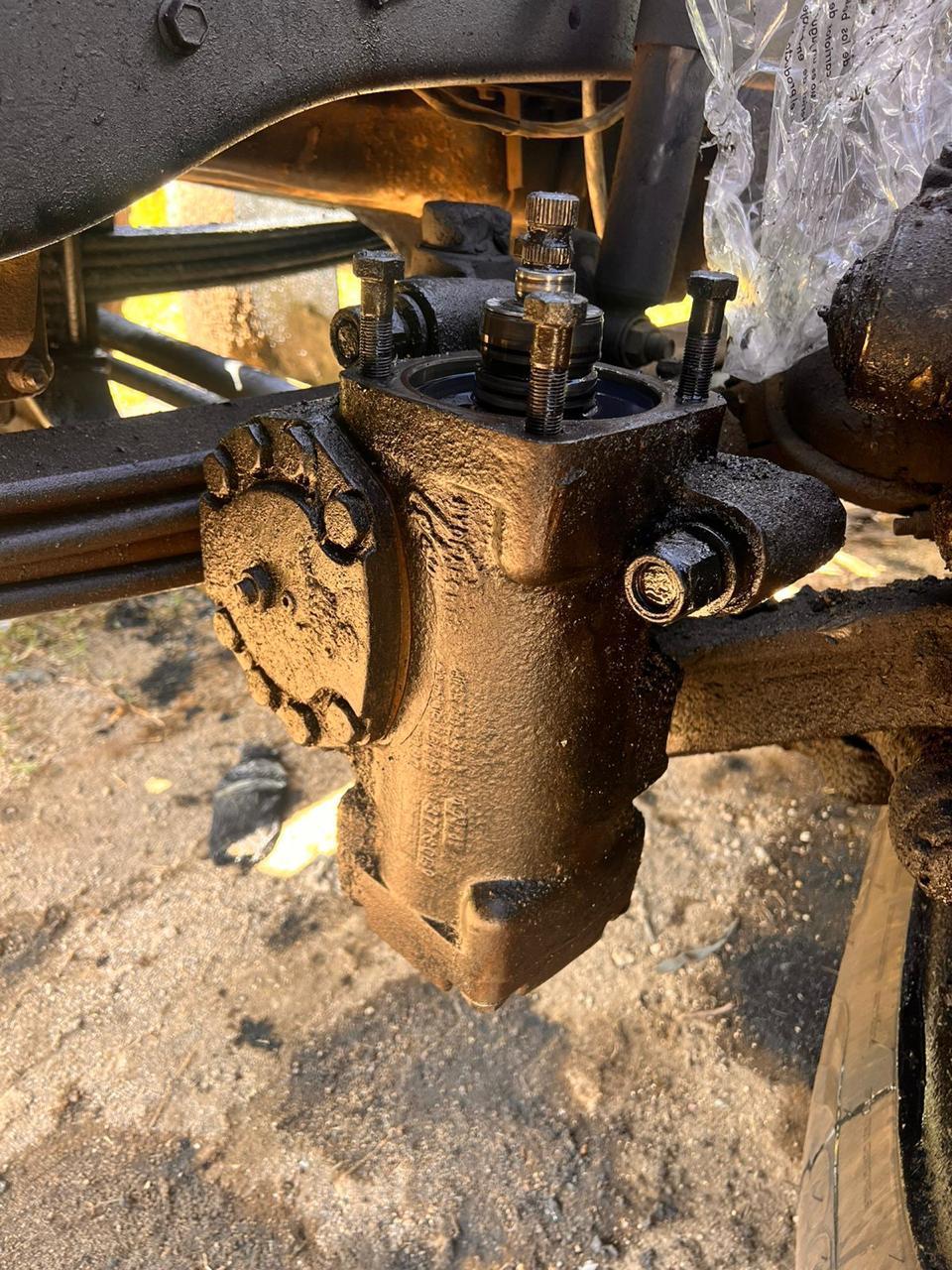

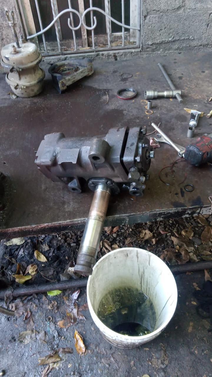

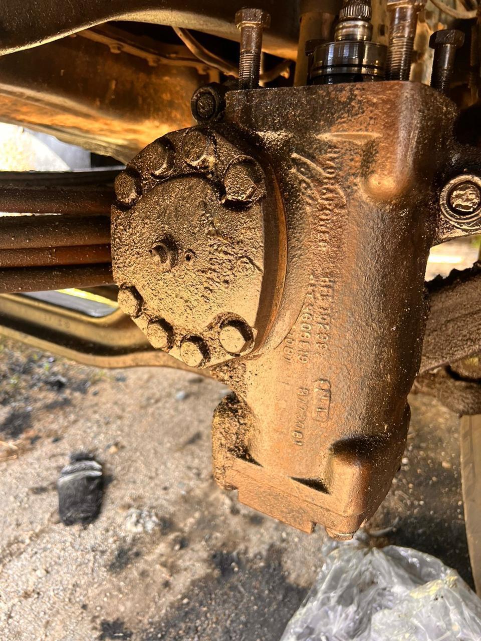

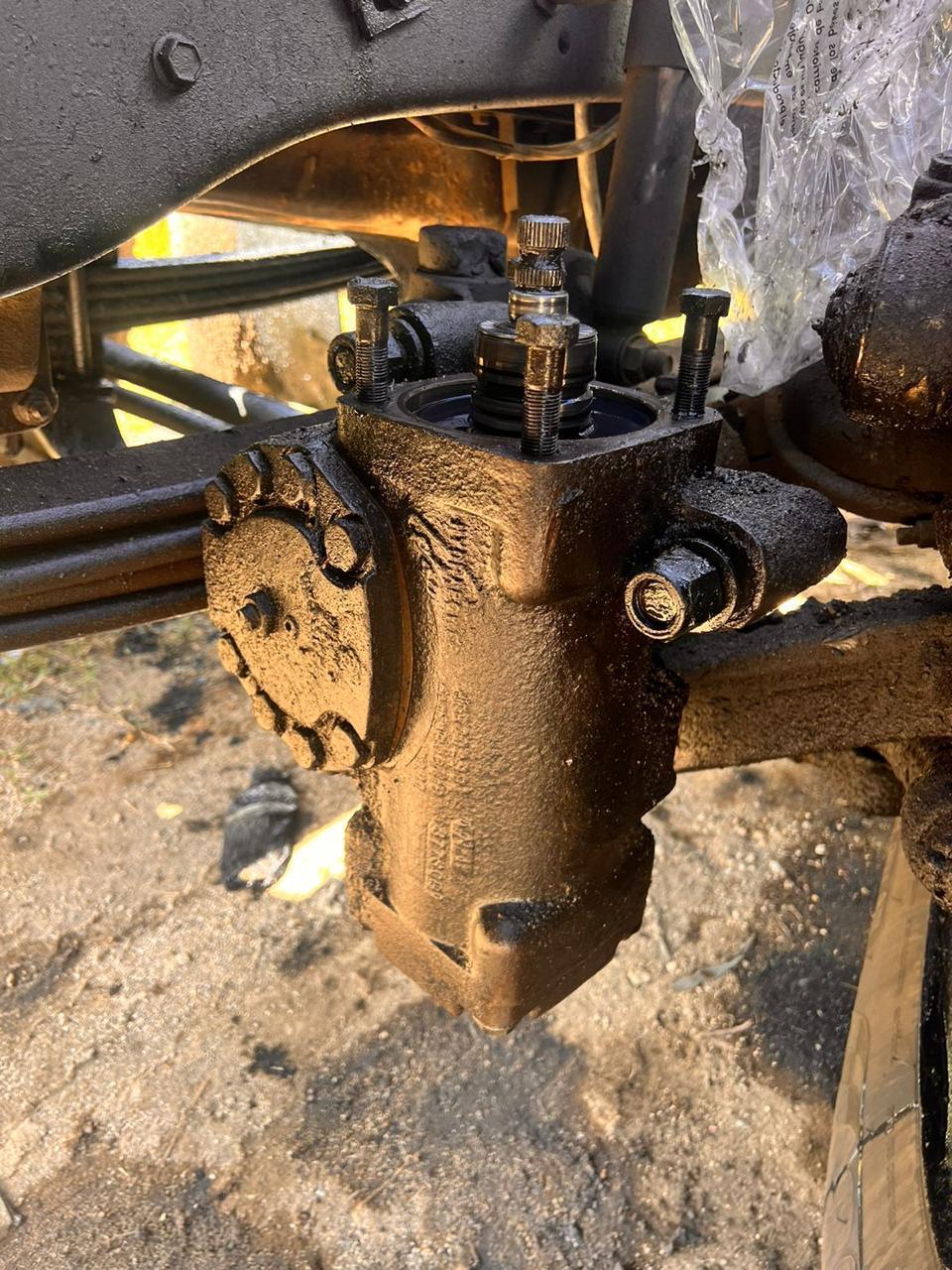

Hello friend, I am Franklin from the Dominican Republic, I have a Mack Superliner with steering box problems. The previous owner replaced the original with an adaptation and now it doesn't work. I would like someone to tell me which one is the original?. Here I leave you some photos of the one the previous owner used, which is not the original.

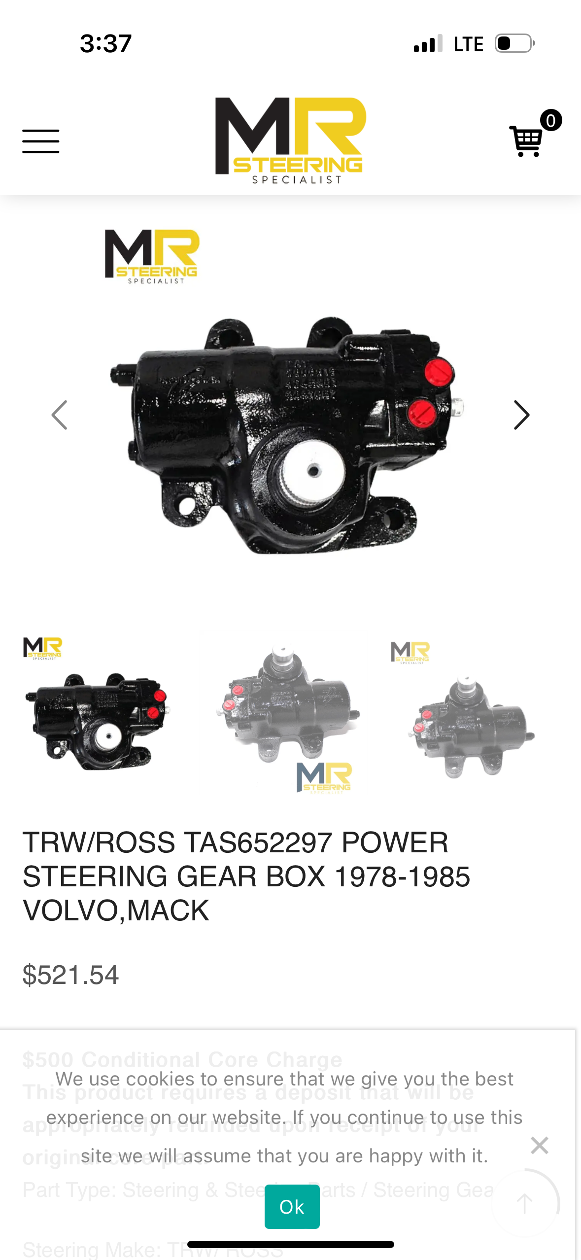

I think I saw a steering box re builder in Florida that stated they could be swapped over with slight modifications Prior to that I had never heard of it either this was a recent ad I was looking for parts for mine

It's just that when I bought it it was like this, that's why I'm asking if anyone knows which one is the original. This is vin number 1M2V215Y9EM002105

This is the only one he has had since I bought it, this one is attached to the train

The steering box is badly scratched and makes the guide hard when the truck is loaded.
thanks for replies , but "box badly  scratched " : at this point adds to confusion. was box #1 scratched and replaced ??  is there a problem with PS pump; does it have a changeable filter ? if so did you change and inspect filter for contamination?  gear /rotary PS pump failing contaminating system?? without visual hands on inspection ; let's hope someone having similar unit chimes in .

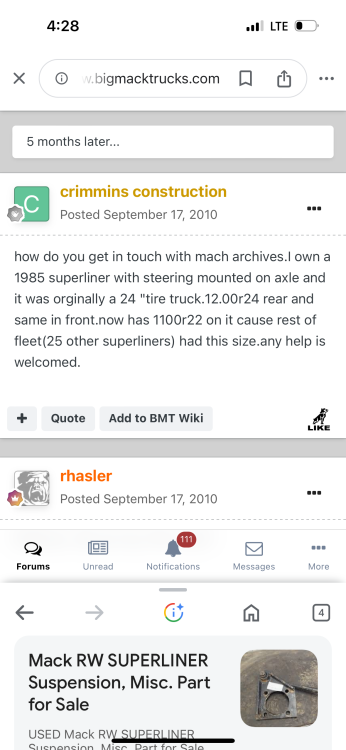

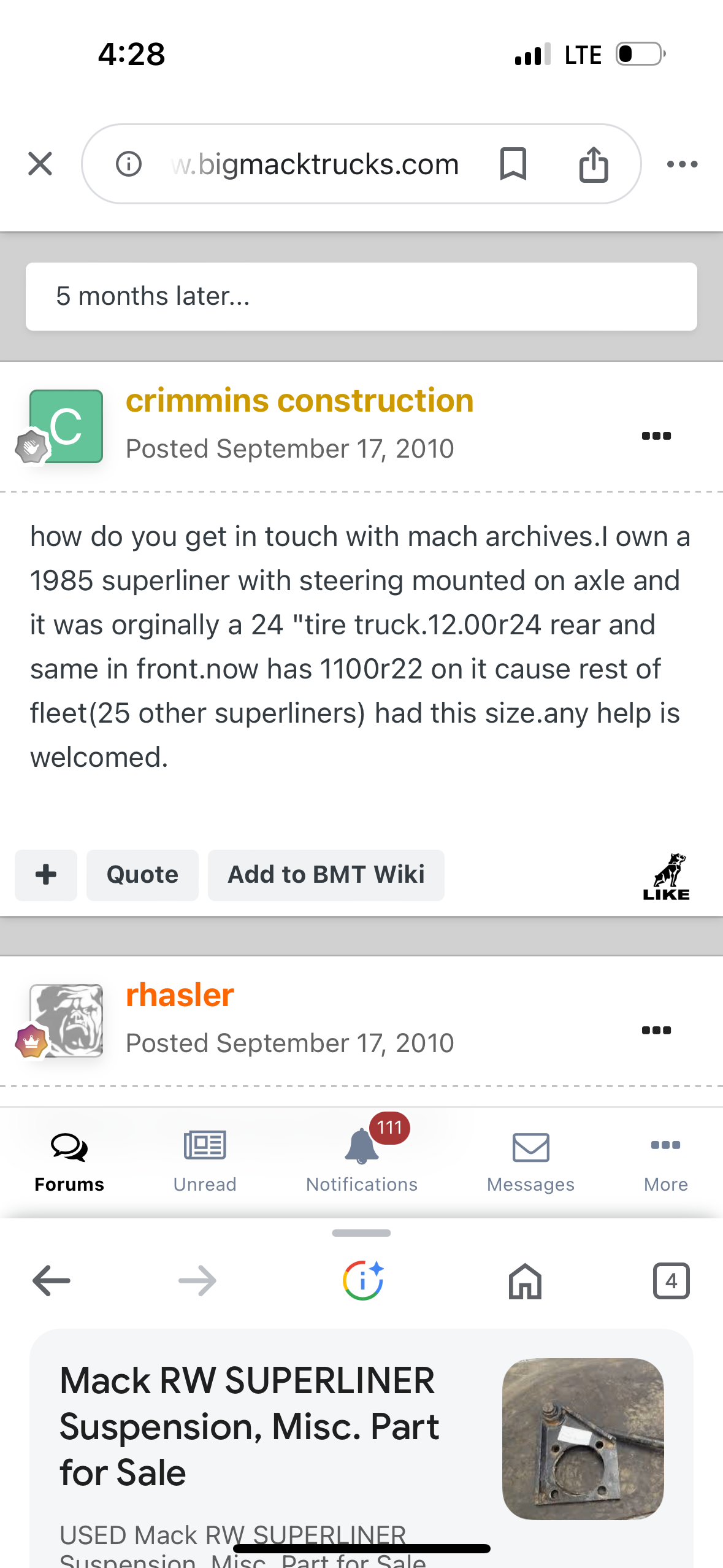

some supers and cruise liners DID have steering boxes mounted to axle. don't recall that set up with box being extremely close to steer axle brake chamber during turns. possibly going to Woodbury CT Friday ; location of two superliners. will check the steering systems and take pictures IF they have the axle mount systems. based on picture of box axle mounted ; have to wonder of the "adaptation "kit number ????
got to picture taking of the two superliners today. attempting to transfer/post pics  ,I succeeded in deleting ALL the pictures on my phone. not many by todays standards (only 70=80). however they were important to me. sh-t happens. both units are '84's with boxes mounted on axle. one is a RWS721LST /vin 1M2V121YXEM061364. same green super shown on BMT under topic of V8 superliner  -E9 400 ...  2nd super RWS700K /vin 1M3V223K3FT003286 , 335 ? Cummins. Will attempt again with pictures.
On 5/13/2024 at 7:07 AM, Franklin205 said:
the two supers had basically same set up. talking to owner; pre '84 steering boxes were axle mounted, hayward units. later units frame mounted .
