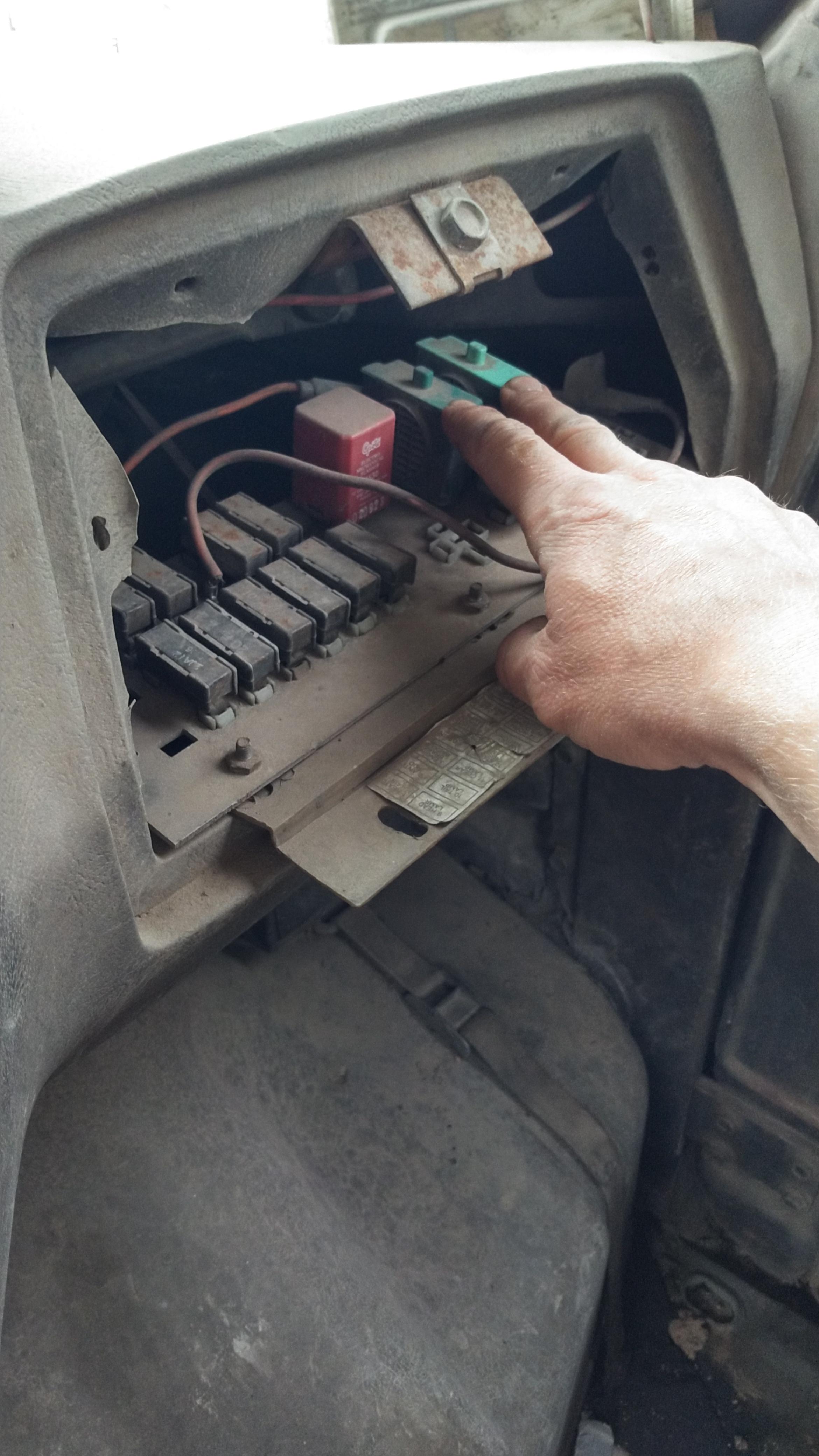

2 hours ago, JoeH said:
1980 dm686sx
Low air buzzer is one of these 2^^
I think this one is Service brake lights^^^
T'd into the parking brake knob there's the parking brake light switch.^^^
Wow, I don't have any of that in the glove box.  Mine is totally empty. There is a fuse block under the box but there are no blue boxes anywhere over there.  I looked under the drivers side dash for boxes as well but found nothing obvious.

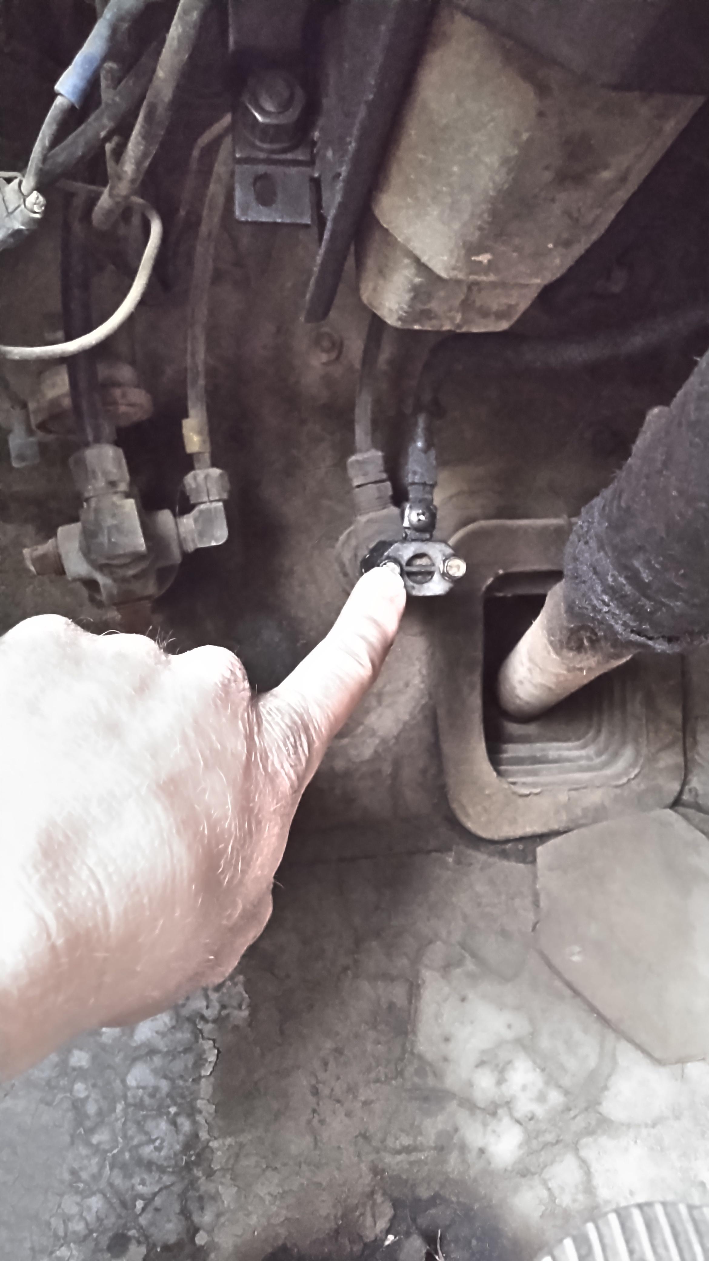

I am replacing both of the switches behind the brake pedal.  The one you are pointing at and the one to the left of it.  The one on the left is the one that shuts off my low air light. The one on the right, you are pointing at, is a 70psi switch. It did not do anything when I disconnected it.

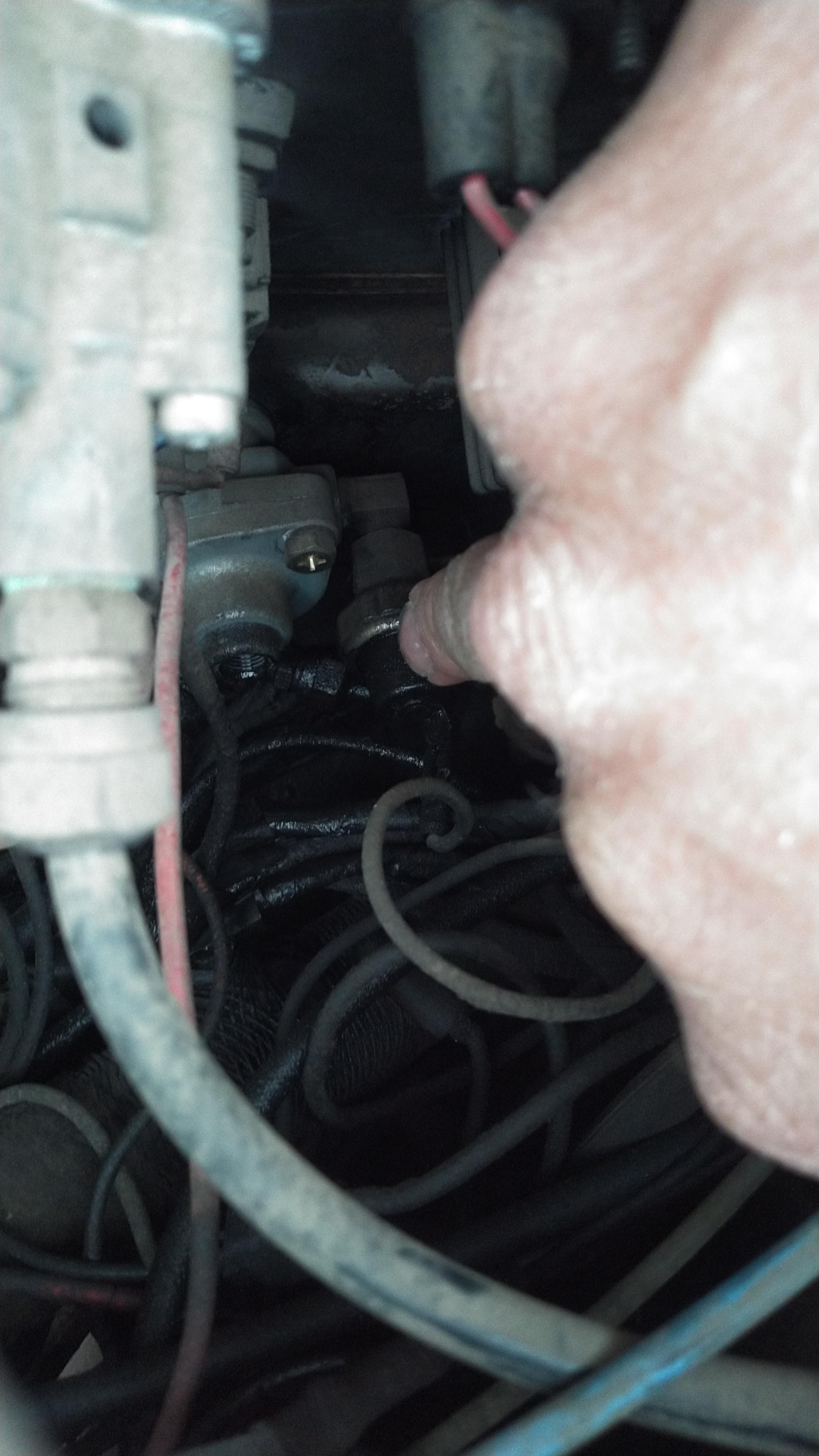

I looked inside the dash by all three air knobs (emergency, park, and trailer/system).  I do not see a button type switch anywhere in there except on the emergency knob.

Emergency knob is probably the right spot for the switch.  It should kick the lights on in an emergency braking event. Your truck was set up for a trailer so you have 2 or 3 knobs, whereas mine had always been a straight truck til we slapped a 5th wheel on it as a yard truck for retirement.

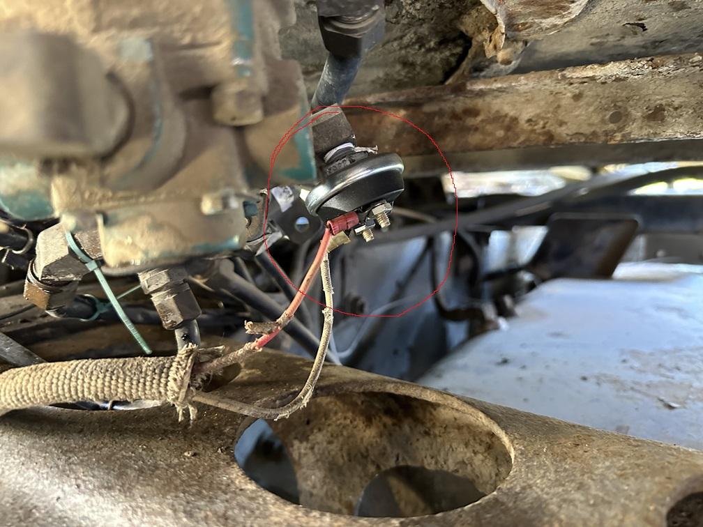

I forgot all about those updated buzzers!! along with a lot more. older buzzers were mounted above clutch pedal on dash frame work. rectangular 1x2 black metal box with( 2 ) TWO wires attached. picture one Gunny65 posted of new valve would/should be brake light switch . picture two of gunny and  Joe H should be the low air sender. which is what I tried to describe earlier as the single pole  3/4X 1 white sender. from what is described in terms of the hacked wiring on this unit ;it will be a long tedious project.
  • 0
Mech,  thats where I remember the buzzer to be.  on the back of the triangular gusset above the clutch pedal..  I do know that in the 90's RD models and newer that I have worked on, it's name was changed to a Multi Buzzer.. it was so loud when using turn signals, that all of the drivers in my fleet would un-plug them.. then I would plug them back in when they were in my shop for the next PM.. The DOT Man doesnt like it when they are un-plugged..

There are no switches, that I can see, that are directly connected to the main parking system push knob. I took the dash apart and can see in there.  There is a threaded opening on the back of the knob assembly with nothing in it.  No leaking though.  There does looks to be a pressure type switch on the emergency brake knob.  For now, these pics show what is connected to the low pressure switch.  I can not find the low pressure buzzer. The manual I got is not very helpful. It shows a low pressure switch but I see nothing that resembles that switch.  The book pic has an electrical connector on each end. Everything I see has connections on one side. I just don't know what I am looking at. Anyway, pics.

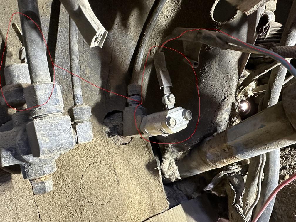

The first pic is of the switch I replaced. It is directly under the brake pedal and connected to the brake valve assembly.  That assembly is on the outside of the firewall.
The second pic shows a switch on the left that has a wire that connects to the switch on the right and that switch wire goes to the low pressure lamp. The other wire connected to the right switch it goes into the wiring loom. Both of those assemblies are directly behind the brake pedal and mounted on the inside of the firewall.
the switch on the left which has the spade terminal unplugged and a possible wire hanging looks more  to be a sender from a kysor AC/ shutter system. I'd plug it on terminal see if any thing happens. red line covering clear picture; but seems to be a wire was spliced into white sender .my first place of tracing  why/ where they go.
THAT!!  I have a black box right where you are talking about.  It is not connected to anything and I didn't know what it was. Excellent.  Thank you. I will take a pic tomorrow.  There are not any unconnected wires hanging near the box that I remember seeing but then again, I wasn't fixated on that part.
I unplugged that switch you saw on the left of my pic.  When I did, the low pressure light turned off. I plugged it back in it came back on.  I then unplugged the white square looking switch on the right of my picture and the low pressure light came on.  I did notice the square switch on the right has 70psi written on it. The switch on the left has no markings at all and looks to be original. Rusty and beat up really.  Now that I know where the buzzer is, I am going to see if that has something to do with the buzzer. I am getting closer.  Thanks everyone.
