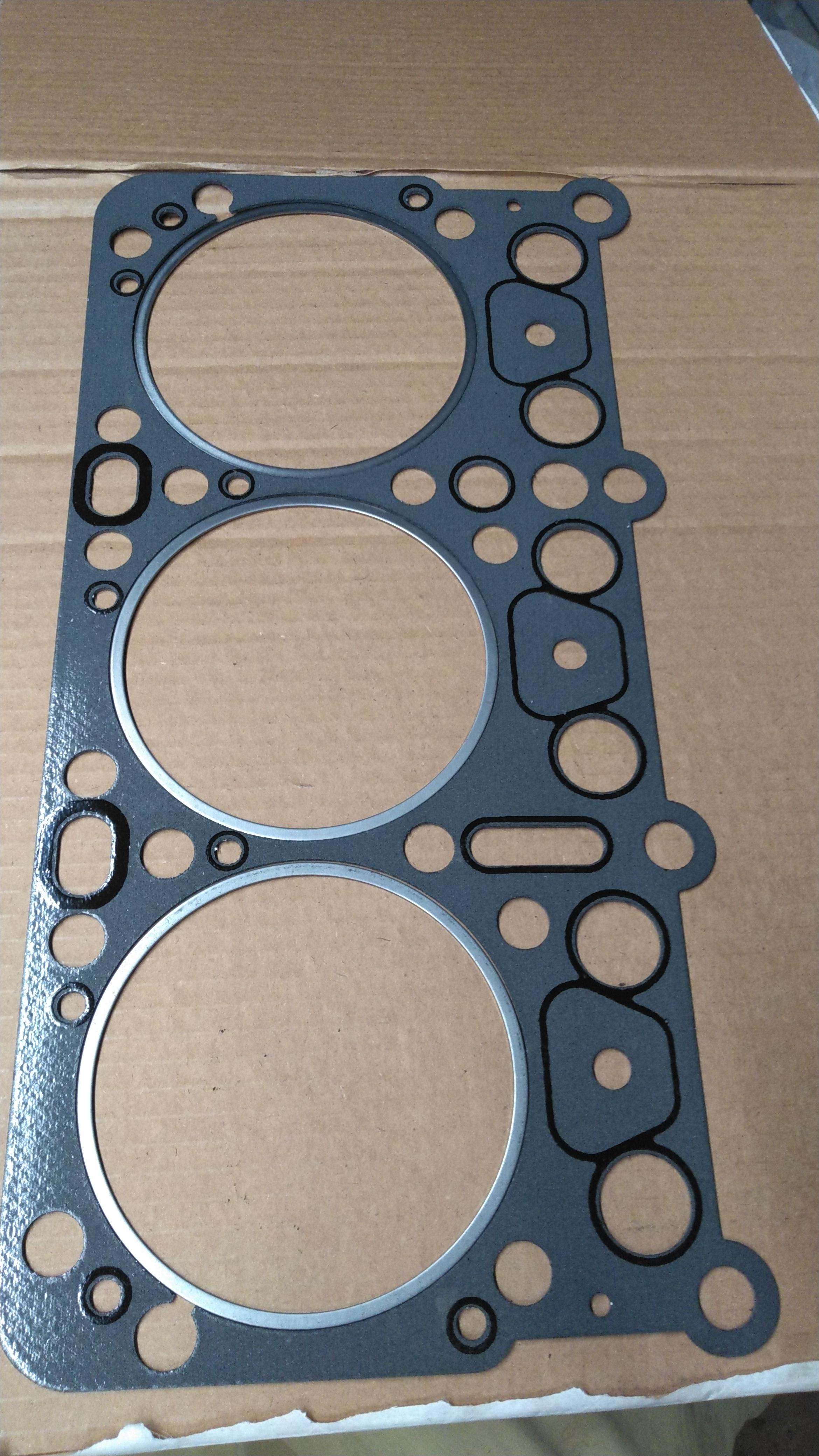

these are the 2 full gasket kit numbers minus head gaskets.. if this is still available, I would consider buying them..  I also posted the 20 bolt head gasket part number.  is your's 20 bolt? the head gaskets are the only difference that I know of...  I am by no means an END or E-6 guy..  This is just what is in my shop right now..  I know you are not this deep in the engine, just hoping these part numbers are good info for you,   Jojo
