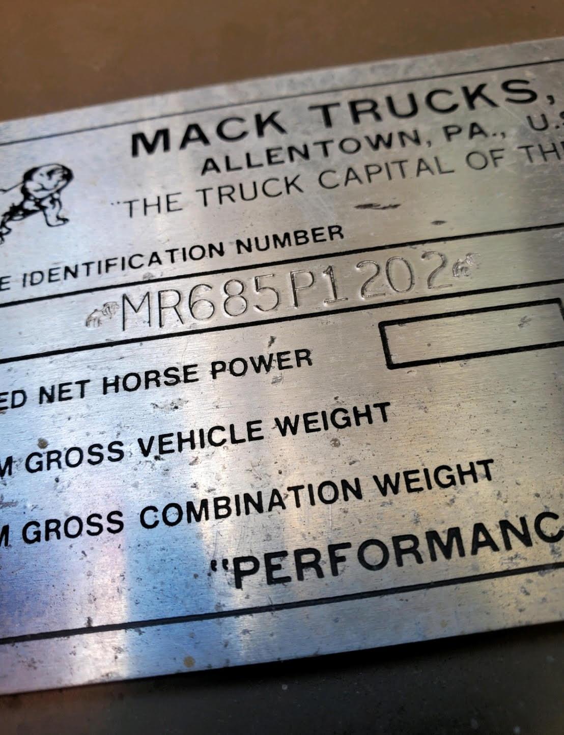

The part number my Mack guy at the dealer gave me was 454GC568B which according to PAI they had several in warehouses across the US  Guess I'll see when I get the cam.  Also just a FYI my VIN is MR685P1202.  All the newer guys around tell me that isn't a good heavy truck VIN, hench why I just go to the dealer.
Took a little bit to figure this out, but as long as an ENDT675 is the same as what Impact says is ENDTB675, you have the correct camshaft part number, and PAI does show stock of their version ECM-9002.
This is also the oldest Mack I've searched parts for.
