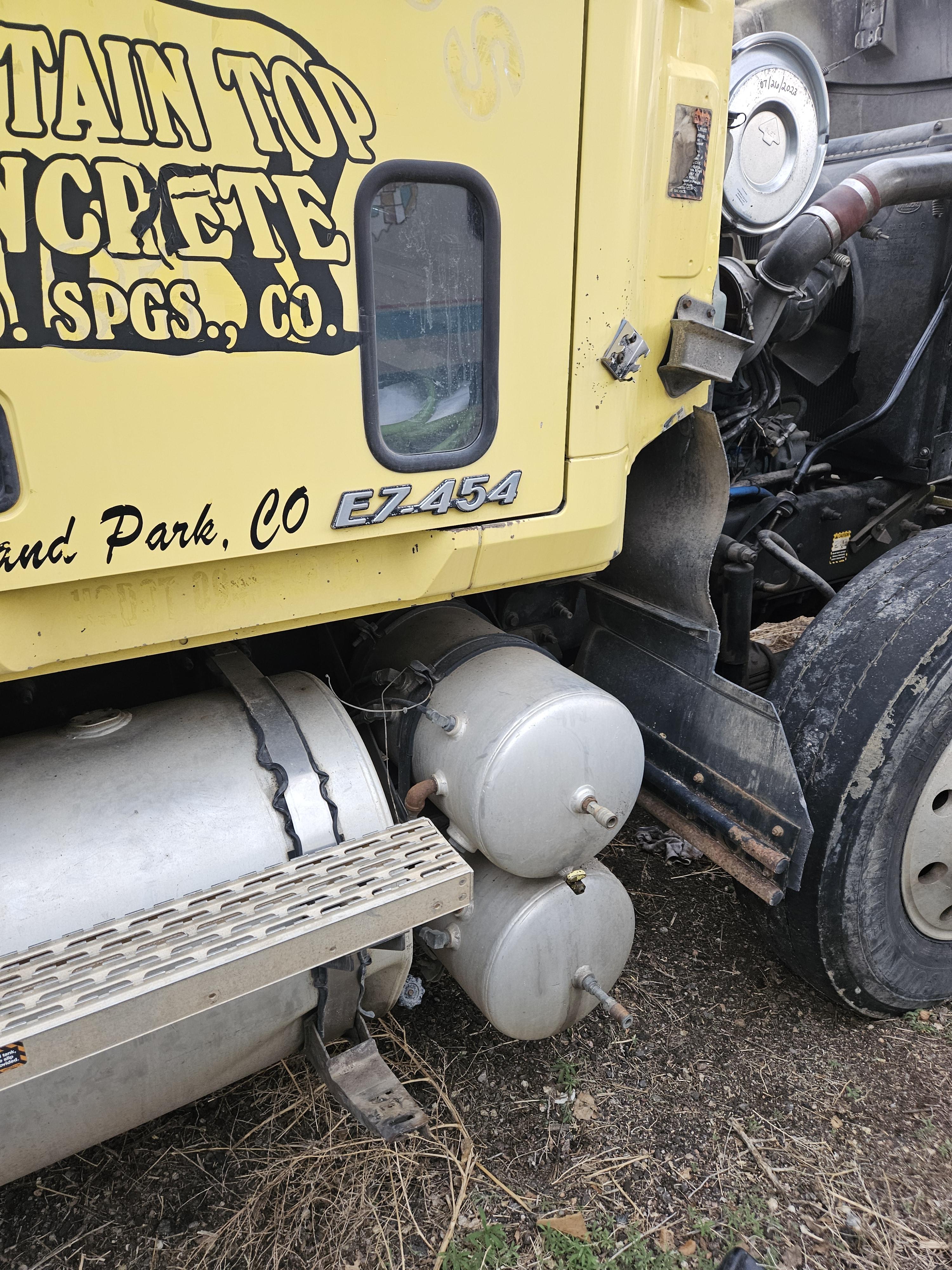

I have been searching and searching for the problem on this truck  it's a 96 ch e7 454, throws blink code 4-2 I changed the speed sensor , didn't help at all. I have no tach no speedometer, but if I start truck and pull seedo circuit breaker the light goes out and stays off but I have not been able to test drive to see if it got the power back ..  only gets about 15 psi boost  and the boost needle shudders to get that . It runs fine no miss or anything just no top end power
