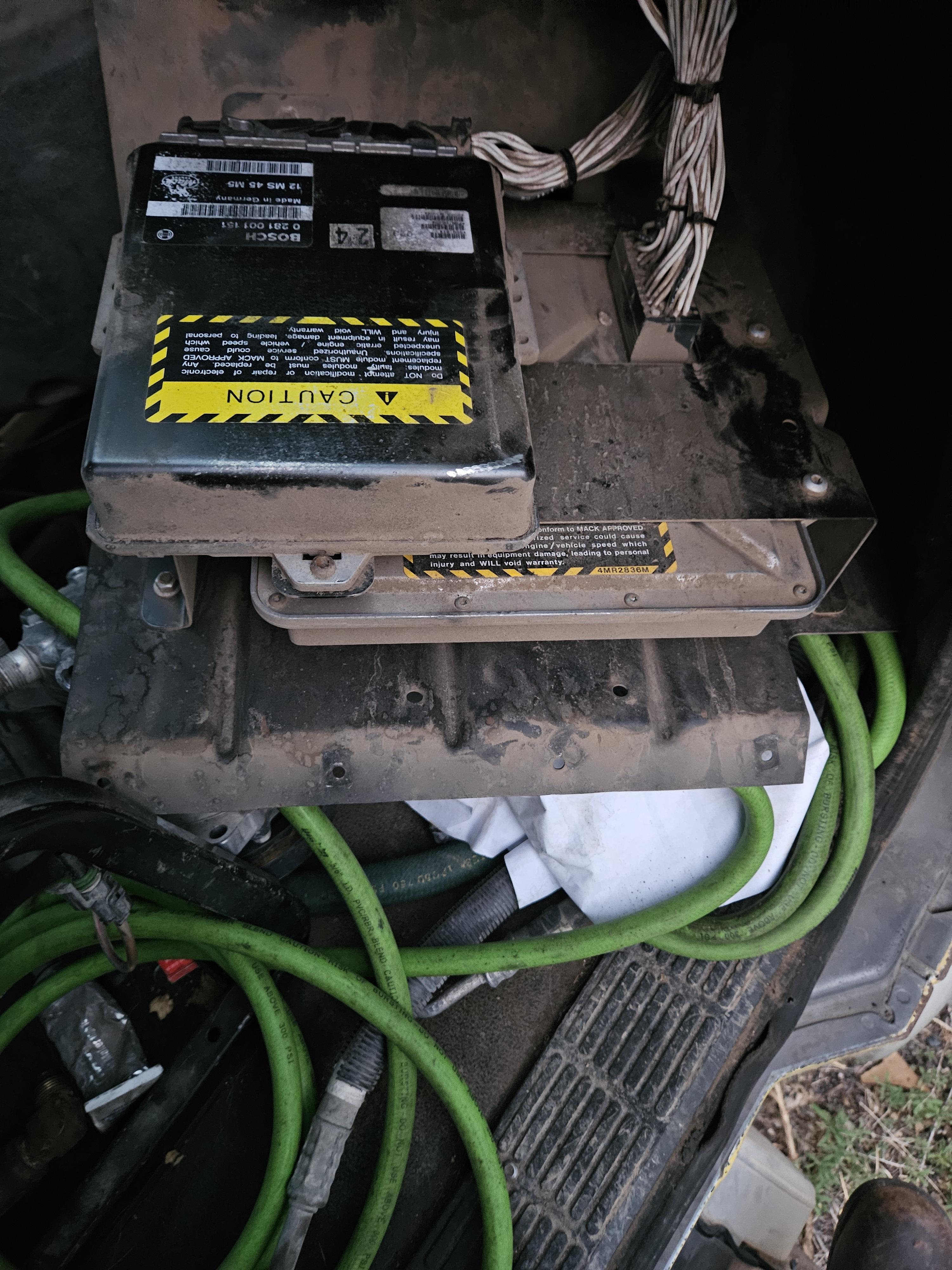

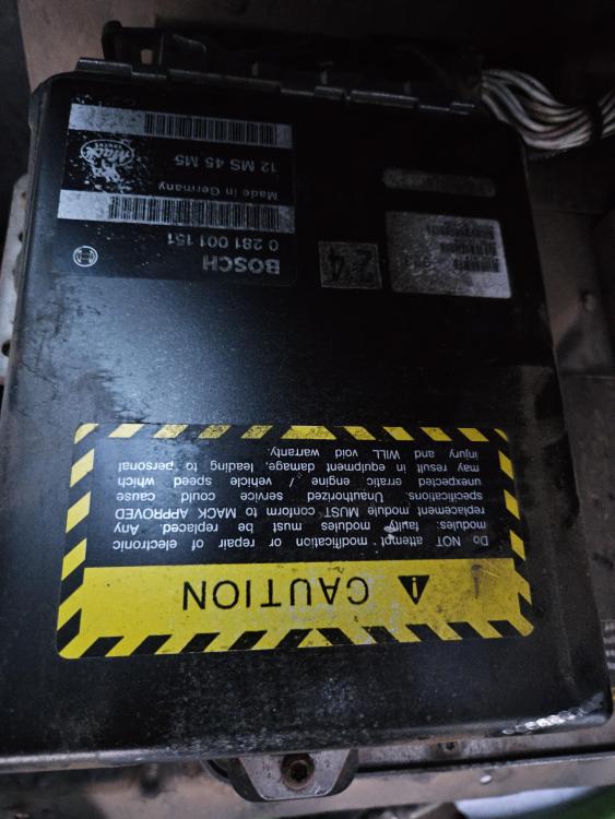

 VMAC 1  Fic is the bosch module ! Your issue will likley be with the VECU the aluminum one! it gets all the vehicle inputs ! and talks to FIC and tells it what to do!

So I installed new speedometer and still have code can't dive it to see if the speedo is working but definitely still have the code. The speed sensors I have are only at 160 ohms book says 200 to 300.. but I still can't figure it out. If you guys have any other ideas.  I can get a vmac module from a 95 rd but I am unsure if it is compatible, I think I will have to take it to the dealer to change it but not quite sure how all that works just yet

Does anybody have any ideas on whether that used v-mac module would work or do I have to take it down to the dealership to get it to work I wonder if it's just plug and play or if I put it in there and it wouldn't have the right information
