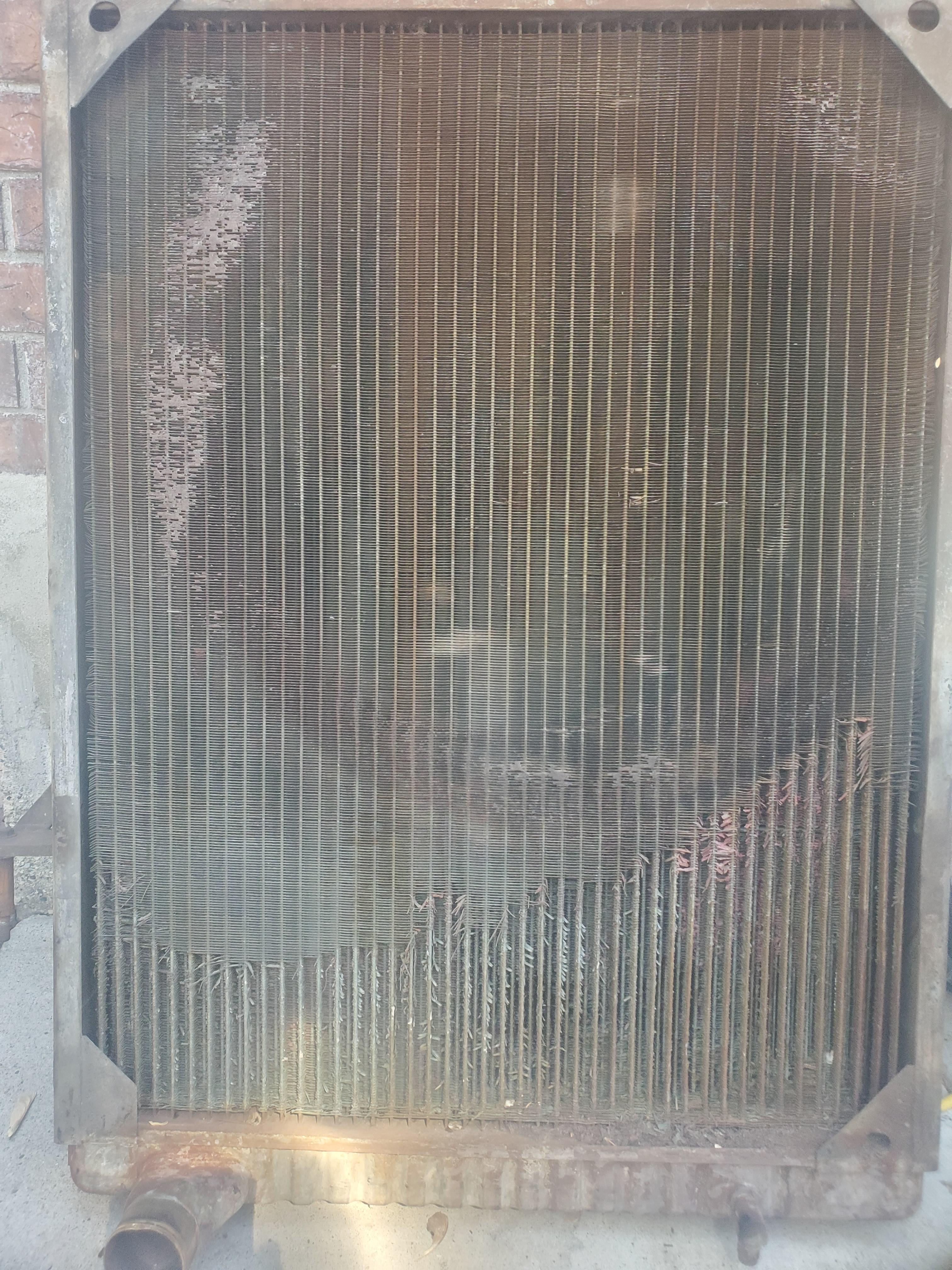

My truck being older, 1979, and with a brass radiator, my local "go to shop" for heavy truck radiators says he has been able to locate a viable core to rebuild my radiator.  He said if he did locate one it would be pretty spendy and recommended I just replace while radiator. As you can see from the pic mine is pretty dead.  My question is, I was able to pickup a Mack heavy duty truck radiator where the core dimensions are the same as the one out of the truck.  Mounts different, but I have no problem fabricating a new mounting bracket.  This radiator does not have the cap in the upper tank.  Should I put an inline radiator fill in the upper hose or should I add an auxiliary overflow tank the way my other two trucks are.  This truck never had one.

I totally agree about "all it takes is money"  but that is something due to many circumstances I just don't have.  My shop just says they can't get a core to rebuild.  Maybe it is the attitude of shops in my area.  When I first had my breakdown last summer I approached several shops about doing the work.  I was either told that they were interested in working on older trucks or that the parts were all no longer available, thus the truck was dead in the water without a new engine swap.

I ended up buying a new Mack radiator. The core dimensions were all the same as the old radiator. But this radiator requires an expansion/overflow tank.  I got an expansion tank off off a dead trk in the yard. From what I was able to see (this trk had a side mounted radiator) the large hose out the bottom goes to the lower radiator hose. My question is the two smaller hoses that go into the top of the tank.  It appears when tracing down the lines on two other trucks with expansion tanks that one line goes before the thermostat and the other goes after the thermostat (upper radiator hose).  Just wanting to double check being my pickup only has one small line into the top of the radiator and google searches have basically been geared towards automotive systems.
This type of system is called a "bottom fill" the expansion tank, whether on the top of the radiator or somewhere else is not open to the top tubes of the radiator or, in a cross flow (which is what I believe you have). The idea is the radiator stays full to the brim with coolant, while any air gets forced through the small vent lines to the expansion tank.
 When you fill the expansion tank, the coolant flows to the lower (waterpump inlet side) hose. as the block and radiator fill, the trapped air flows out the small vent lines to the expansion tank.
 With the engine running, a very small amount of coolant is forced (along with any air) through the small hoses to the expansion tank (sometimes referred as a "de-aeration tank), and the coolant, now free of air, flows back down the large hose and back to the waterpump.
 This means the radiator doesn't have to be the highest point in the system (expansion tank does) but does mean any points that could trap air need to be vented to the expansion/de-aeration tank. Often those points are the upper water rail near or at the thermostat and the upper or hot water out radiator hose. On a down flow radiator, often the upper hose/top tank vant can be internal if the de aeration tank is mounted on top of the radiator, just a small hole drilled thru will allow the air to bleed out.  This prevents air from being recirculated when the 'stat is closed and hot-spots in the engine.
