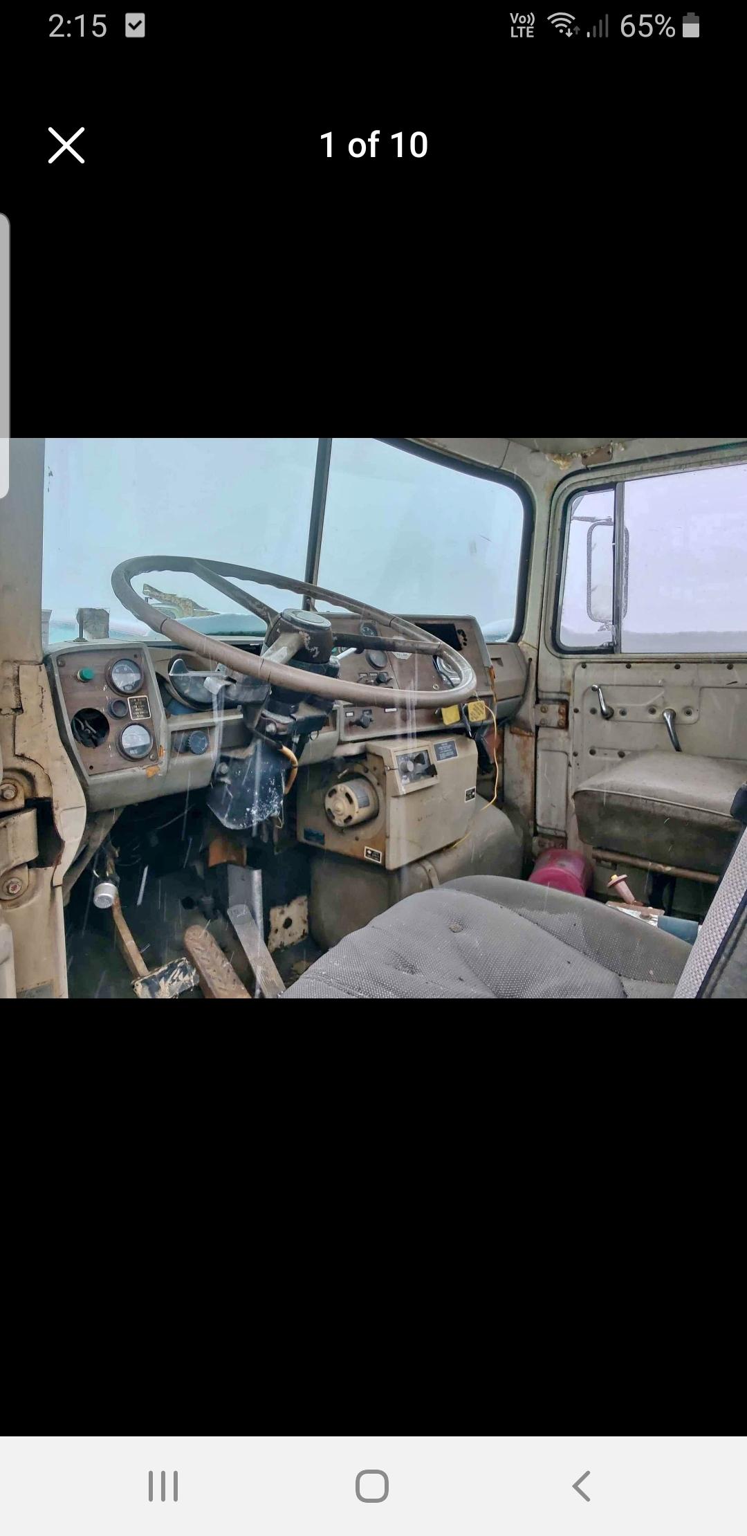

So the U and the DM  are a different cab, as in more motor is in the U cab than the DM cab ?
Great stuff everyone, and as Swishy says, "you can have free pass your very own beer fridge", or something like that
Inside a U cab
Paul
