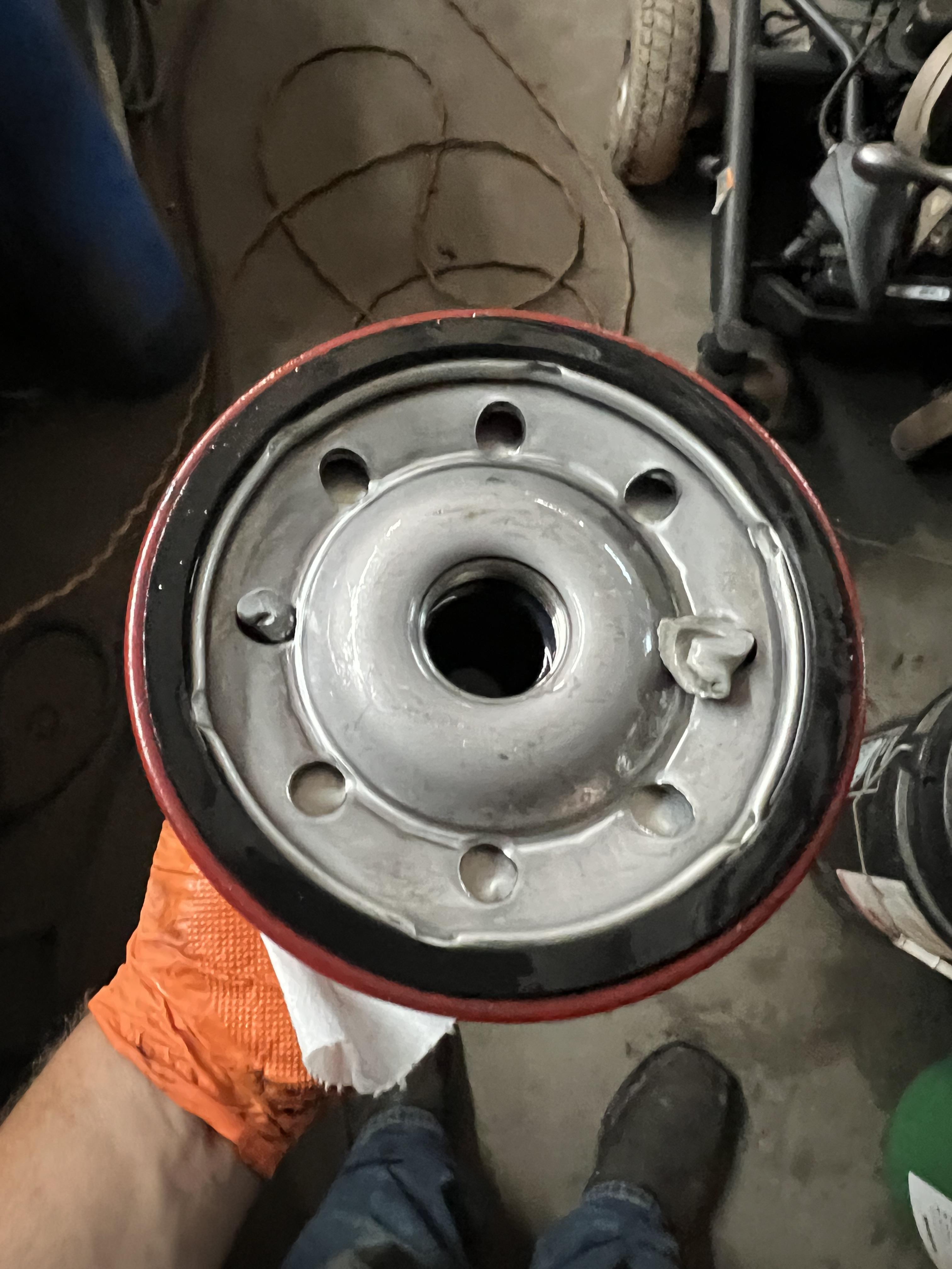

While driving the motor popped back through the exhaust with a poof sound and a puff of black smoke. After that turbo will only build to 25 pounds and it has roaring noise over around the turbo area. And still pops back through the exhaust but it is random. No check engine light. The motor runs good still pulls loads fine. Changed the fuel filters on it and found silicone chunks in the top of the primary filter. But it is still doing the same thing

So it truly is silicone and not fuel worms?  Thats really odd. Do you have a Davco filter as well
Not sure what are fuel worms? It has two filters side by side on the left side. It doesn’t have a water separator

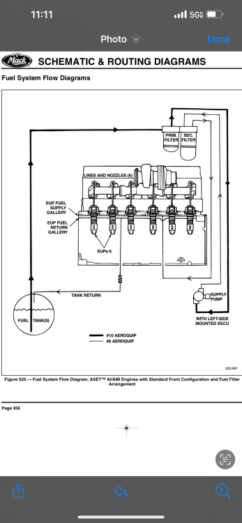

It is cv 713 yeah I am going to figure out how to pressure test it with the smoke.  But what ever happened yesterday happened all at one time I heard the pop and after that I had the boost problem.also when it pops you get puff of black smoke out the exhaust.  But also the primary filter is only half full of fuel isn’t that supposed to completely full all the time? I also have replaced the fuel lines from the tank to the filter and the filter to the pump.
