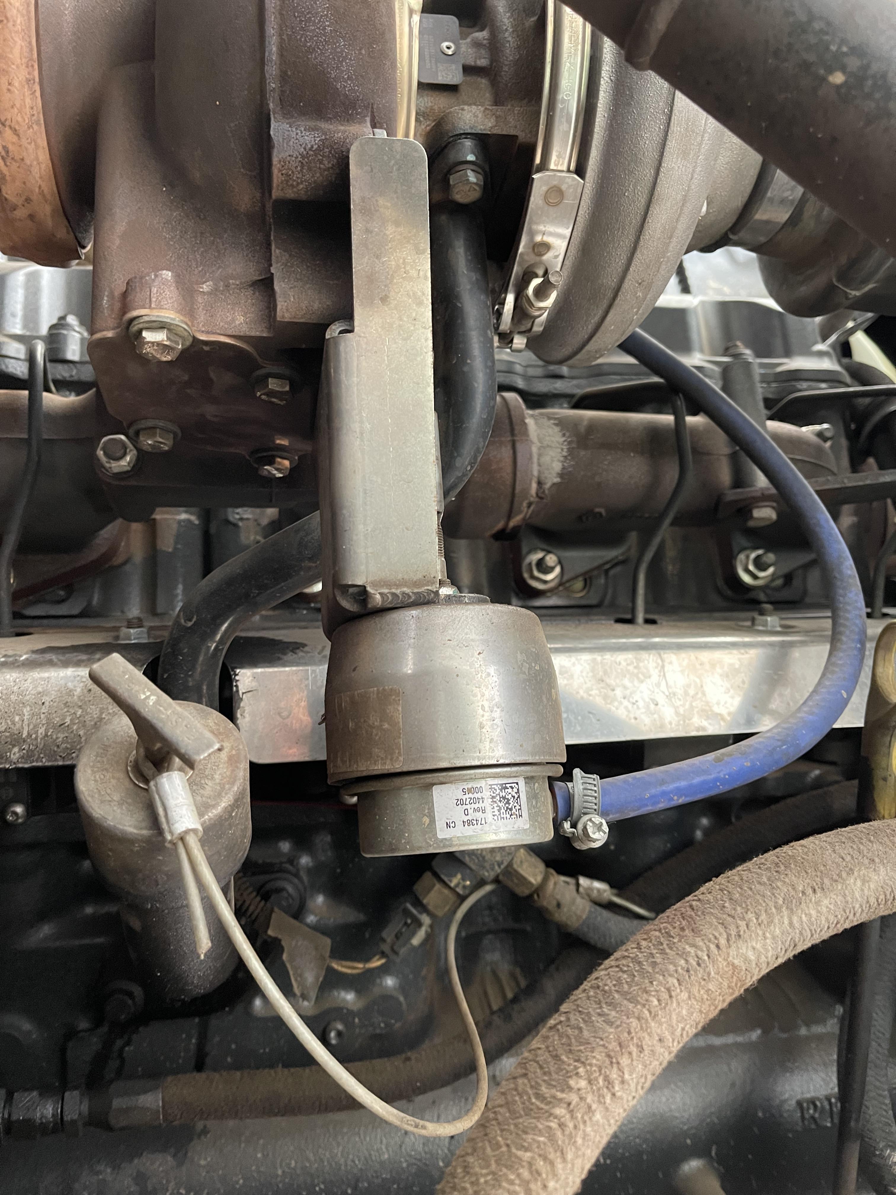

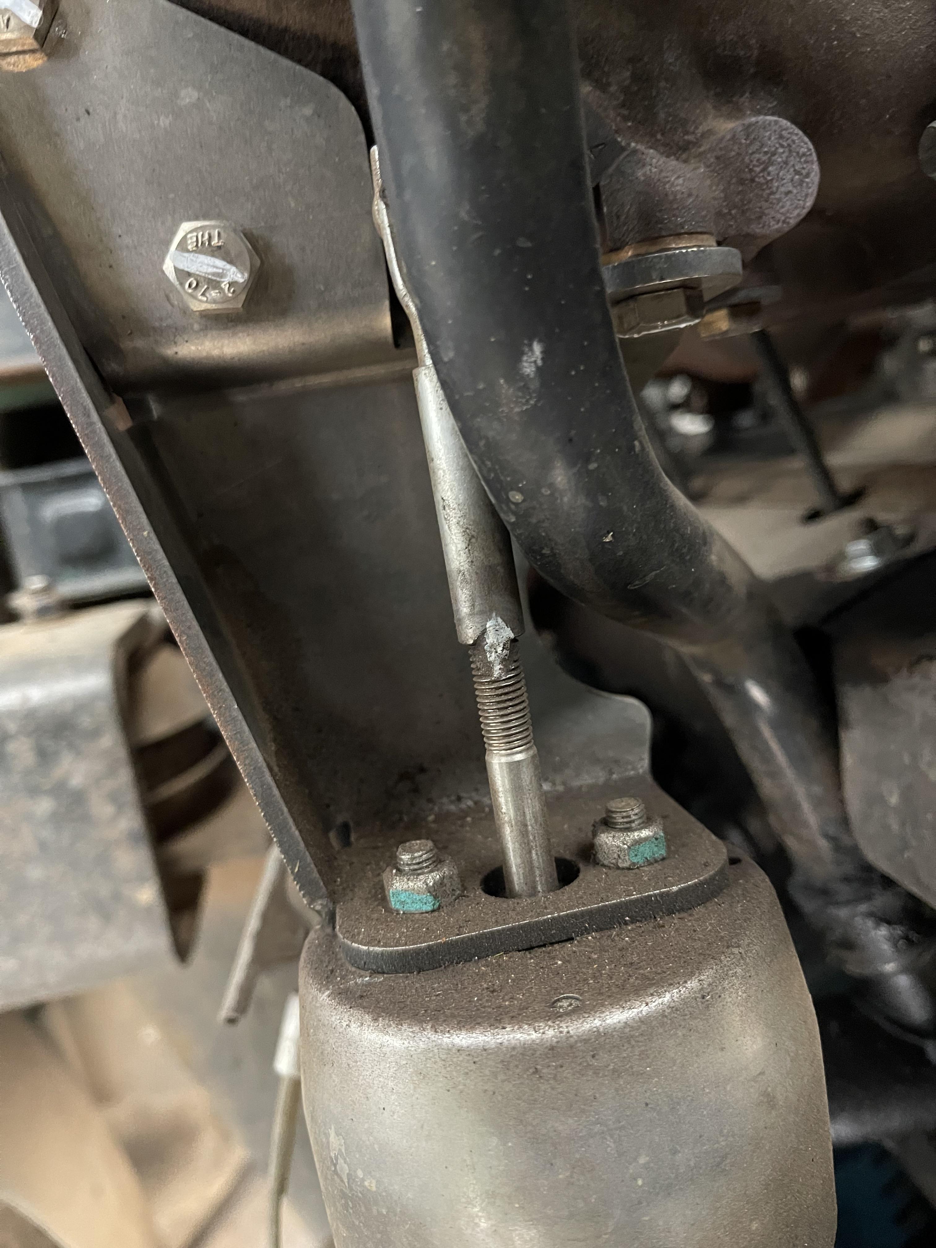

Mack service bulletin SB-214-017 covers testing the testing the wastegate. It’s pretty detailed on testing and when it should be opening and staying closed. Be sure to pressure test the complete intake system.  Thoses years had paper intake manifold gaskets that were later changed to steel core gaskets due to blow outs. The air compressor can get its fresh air from the back of the intake manifold. This metal pipe and hoses can leak which leak boost pressure. Unit pumps and injectors are wear items and can weaken over time.
  • 0

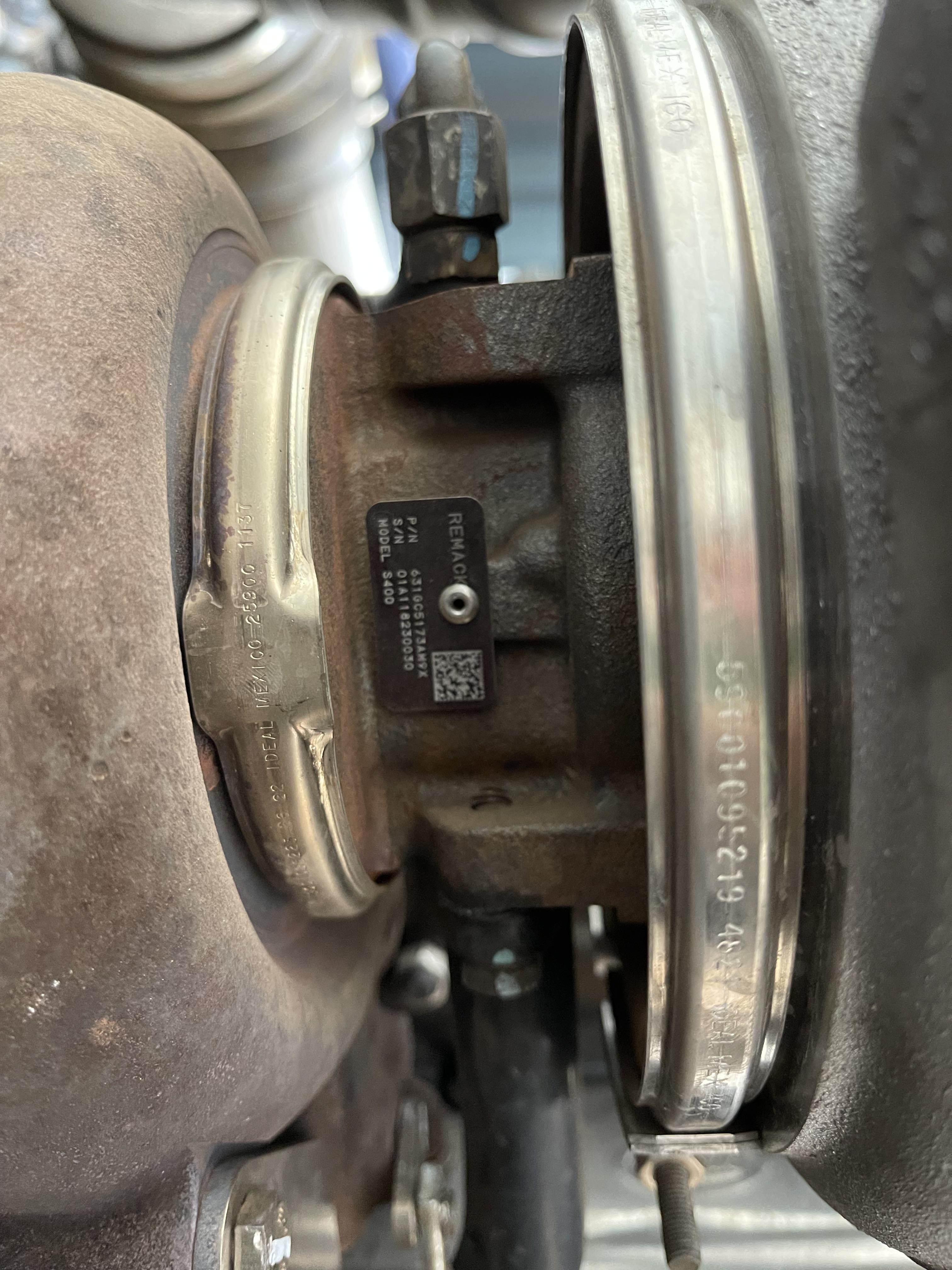

Thanks we have changed all hoses new intercooler new manifold new injectors three of the eups have been replaced due to slight leaks and bringing up faults it had steel manifold gaskets will have to check turbo watergate I’m sure the adjustment on the new turbo had a spot weld on it so it couldn’t move but will double check . Before we swapped the engine out we swapped the turbo made no difference then they put on a brand new wategate  because that was apparently the problem that made no difference nearly ready to throw petrol and matches at it
