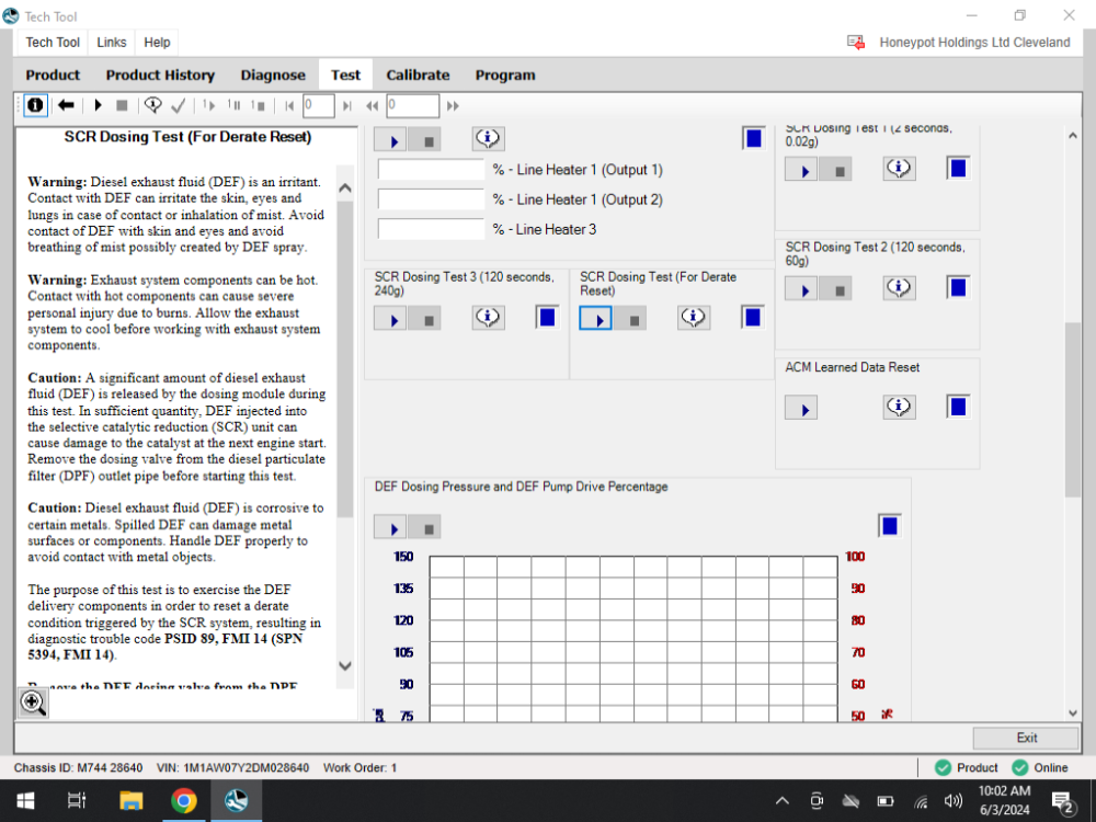

I go to the Test section/Intake/SCR System test in PTT but all I see are dosing tests, activation and such. I don't see anything that says inducement nor anything about exiting the inducement. I removed the doser and did the 2 second and 120 second tests and they passed but nothing about inducement.
Your on the right page , you have to you have to scroll the slider down on the right hand side of the screen to see the bottom of the screen. It might be called something like SCR re-set but it’s with the DEF dosing test. Is this an actual version of Tech Tool or a bootleg copy?
It’s called SCR Dosing test (For Derate Reset) that is the closest thing to Exit inducement . I think we used to do the Derate Re-set  , then 2 regens and a 45 minute test drive . I can’t get the picture to upload for some reason

  • Solution
Exit Inducment is only on the 2013 OBD trucks with the 16 pin OBD connector. On the 2010 emission trucks we do the reset and 2 regens and if the engine sees good NOX readings it will unlock the Derate. You can start a regen then unplug the 9 pin  Doag adapter and back out of the regen screen . Plug the diag  connector back up and go into Test and then Monitor sensor and choose the inlet and outlet box sensors and view the nox readings while the regen continues
