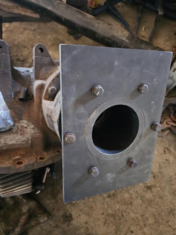

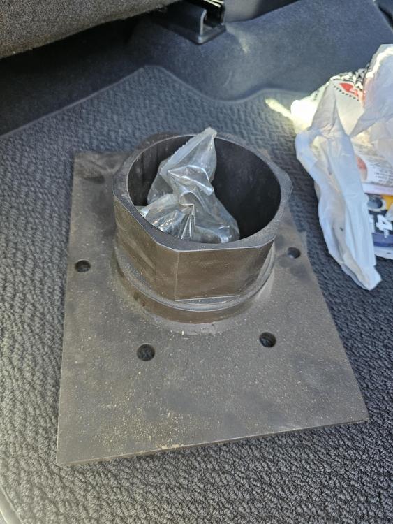

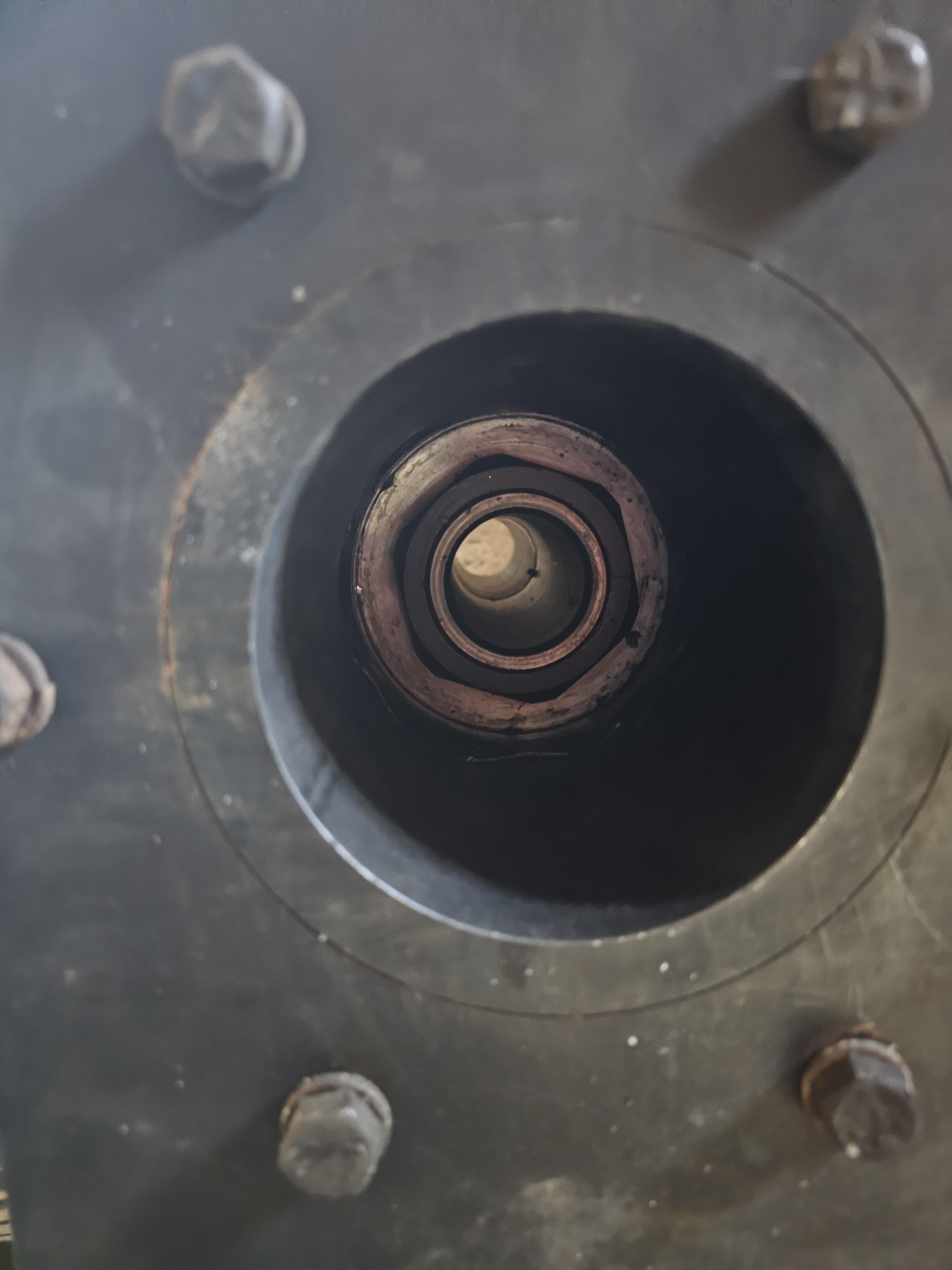

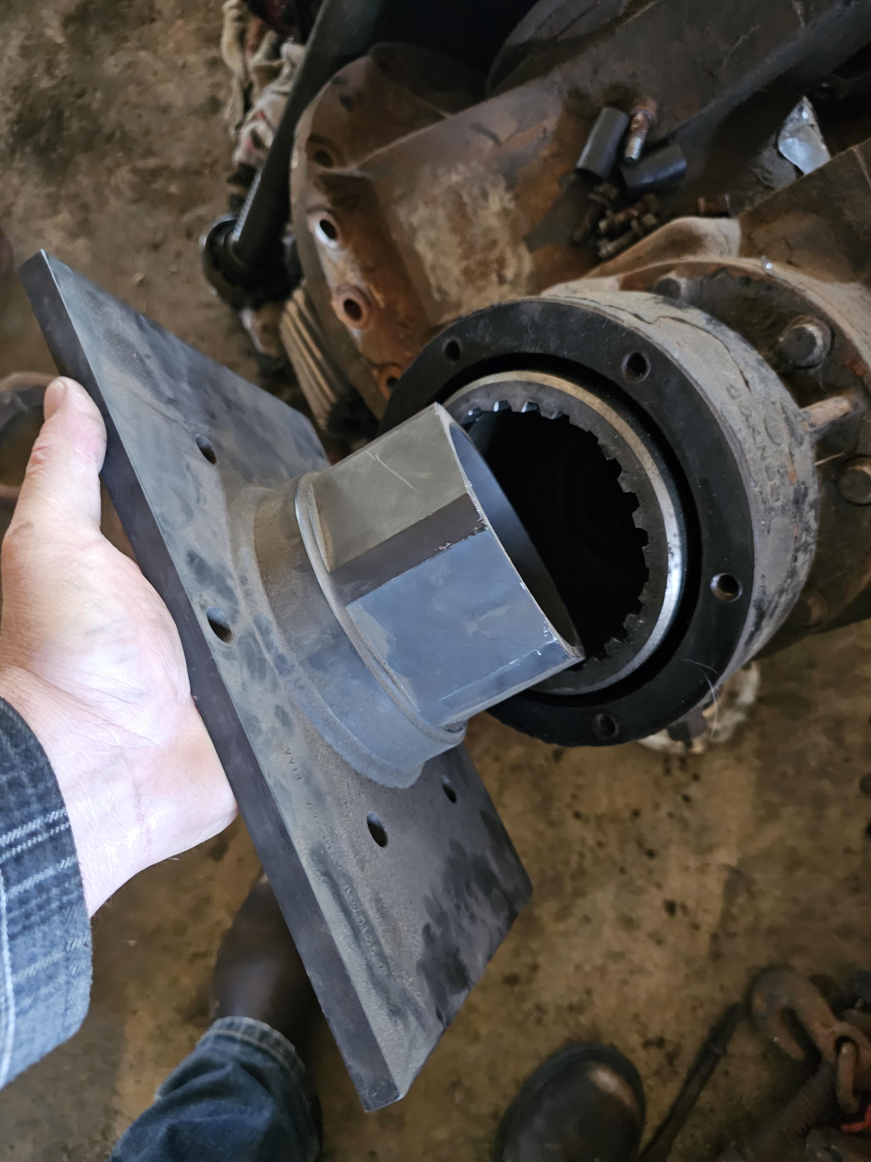

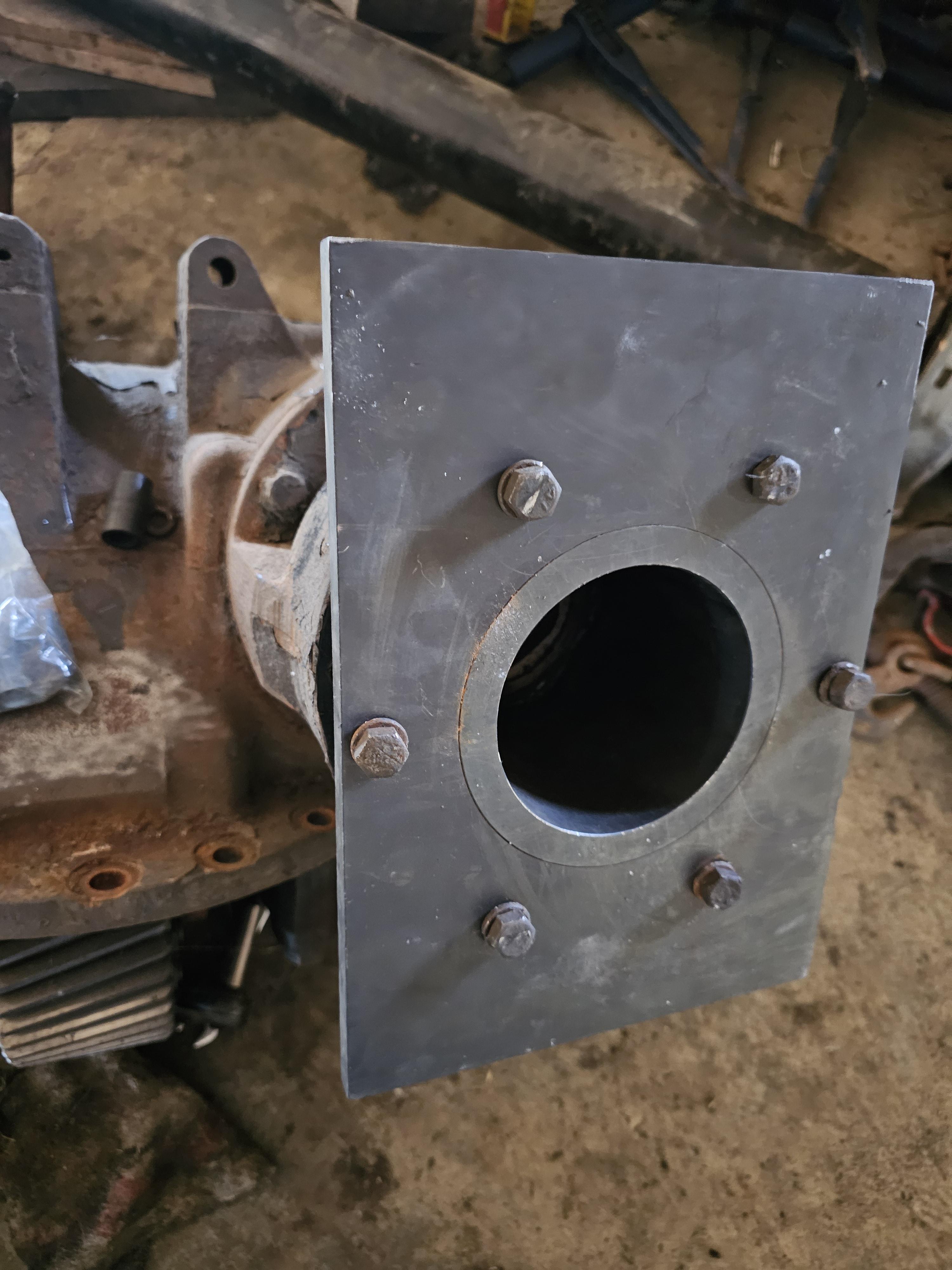

https://photos.app.goo.gl/APC18ZVxfMgy7pMc7
Here are 2 of the essential must have tools,  for Mack rears.  Of course, I have never built them without these tools... Let me know if the link works..  Jojo
