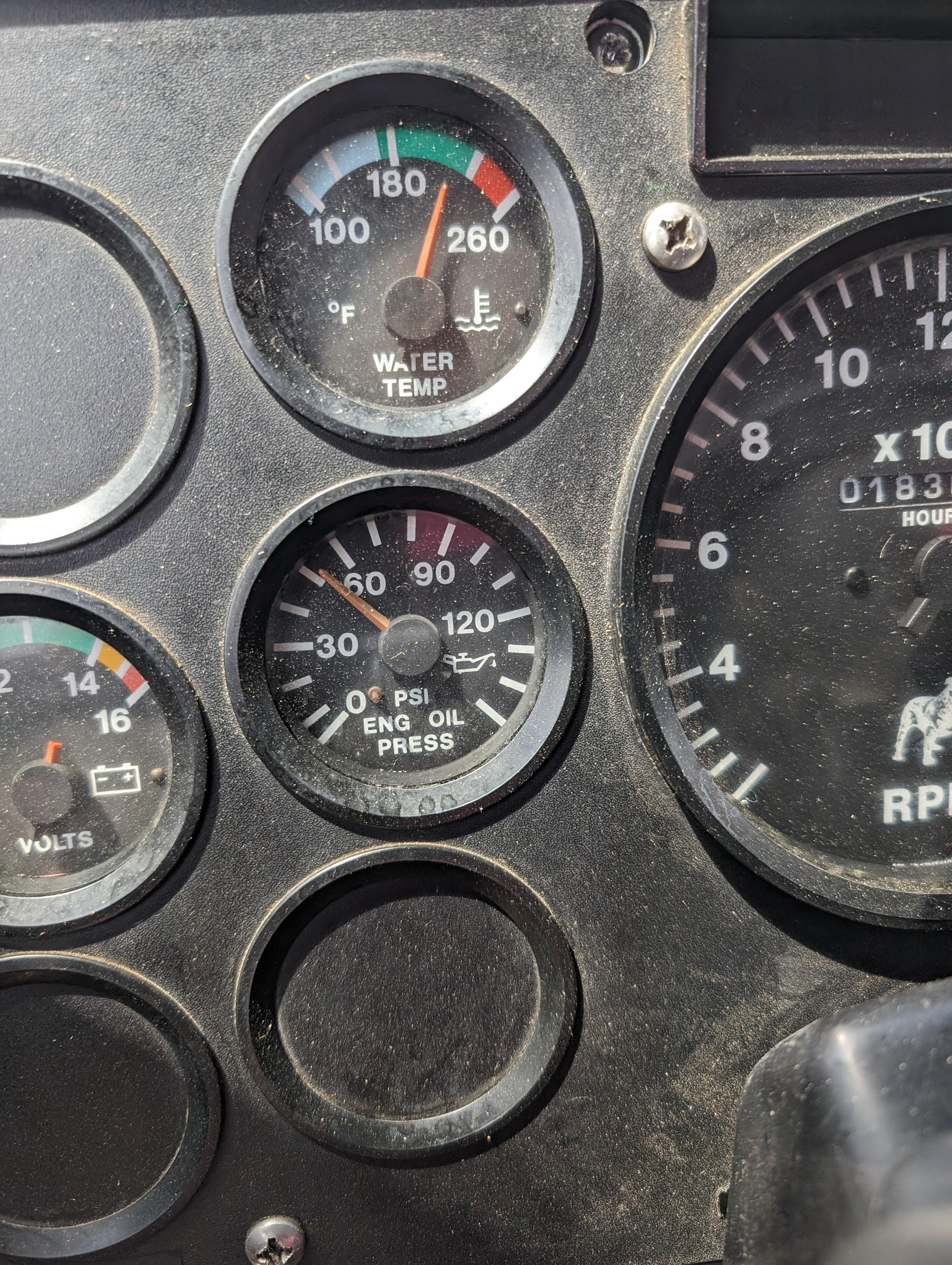

I have a '93 ch613 with the 350 E7. I bought this truck September of last year and it has run great, now that we are getting into the warmer time of year I am noticing the temperature gauge moving up from 180 when pulling a full load. My question is, is it safe to operate as long as it stays within the green range? I have noticed the clutch fan stays running all the time, as soon as I start the truck even when cold the fan is always spinning . I changed the coolant back in April, the old coolant did not appear to be dirty but I was replacing the air compressor so it seemed like a good time to do a full coolant change. I'm including a picture of what my gauge looks like when the temperature gets above 180, sometimes it will go almost to the red but I have never seen it go into the red. Thanks for any help you all can givePXL_20240606_182304313.thumb.jpg.2dfea86354f0ce770c7cbdd17dd32d14.jpg

Wow, a lot to take in here! Thanks everyone for the responses! My truck does not have a Pyro so I can't see how hot the turbo is. I have checked for boost leaks and have not found any. I would say it pulls very strong for being such a small motor so I would guess not a boost leak issue? I will try pulling the CAC off, doing a thorough cleaning, and the thermostat, and go from there. In regards the the gauges accuracy I will try to check that as well. Part of me thinks if it's in the green don't worry about it, but at the same time that green range is pretty wide and it makes me nervous
the green range is RIGHT !!..  just do the basics for P.M. reasons..  Its a CH..  put a tall stand under the bulldog with the hood ope, release the 2 spring loaded helpers, and they hood lock, if it is still there,  that will give you some extra room.  1 bolt on the bottom of each corner of the CAC, and 1 bolt on each side. then the boots, just lean it back, and wash it all out.. no need to remove it..   unless you have another plan for it..  be aware of the white nylon washers, you need to put them back in. if they are gone you can use rubber to make new ones or some other sheet of nylon stock, they do sell the CAC mount kit as well..
