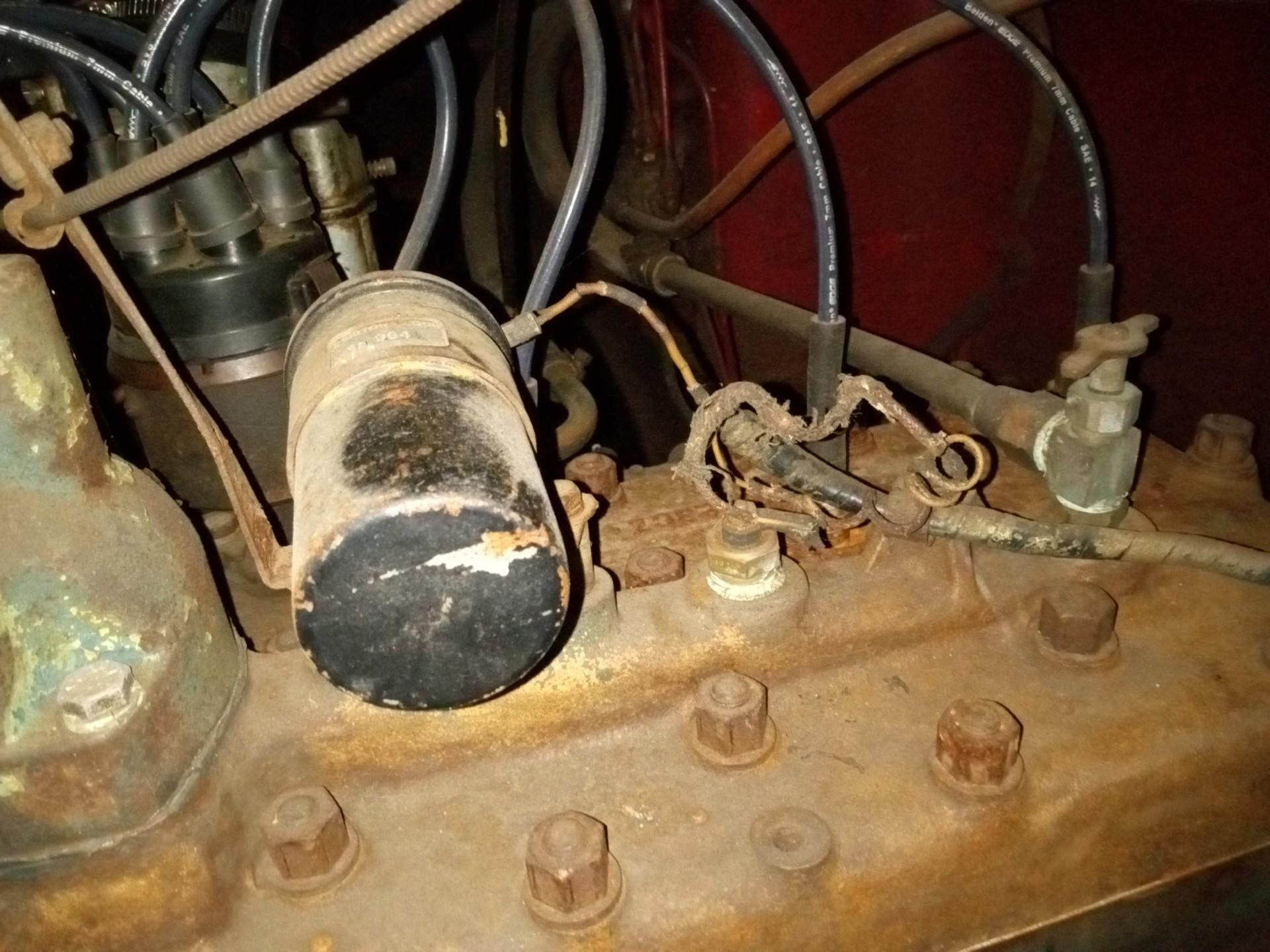

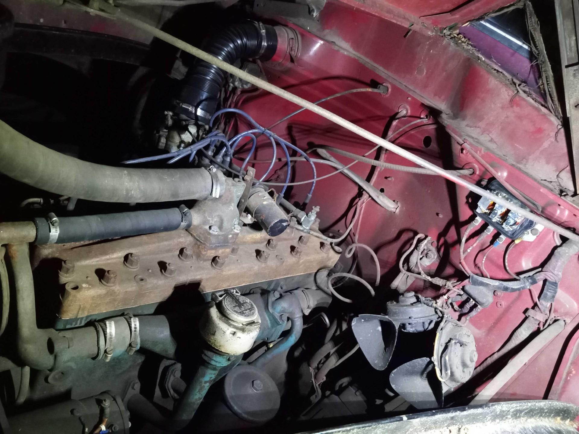

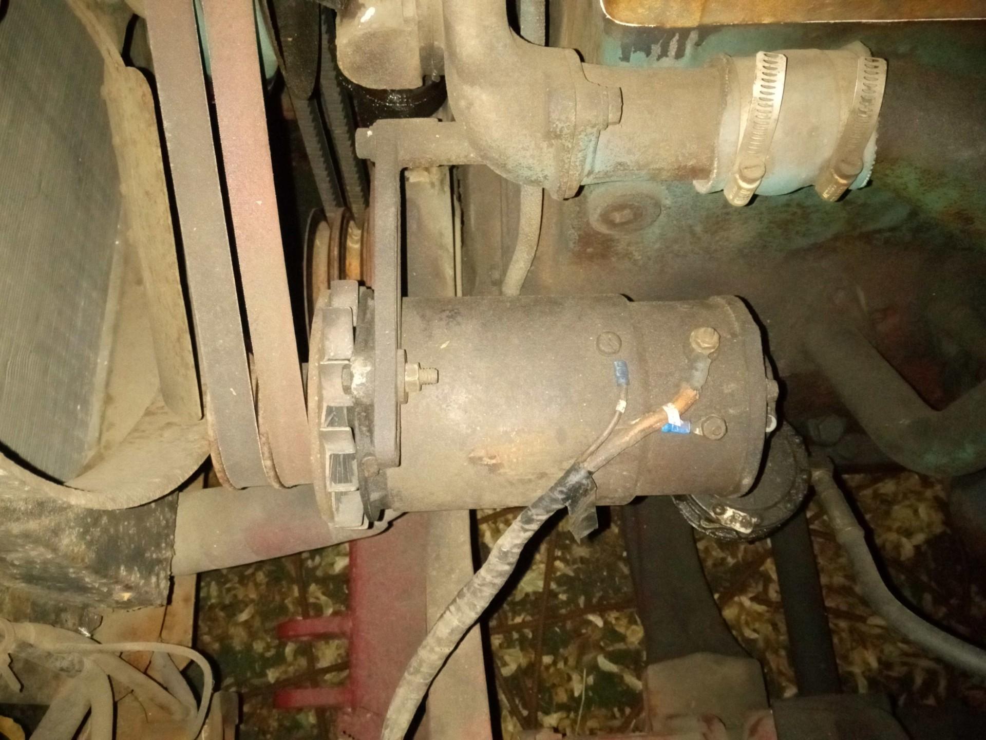

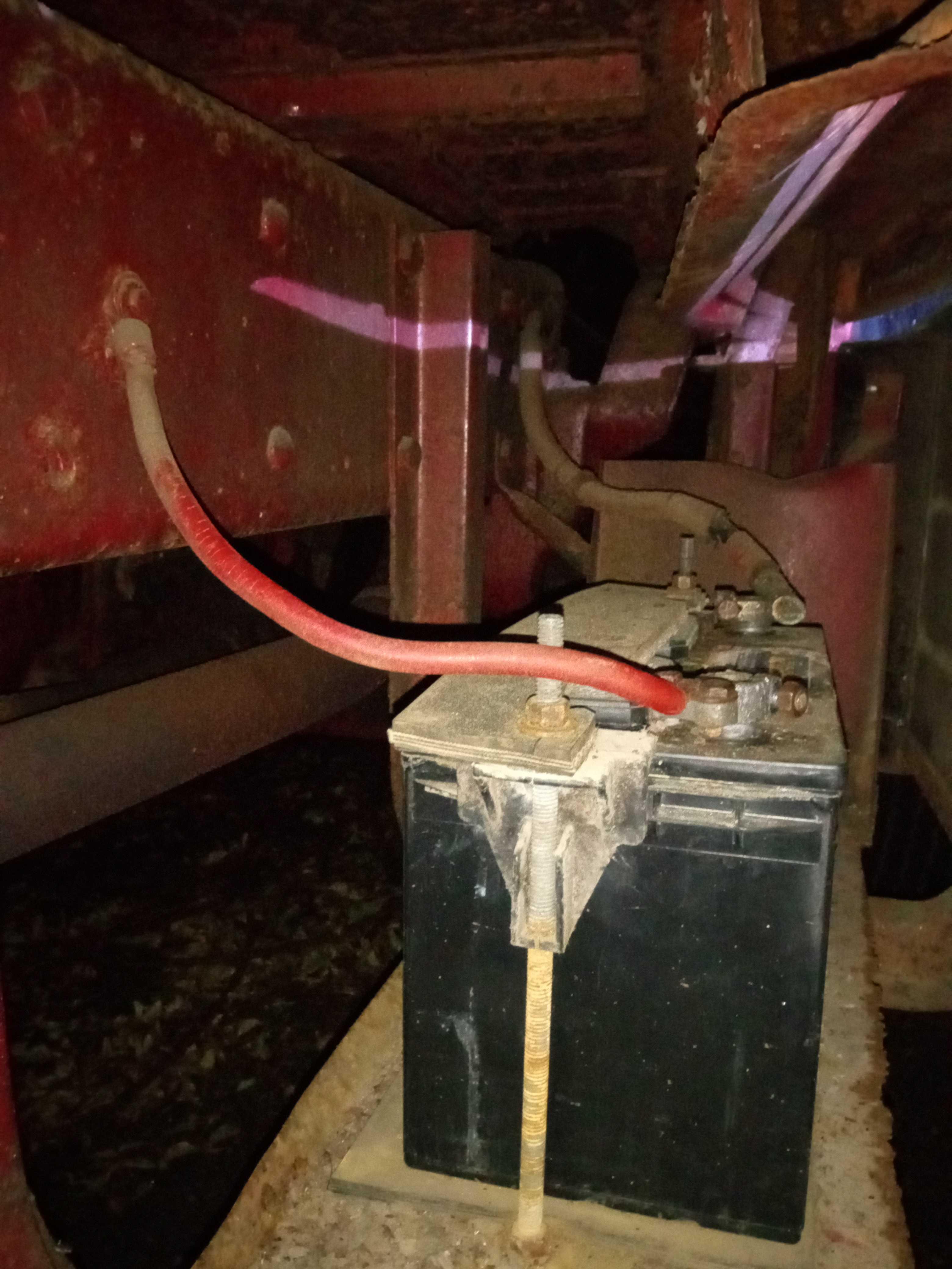

I have a B42 that won't start without a jump.  This started about two months ago. Once started,  I'm reading about 12.5 volts on battery, which is only two years old.  I did remove the negative cable from the battery and she kept running (this truck is positive ground).  I got this truck about five years ago and have not rebuilt anything electrical.  The brake lights stopped working about a year ago, but that's another story.  Maybe it's not - the wiring is not too good.  You can see from the picture that the coil wire looks to be in bad shape.

Check your ground connections on the truck
Most vehicles have more than one
Unbolt, clean back to bare metal, bolt back on
The generating system is working or the truck would stop when you disconnect the battery
12.5 volts would hardly charge a 12 volt battery

I see the battery ground side goes to the frame, this is a common problem and a cheap way out that many mfg used. Run the ground to the highest amp draw item on the truck (starter motor) and ground the frame from there. If the starter is grounded through the case than run the ground to the mounting bolt. If the starter has a ground stud, run the ground there.
 It cost a bit more in wire, but eliminates many problems. Often there is a braided strap that grounds the engine to the frame, and it degrades over time and doesn't allow the current through.  Frame and body need to be bonded to the engine with ground straps.

got that one covered 100%. changed many of  the braided ground straps .

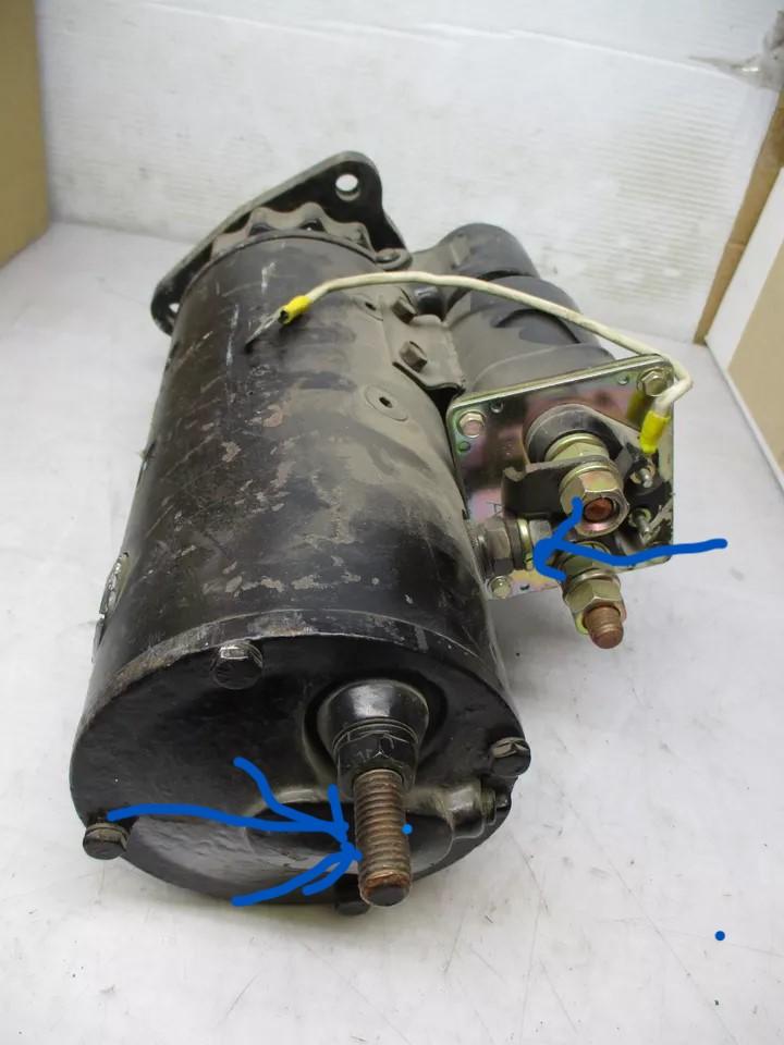

Without jump starting it just makes a noise like it is trying to crank, but then dies.  Regarding the grounding to the starter, do you mean to run the battery ground to the same ground terminal that the starter uses?  I'll check for the frame - body - engine grounding straps.
https://www.bigmacktrucks.com/topic/74308-b42x-wont-start/#findComment-554483
No, if the starter only has one copper bolt coming out of the motor, then the starter motor is internally grounded to the case. For those, run your ground cable from the battery to one of the mounting bolts of the starter motor to the bell housing. If that is too difficult you can run to the transmission case.
 Many more modern starters have a 2nd copper bolt (stud) sticking out the back of the starter that needs a ground connected. (IE Delco MT 40's etc)

also keep in mind; the braided ground strap is a duel purpose item. not only for ground but also it is made of the braided material to act as a weak link in system should a problem arise. it will melt in half intentionally when major short  happens.

Ahh, not so much, no way to fuse something like a starter motor.  It is very close to a dead short with the rotor not turning.  The battery would have to be capable of supplying far more current than a starter motor could draw with a locked rotor.  Any resistance in the braided cable goes to reducing the power from the battery to the starter, not a good thing. It is braided to make it as flexible as possible. In rush current can exceed 1000 amps on a medium starter and over 2000 on a big one.
 Starters are a short term load, so if they heat the cable a little, it can survive, no way those cables are going to survive a continuous load of 300 or more amps, so how do you fuse something that can take 8x-10x the current? You don't!
 Running battery cable to the engine just means running more copper, after all the "hot" side is already run direct to the starter solenoid, so if it can handle the engine moving around the ground side can also.

Thank you all for your suggestions.  I appreciate the benefit of your combined knowledge.  Yesterday and today, I cleaned and tightened:  battery terminals, starter ground and braided ground to frame, put new commutator cover on starter, cleaned terminals on generator, tightened belts on generator.  It is still reading between 12.5 and 13.0 volts at the battery, and 12.5 volts at the generator.  The biggest change is that it does not need to be jump started.  Starts immediately again after running, after going to dinner last night, and again this afternoon.  That's great.  But still at 12.5 - 13.0 volts.  Two questions:  what about getting generator rebuilt? (I would also change twin belts) and Thursday I would like to take her to the parade, about three miles from my house, 1 hour waiting, 1 hour parade, three miles back?

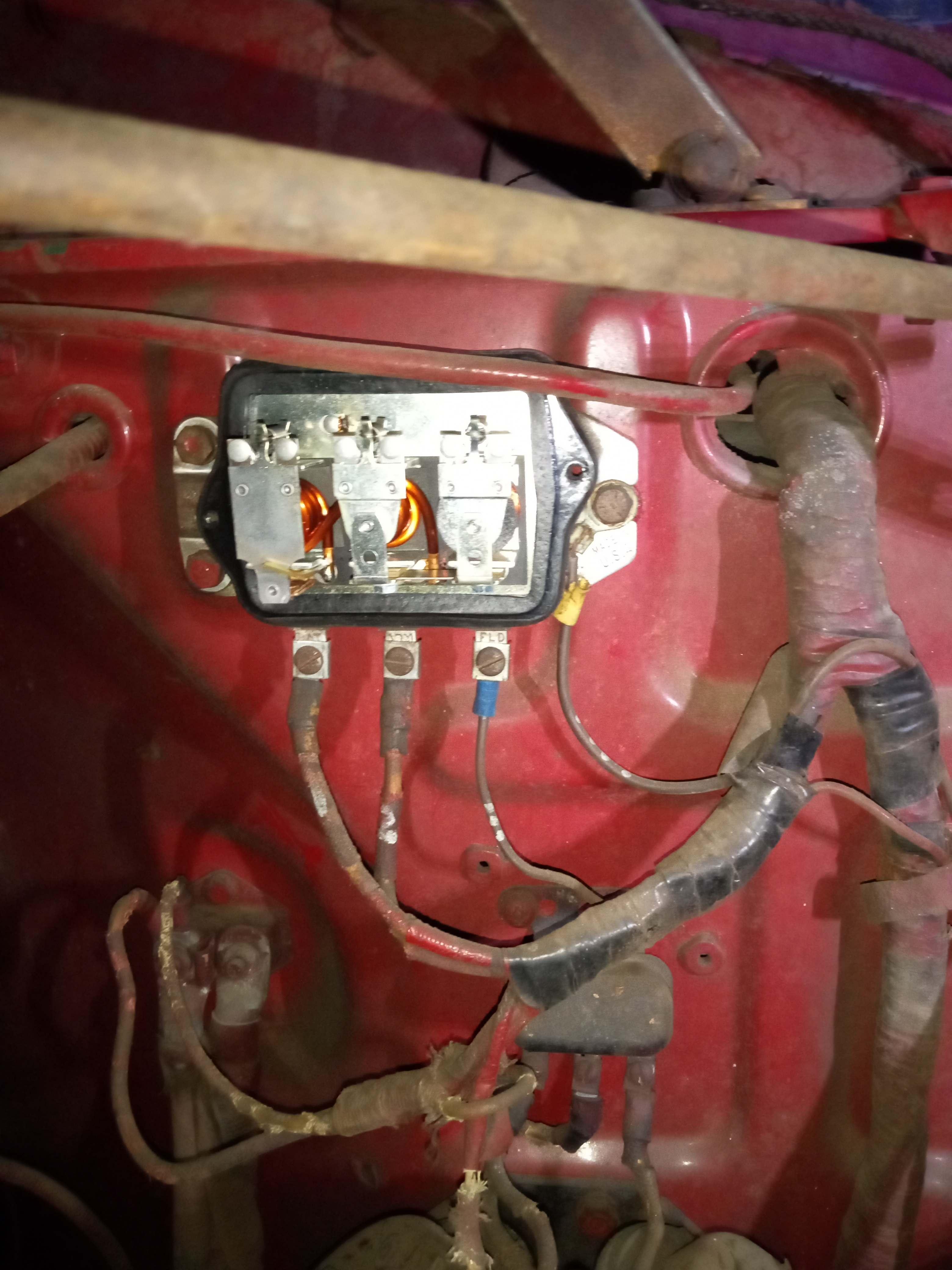

If you have voltage at the generator with the engine running, (shouldn't be any when the engine isn't running) then the generator doesn't likely need to be rebuilt.
I see the cover is off your regulator, has someone tried to adjust it? They are adjustable but it isn't easy to, it involves setting the current as well as the voltage, each takes a separate procedure.
wouldn't be a bad idea to put some oil in the oil cups on the generator and starter.
 Generators will not produce much if at all at idle, so you need to run the engine 1500-1800 when checking the voltage, same for current. Regulator needs to be grounded, as it is mounted in rubber grommets, it does look like there is a ground wire on it, where it goes isn't clear.
 Generators are very well made, and if not abused, will still work fine after 80 year or more. I have two that old that still work fine.
 If the generator works when the engine speed is raised, then no problem taking to the parade, if it doesn't and you have a buddy with some jumper cables that can give you a charge if needed, that would work also.

Thanks for your reply.  I took the cover off the regulator to check it, but that procedure looks too ambitious for me, so I'll button it up.  I'll make sure the oil cups on generator and starter get some oil.  I have a jump box and will keep some jumper cables handy, my brother will be there with his 79 LaFrance so that should be all right.  I'll run the engine up to 1500-1800 tomorrow but I think I should be all right.  Thanks again.

Remember not too much oil in the generator/starter cups! I use 3-in-One Oil in my stuff with generators and only lubricate them annually.
As stated there isn't much to go wrong with these generators. I think I've posted this video here before but it explains the generator/regulator better than anything I've seen:

I did clean the contacts and terminals and checked all were tight, but still have 12.5 volts at the battery.
