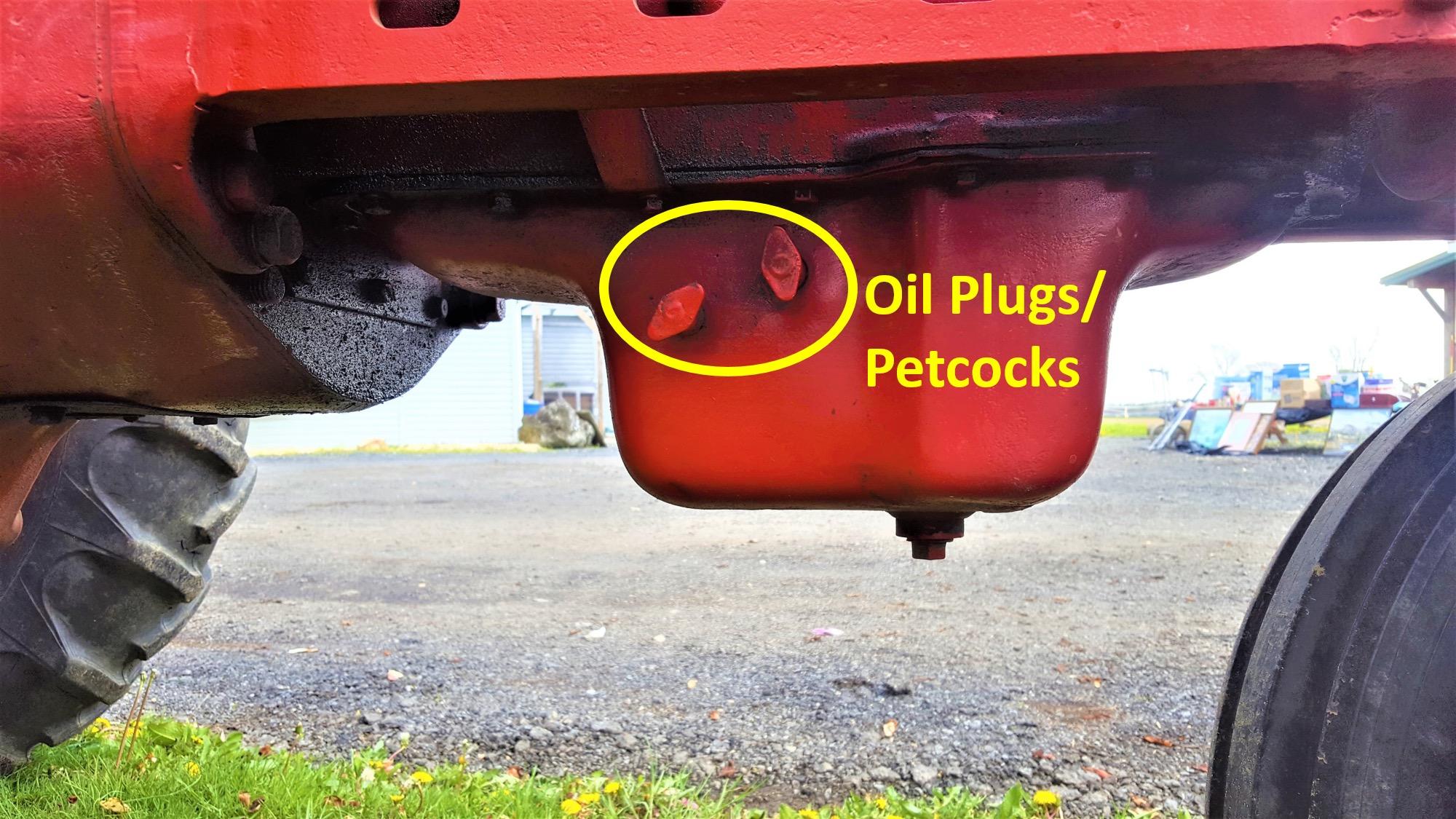

I swear dealers and shops are behind this and want to make it as hard as possible to change oil. I changed the oil in my Corolla yesterday and it has previously been to a shop, the filter and the plug were horribly tight! I get someone over tightening a plug, but why a filter?!
Anyways I still prefer the petcock style lol
