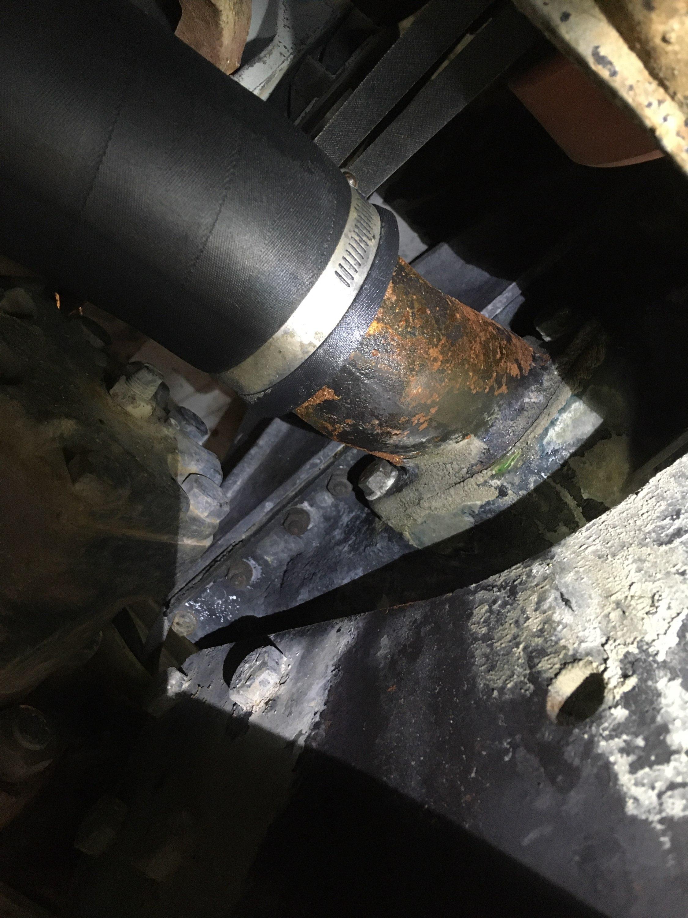

Nice feeling when you get something like that accomplished… a big step now you don’t have to worry about any of them and if you ever have radiator issues just about all the cores are available… bob
That's good to know that the cores are available. When looking up from the bottom side I could see some green corrosion toward the tope of the core just under the water tank. I guess it will be the first to let me know when it gives up.

Yeah, plus I don’t see them sitting around very long. I’m sure there’s other guys that will be buying them and as far as the radiator or yes, mine looks about the same shape. There is green and a bunch of spots.

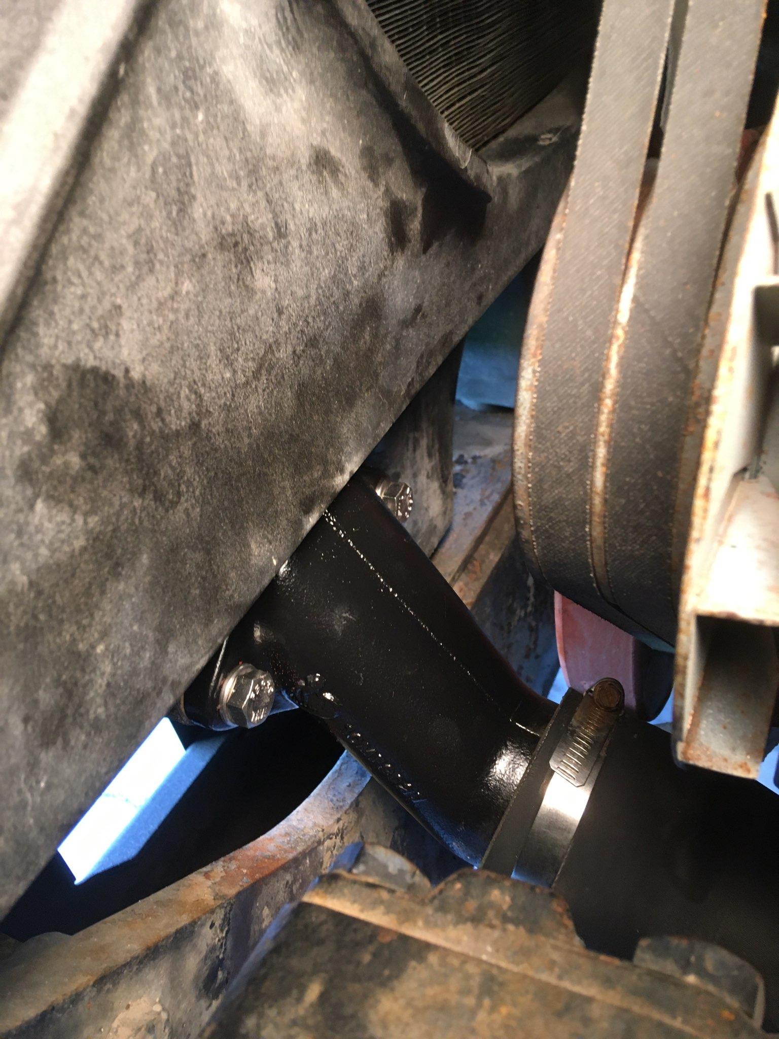

9 hours ago, seyser said:

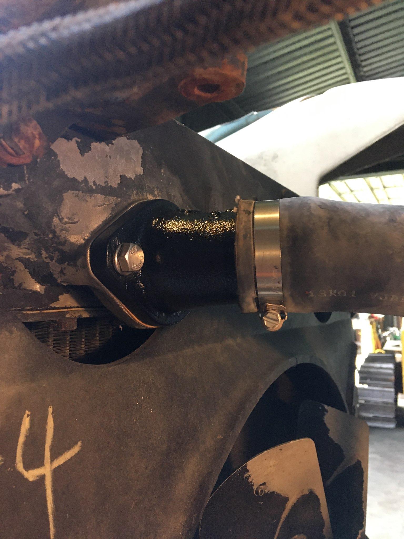

Worked on the Mack this weekend. The coolant flanges on the radiator were leaking so I removed them along with the other 2 block off plates. I blasted and painted the pieces, added new gaskets and stainless hardware. I was a little disappointed with my local Mack dealer as I had to order 10 of the top smaller gaskets when I only needed 2. Apparently they are against having stock of these, Oh well.
I replaced the coolant filter and that was quite a chore to removed but I finally got it. Filled with new coolant and it should be in good shape for the next many years.
Could have made your own with some gasket material 😁 terry:MackLogo:

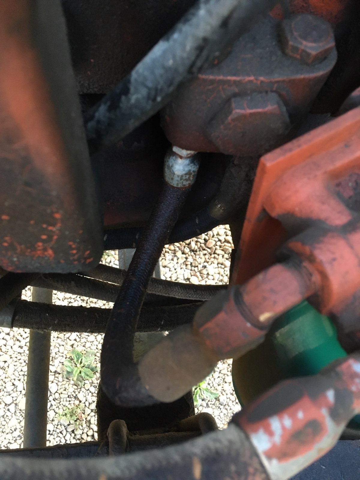

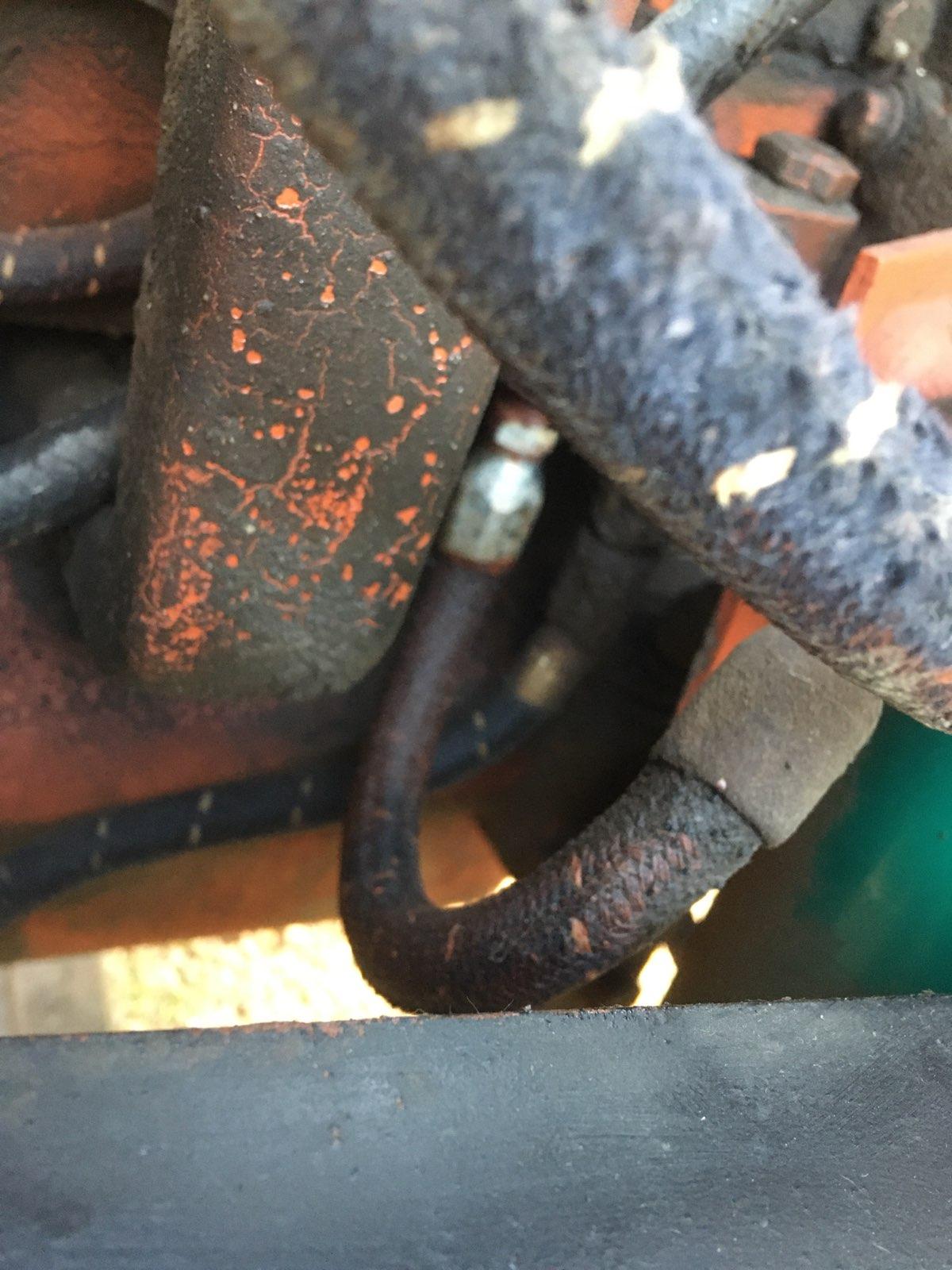

My fuel line from the lift pump to the filter is leaking. Is this something still available from the dealer or do people just have them made? Would these be considered AN fittings? Iv browsed the net a bit and see kits to make these style. Are these ends crimped or just pushed on?
They are reusable fittings,just get the right size hose,you will also need a couple fittings to take them apart,or just get one made up,much easier..
