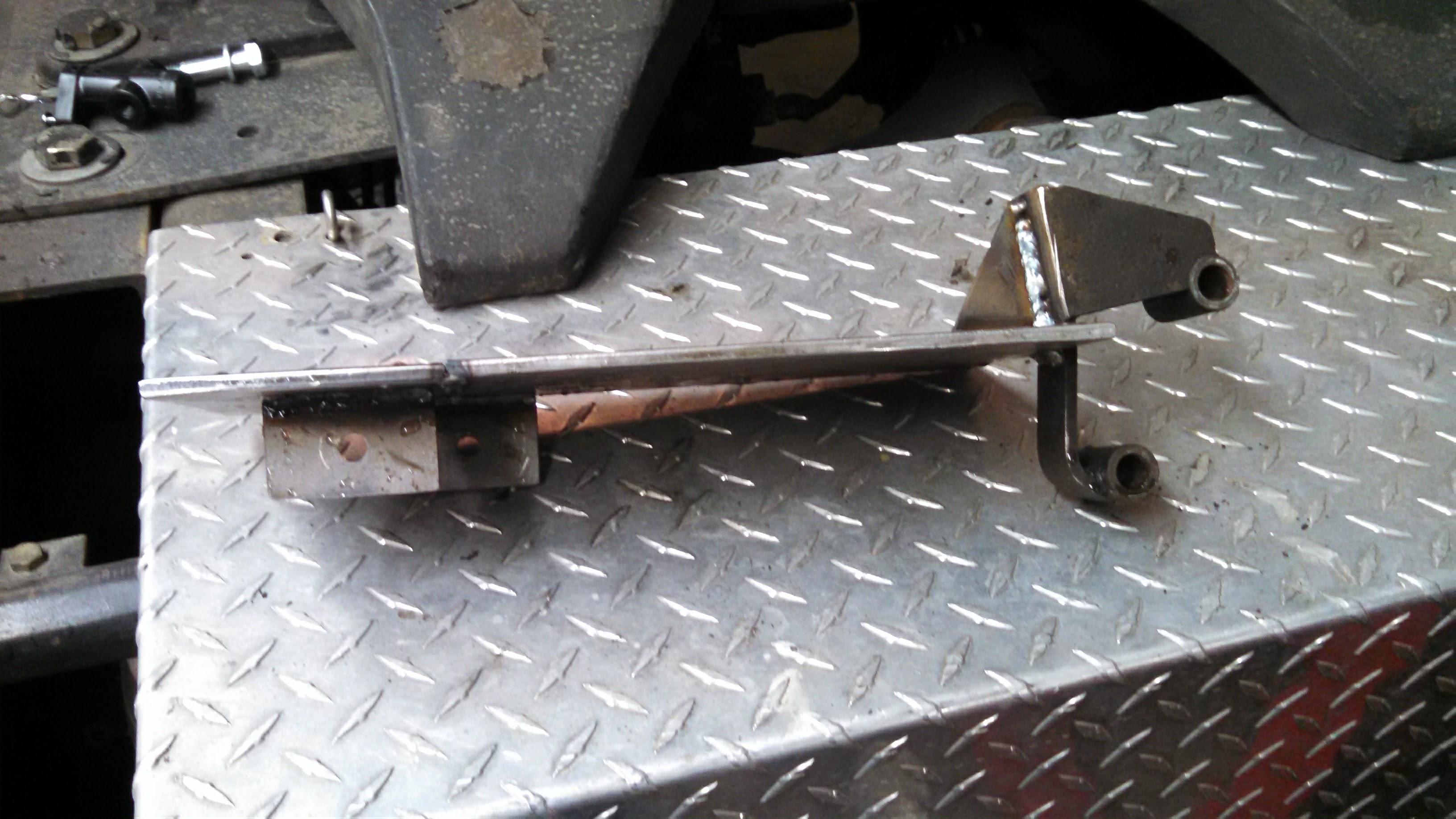

I know what you speak of.  I used that mounting for my AC compressor.  I moved the filter to a bracket I made on the frame.

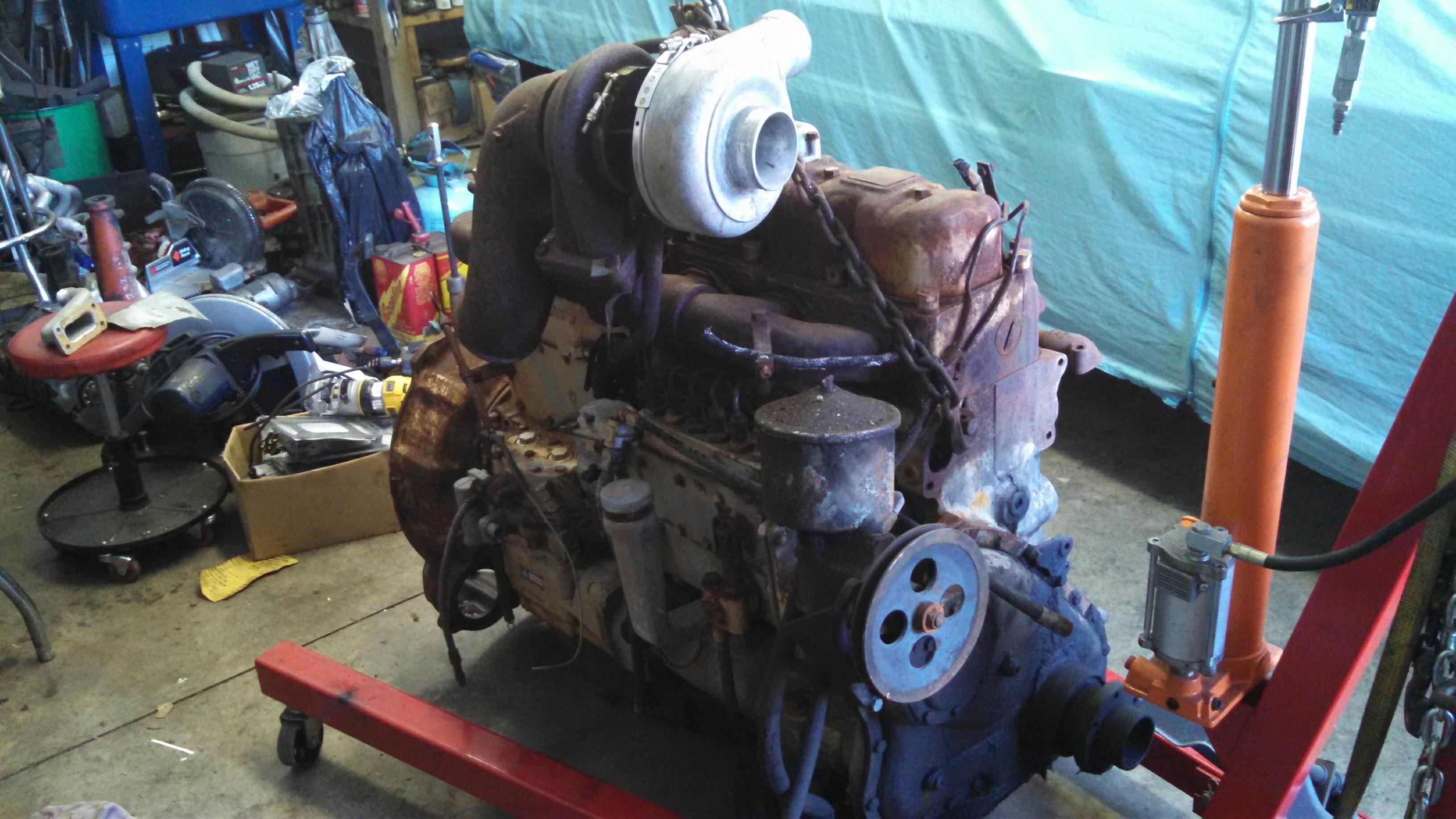

My 237 was missing all that stuff and had to reuse off my 673.  Bolts to front of block at water passage(where chain is attached in picture)and ties into oil cooler(or bypass hose like mine since the 673 didn't have a cooler).
