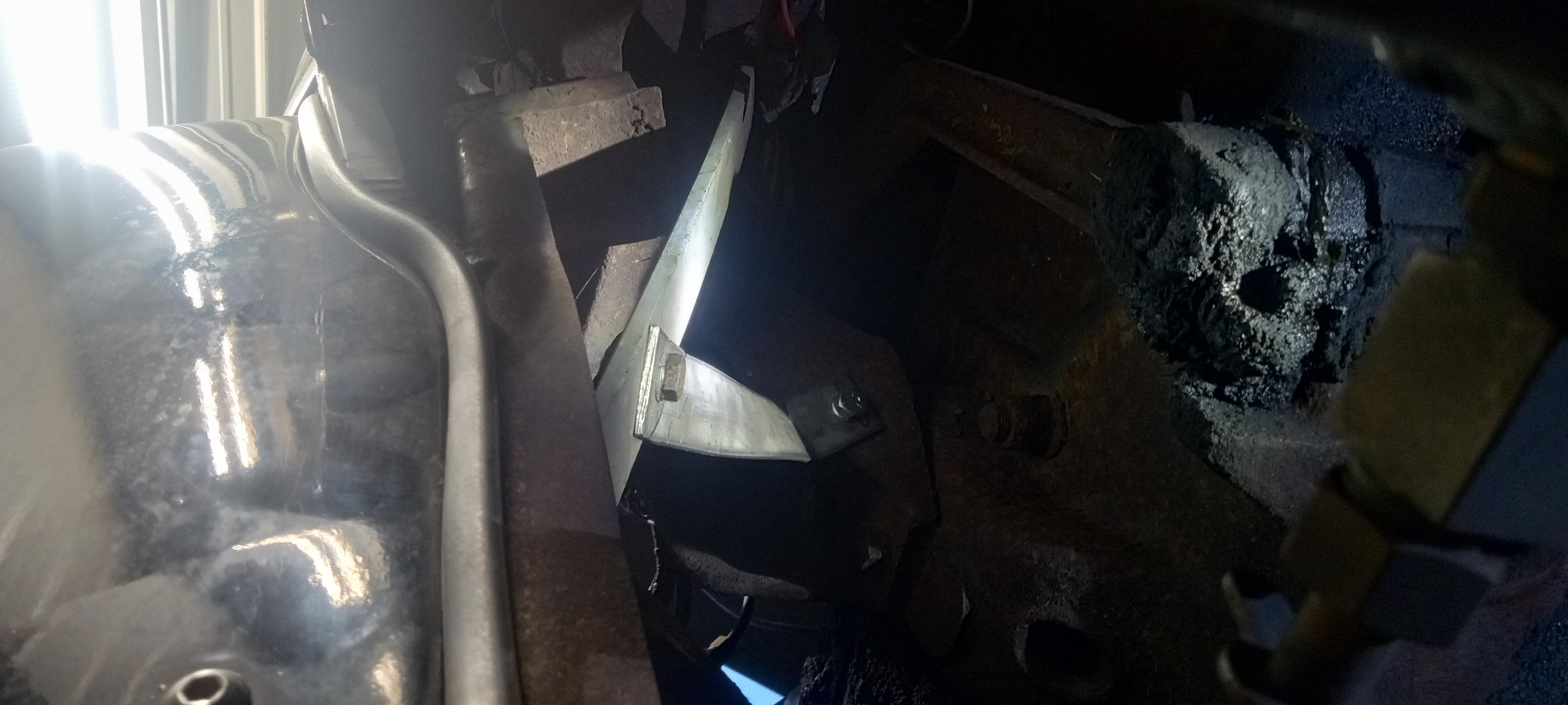

I realized my left front fender is wagging a bit at the bottom.  The original cab corner down low is rusty/weak/gone.  20 yrs ago I ran a piece of 1/4" strap from that lower area up to the floorboard area by the brake valve.  I welded a piece on the inside of the cab and bolted everything together.  It made it all tight.  Now, all these years later it has cracked the rocker panel seam behind the fender and is now moving around again.  In so it now wiggles the floor board enough to wiggle the throttle as you cruise along, causing the choppy sound.  Doh.  I realized it after getting out of the truck Sunday night after getting home from the races this past weekend.  I saw the crack in the rocker panel and I grabbed the fender and it all made sense.  I need to weld that seam and look at rebuilding that area again.

Did a little fabricating last night.  Made another bracket to tie the existing one into the cab mount bracket.  It should support enough to keep everything tight for now.  Looks like a winter project to get the fenders off and do some repair?  I know the front cab bushings are worn and the cab bolts are actually loose.

I have pictures showing the whole floor cut out in 2002.  It is solid now, but the under structure that ties into the fenders and rocker panels is gone and not much to weld to.  Thus I built this first brace.  The passenger side is still okay.  Everyone wonders why I want a new cab, yup, this is why.  Or take this one off and totally rebuild the underside after sandblasting it.
