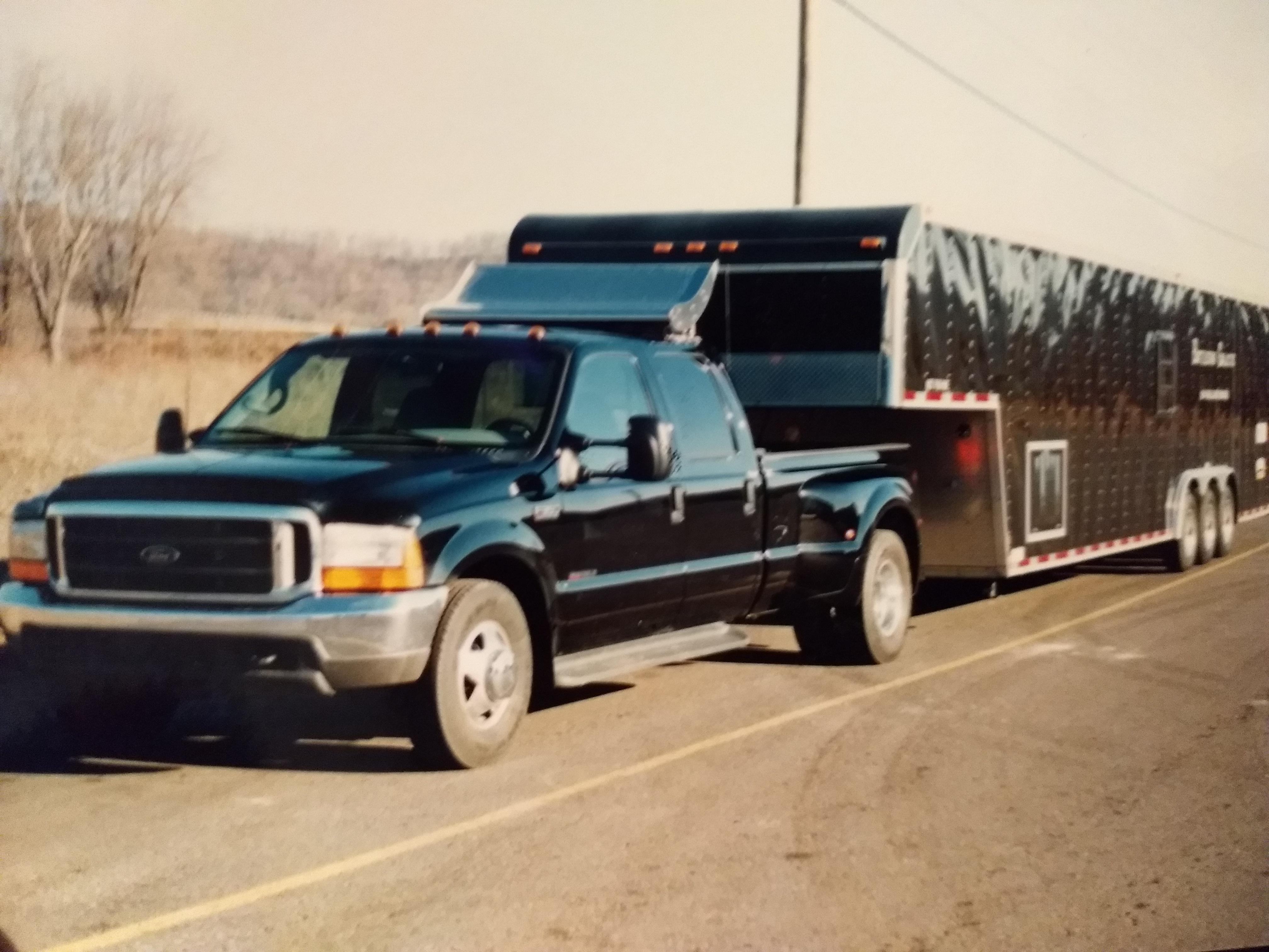

Picture from Jan 01, there were 4 of us going to West Palm Beach to race.  Luckily it was no snow around.  We did get blasted in Bristol and truck was a mess after that.
I was in high cotton back then!  New truck, new trailer.  All shiny and black!
Larry
