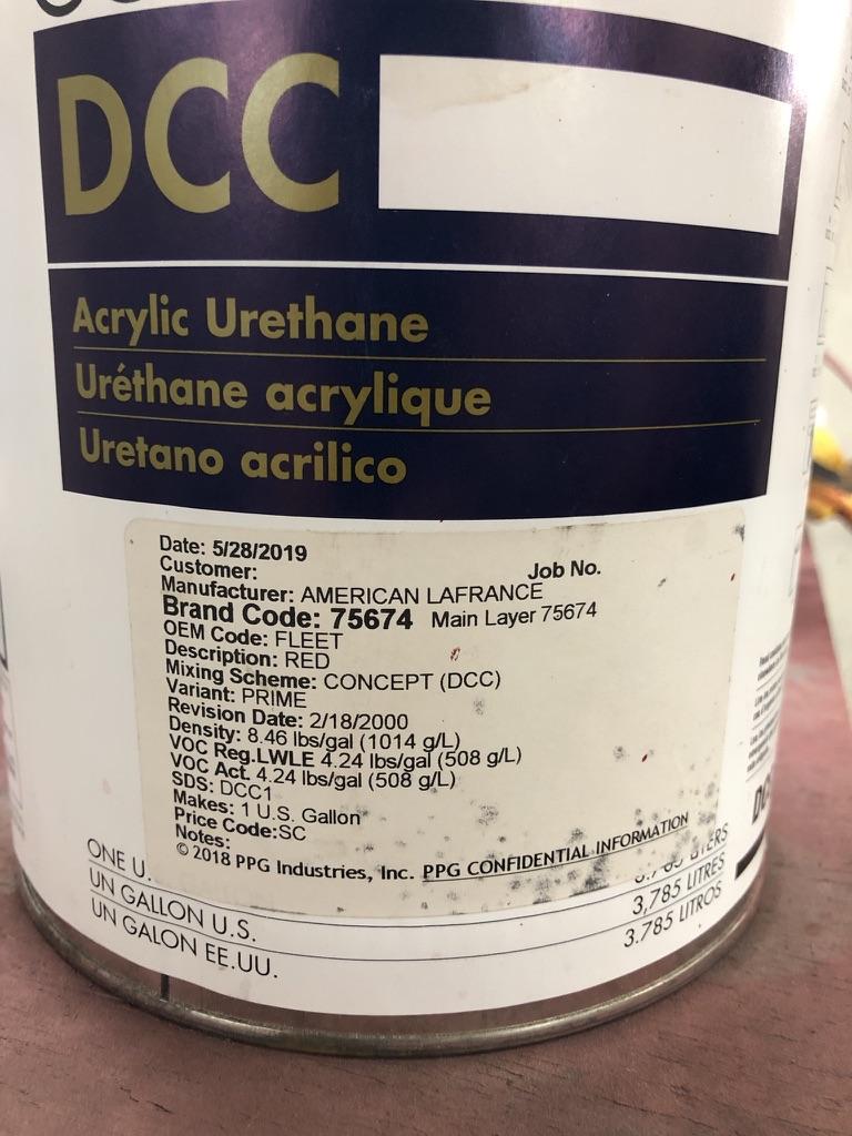

This is the paint code for Mack "Fleet Red", it crosses to American LaFrance Red. I got this from Matt Pfahl and it's what he uses. It's PPG Concept, which is no longer available I'm told. The paint code is still good and would cross to other manufacturers.
https://www.bigmacktrucks.com/topic/74349-1964-mack-red-paint/#findComment-555396

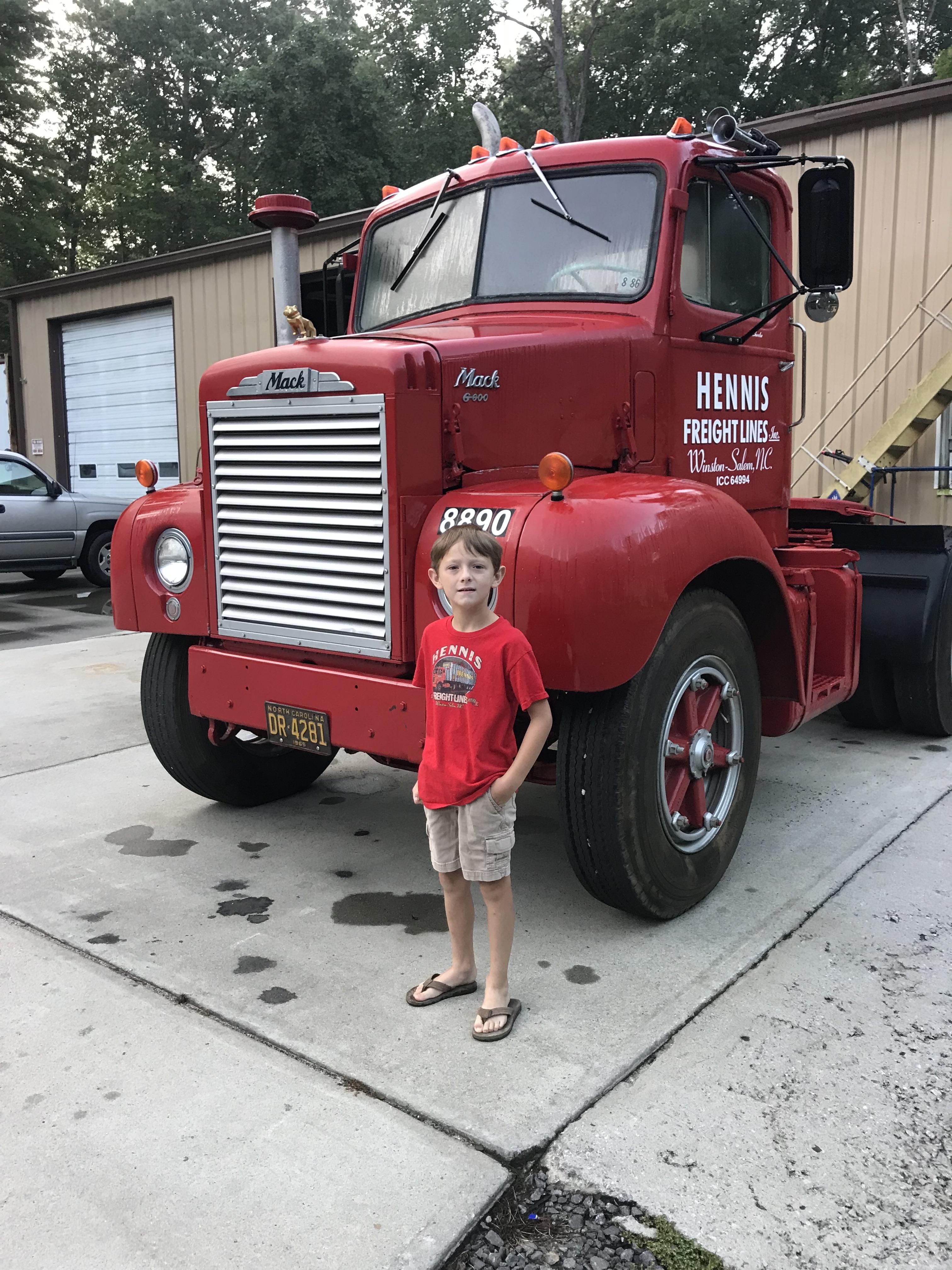

 “ Fleet “ Red is what Hennis Freight used, Like Matt’s picture, Basically American Lafrance  Red . That’s what I painted my 1965 Hennis C Model with,, any DuPont store can mix it either in Nason or Imron ,, depending on how much you want to spend.
https://www.bigmacktrucks.com/topic/74349-1964-mack-red-paint/#findComment-555407
