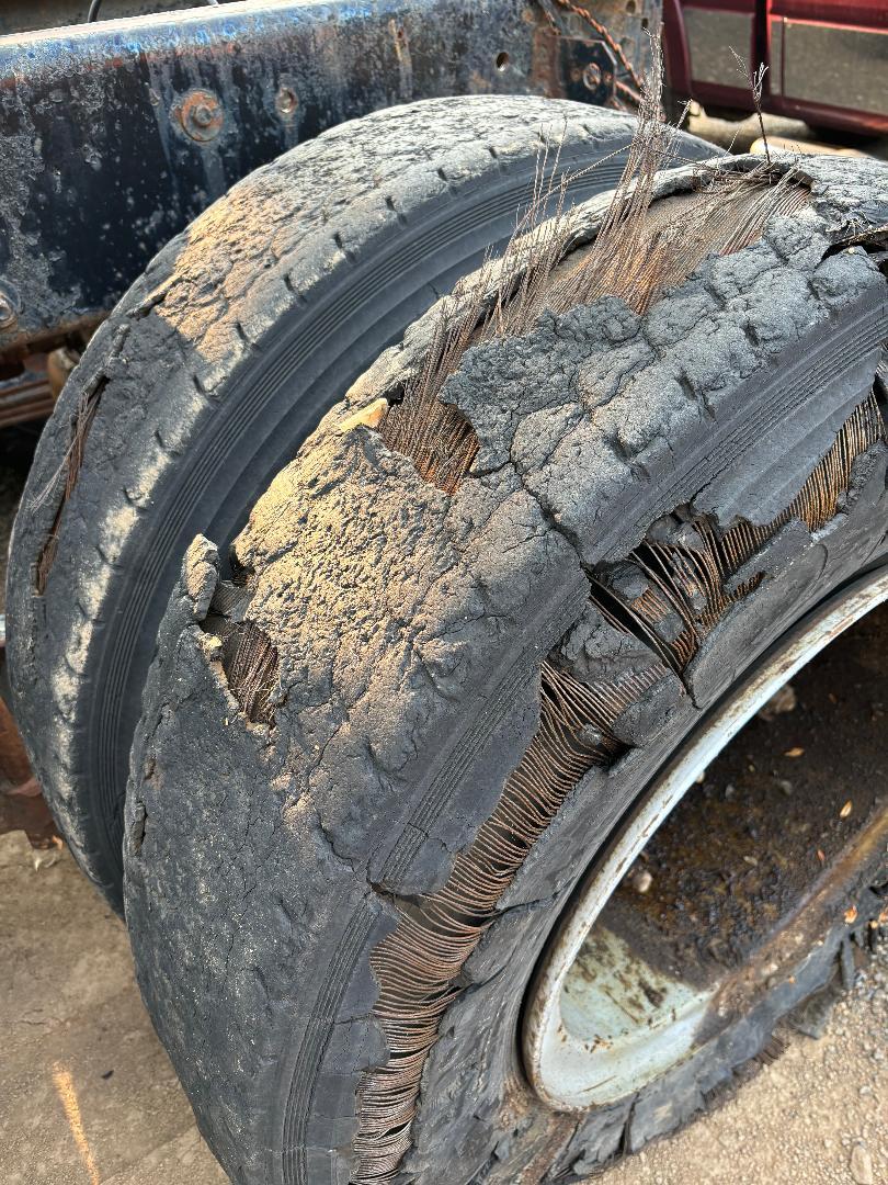

When I bought my F model from Tom Smith he replaced the front tires before we took It home. He wanted me to replace the rears, but I declined. They looked great even if they were old. Well two of them blew sitting in the garage.  Now it has new rear tires. Mike.

That’s pretty much why I’m fixing to change all of them real soon

Also haven’t considered tires blowing out just sitting there on account of age…. I’ll be looking into replacements real soon
Them cords have a few miles left in them.....😲
I put new drives on my truck this spring.  They were dated 2001.  Still looked brand new, but I knew I was rolling the dice every time I took it out.

Some of the old tractor tires get that way due to the liquid calcium they add for extra weight, but never seen it happen to a truck tire. I've seen stuff parked outside since the 40s have better looking tires than that!

Sun (UV) and heat will age rubber badly.
With a truck sitting in the sun with the tire exposed almost all the way around, the heat will build pressure in the tire during the day and lose it at night. The cycling every day up and down will age a tire sitting out for 20 years.  You can see the rubber is "crumbling" just from sitting.

Well, I checked the tires down at our local hillbilly shop and they said they only do cars and light duty trucks.he did recommend a couple of shops down town .: ok thanked him for his time I’ll start looking on line out of  curiosity.. bob
