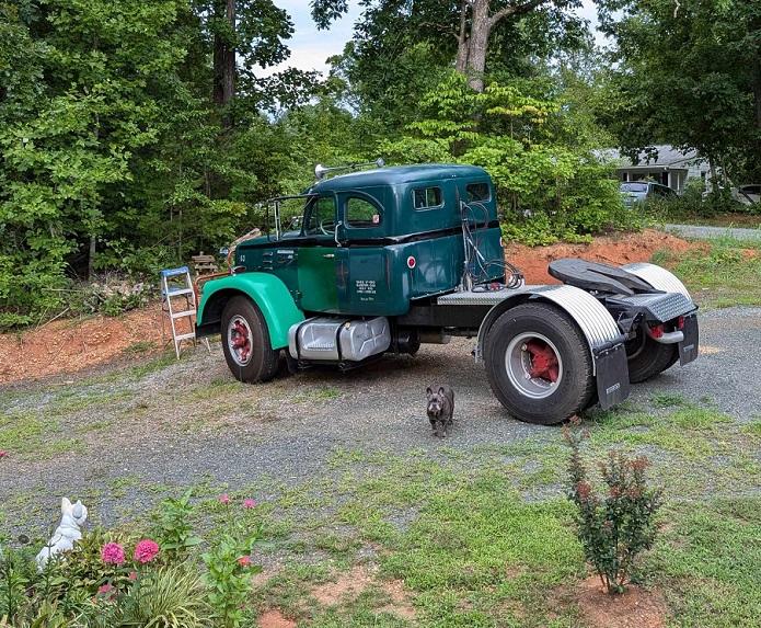

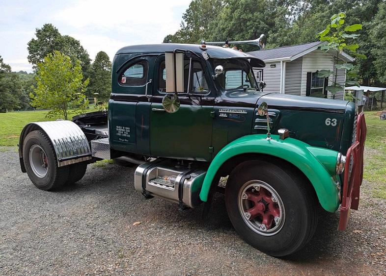

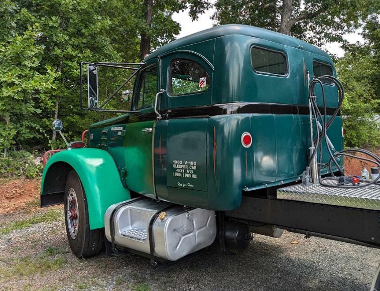

Meanwhile, back at the ol' computer-
This is as it sits right now, I took these pictures just a few minutes ago. It's still a work in progress, maybe just some more polishing and i'll be satisfied. I ordered more of the ceramic polish, definitely need to do the hood and the top of the cab. Might get some lettering and pinstriping done too, I don't know.
I like the way she looks! (and the same comment to the 1st lot of pictures:))
It would be cool to add a few small items to the cab or even rear portion of the chassis painted that same light color as fenders are. New door lettering of that color or multiple colors with that green as the main one would suite the scene perfectly too on my mind.
