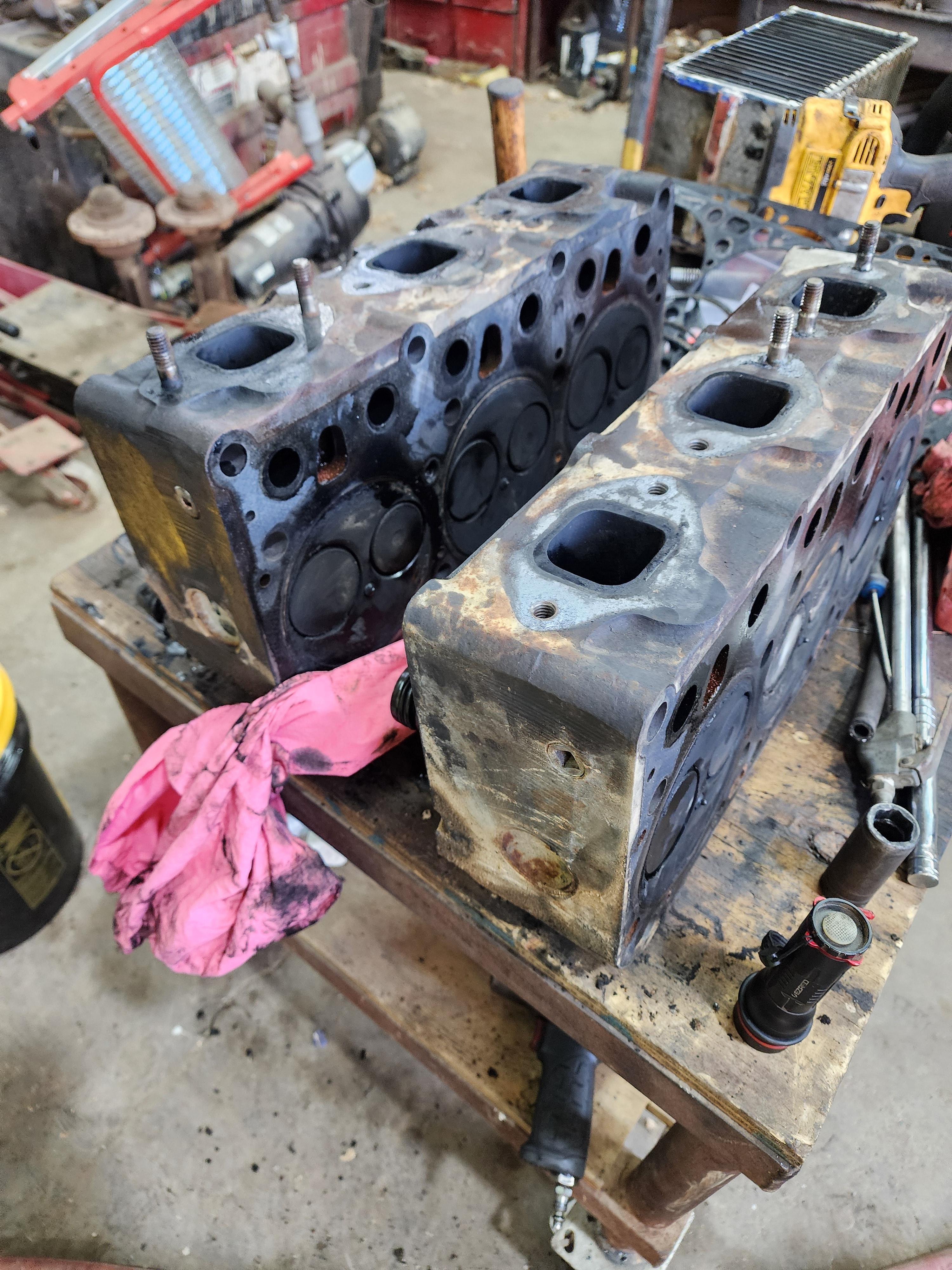

No not sure they are bad but have never seen a set that wasn't cracked.  I was wanting to get it back together in less than a week...as I have alot of work for it in places my other trucks can't get to. I will know soon enough I type this as I set on the steer tire...should have the heads off in a few more hrs.
There will be plenty of cracks in the heads, they will be all over the place
Especially around the injectors
Most times this isn't a issue at all, have them checked to see if they are leaking thru the cracks
If all is okay then just have them done up
Paul
So far they look alright. #2 was getting water in it and communicated with 3 looks like. Thanks for the responses....now to find a machine shop that can get it done in a reasonable amount of time and get my rebuild kit ordered.

Just wanted to mention that a member just did a head gasket re/re a month back here! My self I would just clean er up and take a chance! It’s old! The fire ring groves can be an issue if the shop ain’t set up for it! As mentioned!

I didn't even notice the fire ring grooves if there was any.... but I have been around that on high boosted pickups and trucks. But nothing stuck out on the heads I will have to look at that.
I haven't got the injectors out yet....was going to fight that battle in the am. The rockers looked good but had a bad push rod...the bottom ball fell out. I fished it out tho. I plan on pulling the injection pump as I had some leaks and send it and injectors out. It also needs a compressor as it slobbers alot of oil.
