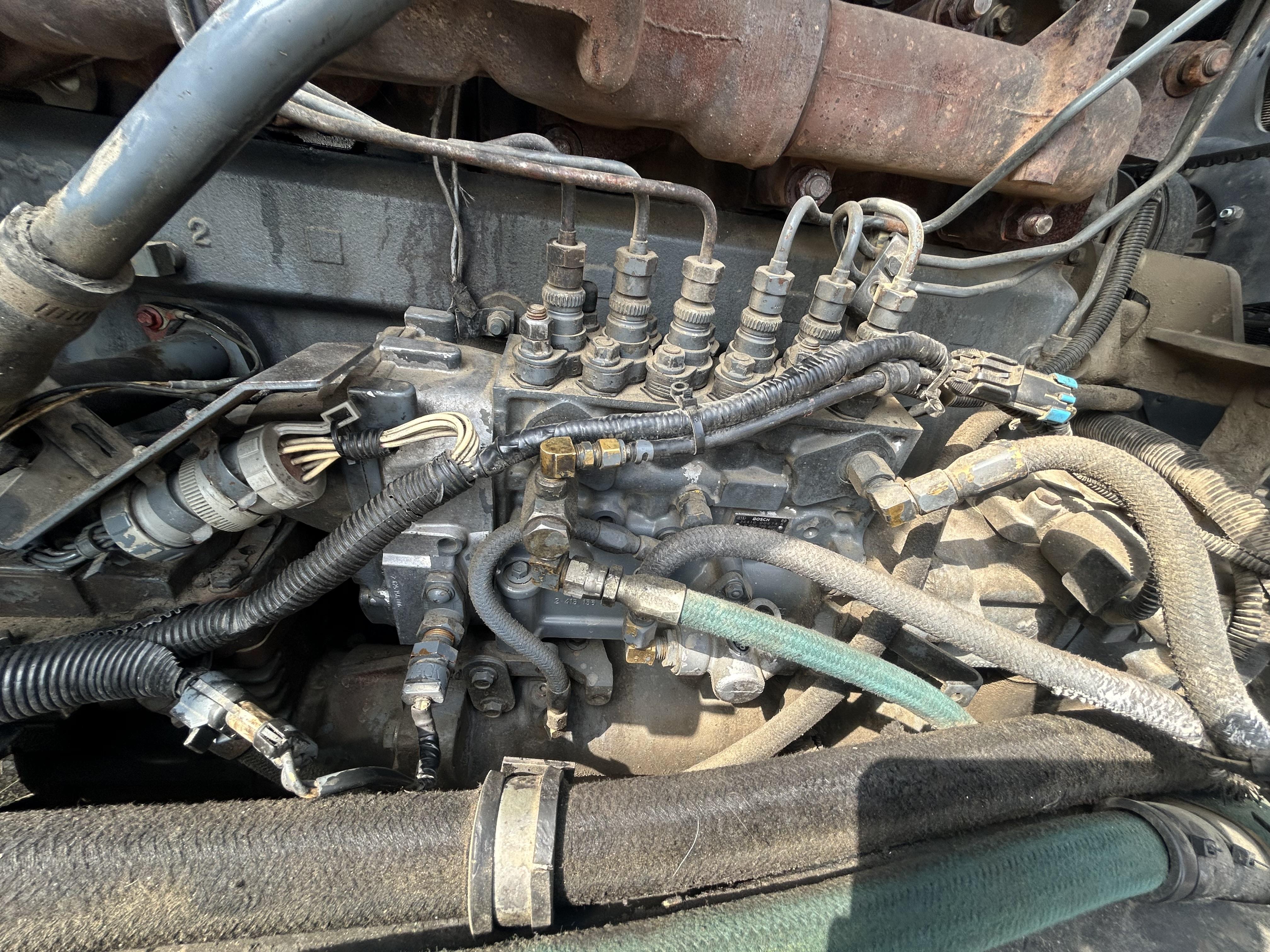

FJH- is this the valve you are talking about?

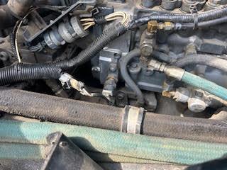

i did try unplugging and plugging the big round main pluck that goes to the back of the fuel pump.

So if your going to tap on anything tap on the rear of the pump there the rack actuator  is contained in that area and is likely  the culprit turn the key on tap lightly on the housing and try to start! if it starts you will be looking at removing the fuel pump at some point!

have parts guys looking into replacing that solenoid (rack actuator?) on the back of the pump.  not sure if its something i can do or i may just have to take it in.
Not sure if it can be done without taking the pump off the truck never done it personally! Usually done by a Robert Bosch pump shop! And I’m sure parts are becoming scarce nowadays!this here was a pretty reliable fuel setup so you couldn’t expect them to keep it!😡Mack and John deere used it for quite awhile!
