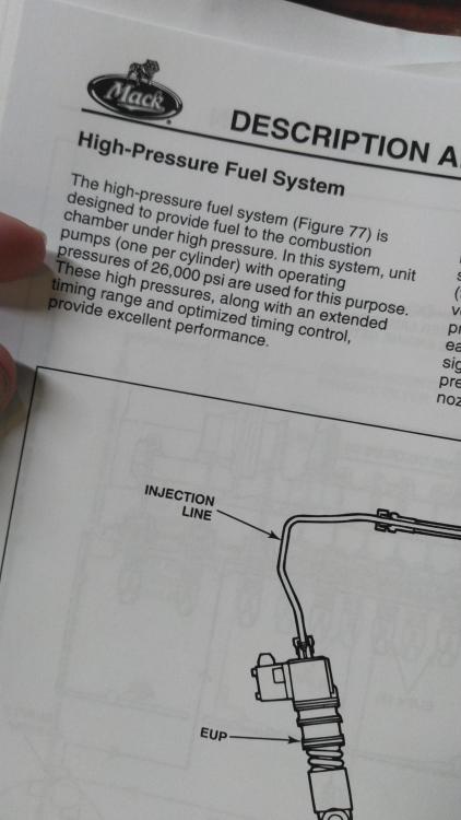

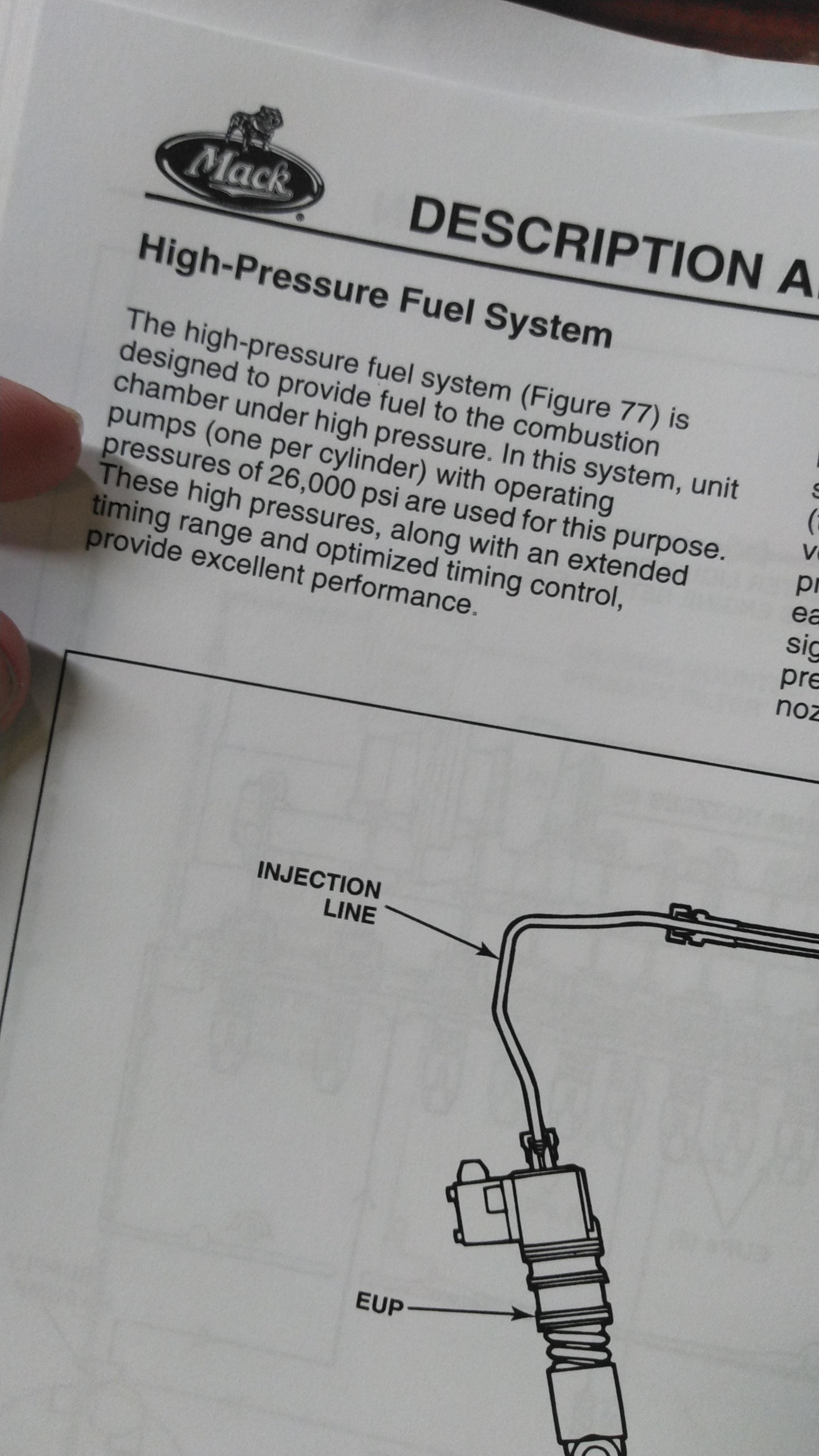

These can be a bastard to get started are you cracking the lines at the head? Not at the pumps! If you’re doing it at the pumps you’ll be there for ever trying! Just sayin!
Im cracking the lines at the head as figured air rises.  Why can they be a bastard to get started?  Im starting to worry.
Getting the air out can be painful thus doing the injection line at the head ! Get solid fuel to at least three cylinders! No foam
if he loosens the nuts at the head and pumps the primer, fuel should spray out..  lock it down and it will fire up within 10 seconds of cranking..  I'm wondering if the primer is leaking back, or in rare cases, which I have found...  fuel leaks into the engine through the pump shaft seal..  3 bolts to remove the fuel pump, leave the lines on and lean it back and pump the primer to see if it is pushing fuel into the engine..  I still am not sure if this engine does run and looses prime after a short time of being shut off.  since its an ASET,  ''I'' need more info..  I know this engine series.....

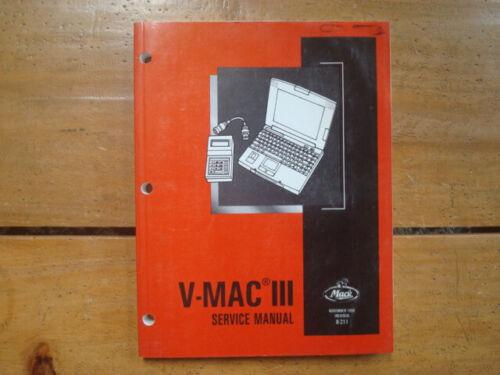

https://macktrucks.vg-emedia.com/ProductDetail.aspx?ProductId=6156
You can download the vmac III book for free from Mack or buy it from your dealer or online.  Book # 8-211
downloaded it last night, thanks for that advice :)

We used to do a ton of exhaust gaskets! Meant disassemble of all injection lines ! We would place bets on who could make it run on the first few cranks ! The only way to do this is to get fuel running at the injection lines at the head!I was the only guy in the shop that would bleed this way cause someone along the line told these people to never bleed at the head! Where the starter out instead I guess! Anyway that’s how to make them start and run on all six 4 turn or less! In this case my way or the highway!😡
Ok just got back from the truck and found that no signal at injectors so electrical, checked voltage on battery while cranking and about 8.5v SOOOO tomorrow gonna put different more powerful batteries in and lets see.  Fkn sure i bled it right, to be sure to be sure today cracked a two injectors and got no bubbles (at the head).
