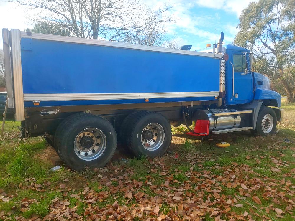

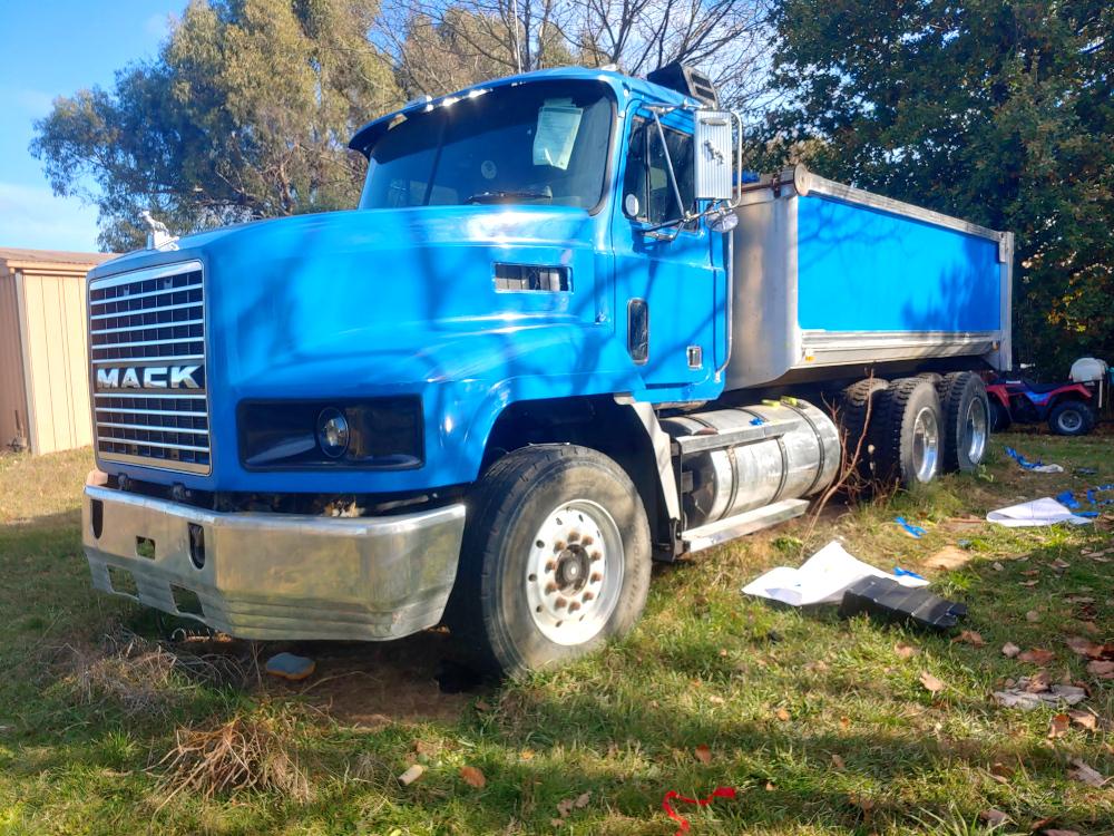

BTW, here are some pics of the girl, yes the headlights are custom setups made by me :)  Have the moulds to make more but damn it takes a lot of time to get them right in fibreglass.  Front pic is right after vinyl wrap of large section, Left pic is final vinyl wrap finished.
