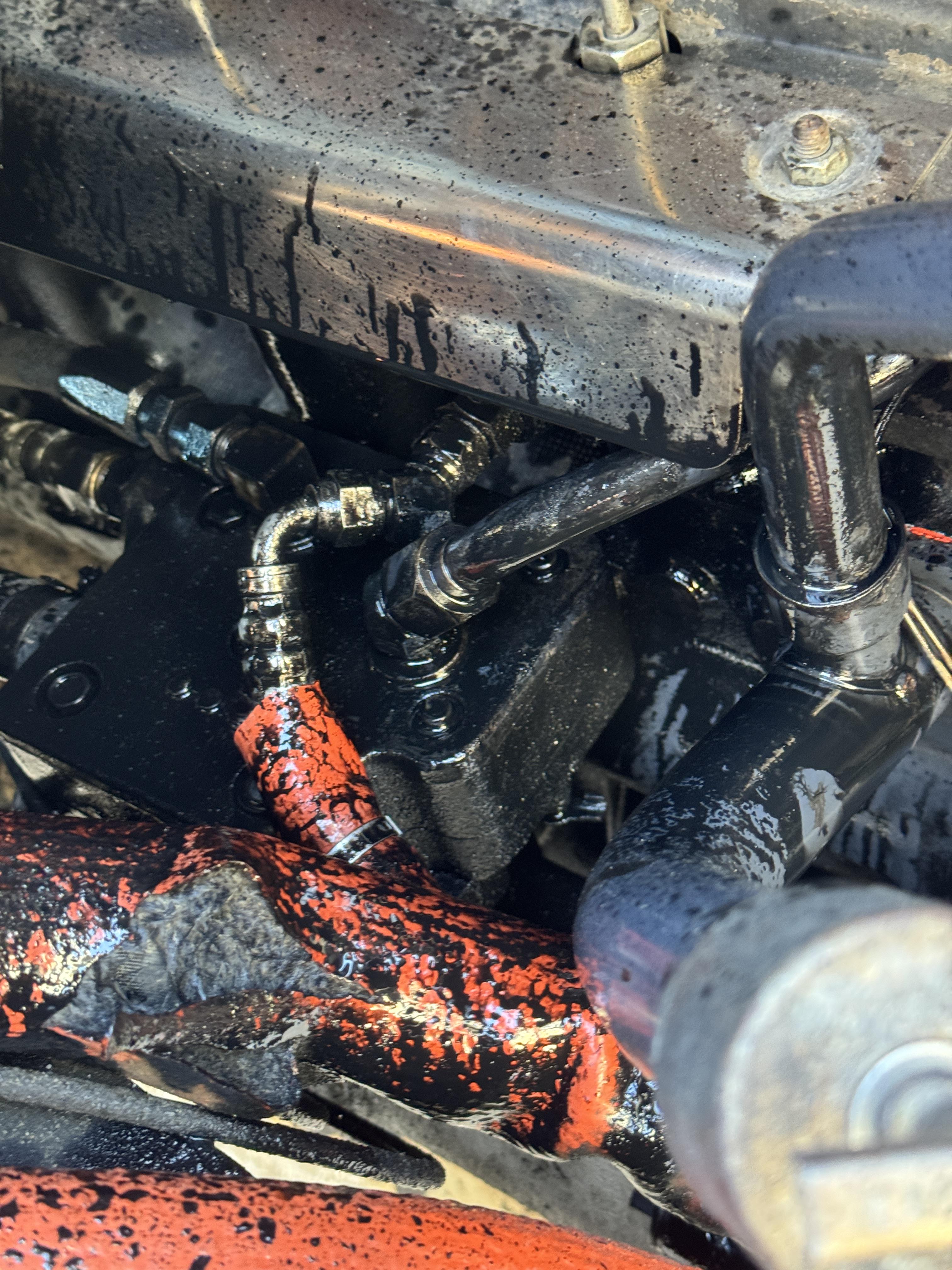

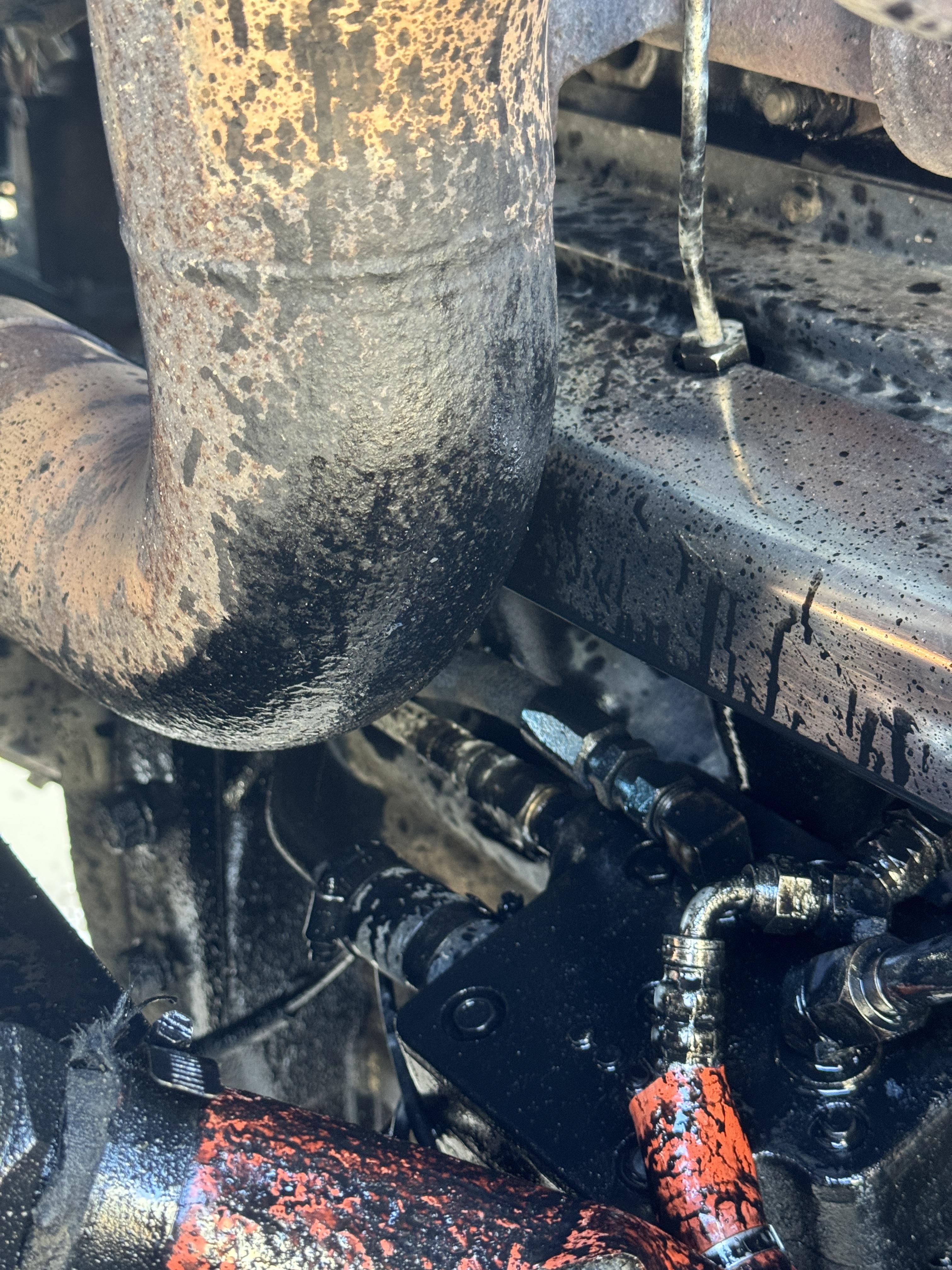

I’ve got a 2004 Mack Granite CV713 with the E-7 AI-350 engine. All of the sudden I have encountered an oil leak from the turbo return line. I have replaced the round o-ring gasket with a brand new one which did not fix it. You can wash all the oil off and let it idle and not a drop, but once driven the passenger side will get covered again. No restrictions. Breather is clear..

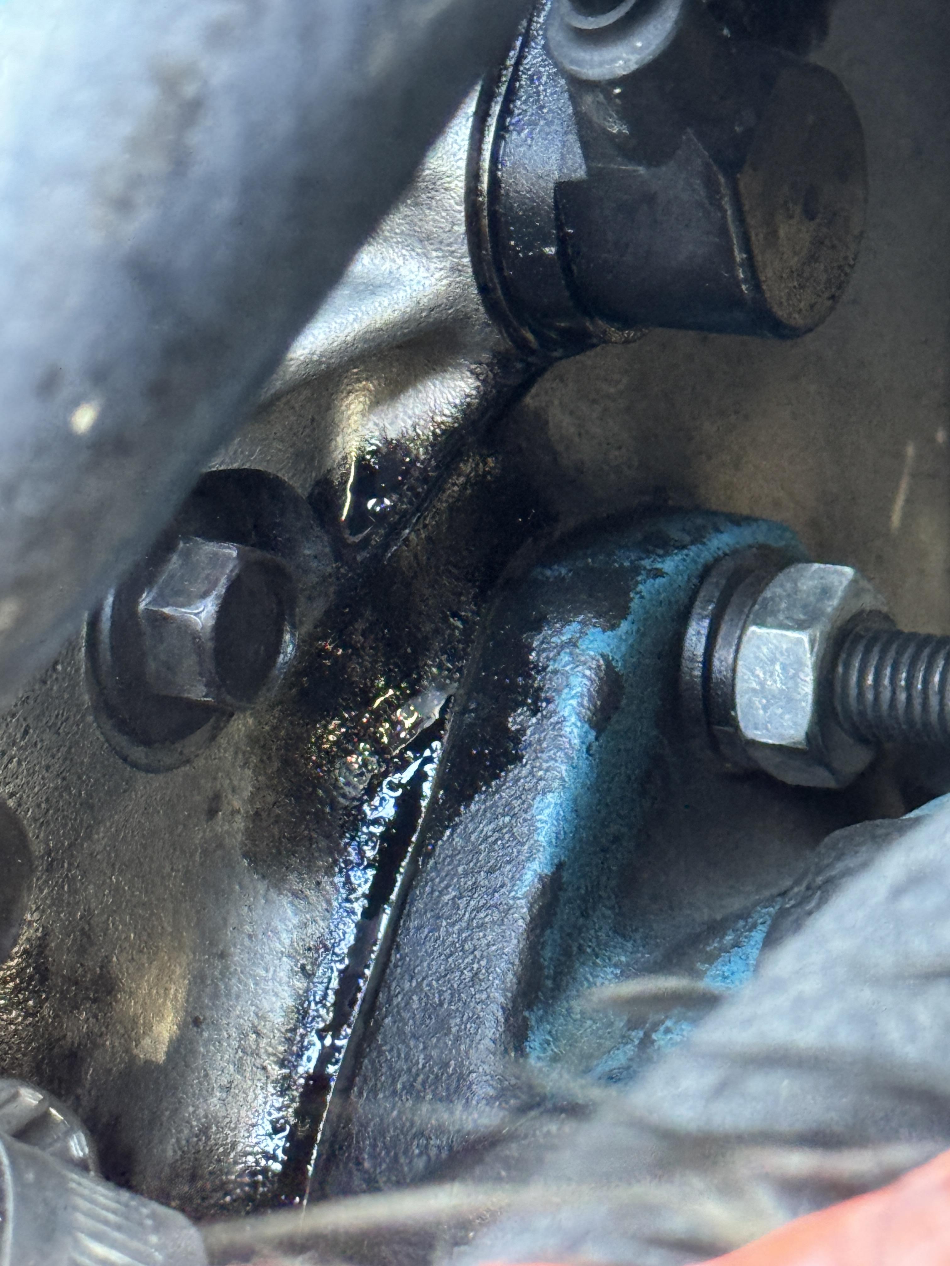

I am also losing oil out from the engine position sensor at the bottom on the same side of the motor
What sensor is leaking? The engine position sensor is in the front cover near the overboard breather filter..
Yes. Correct. Oil is seeping from the engine position sensor. I will post a picture as well.
Absolutely insane now

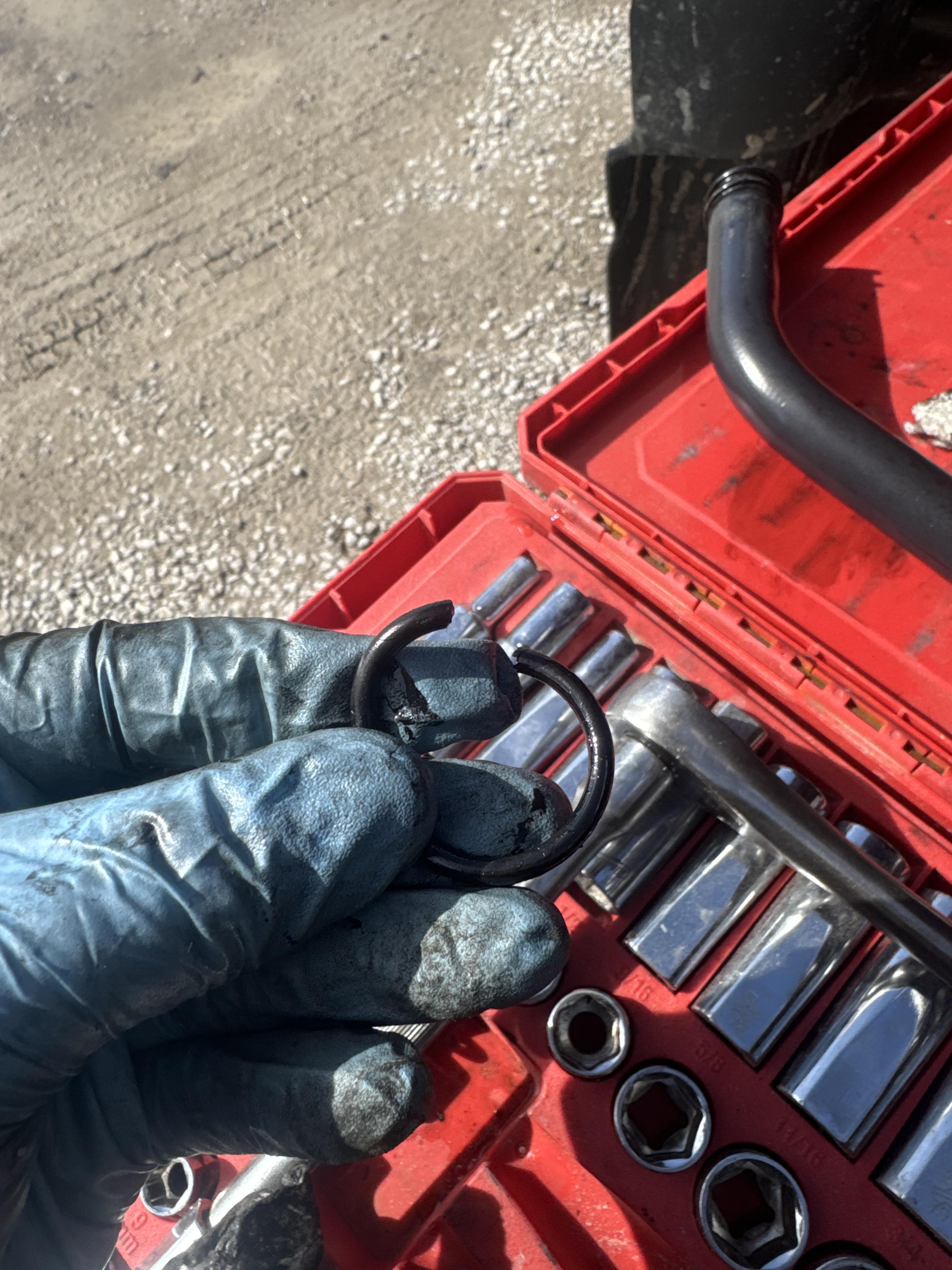

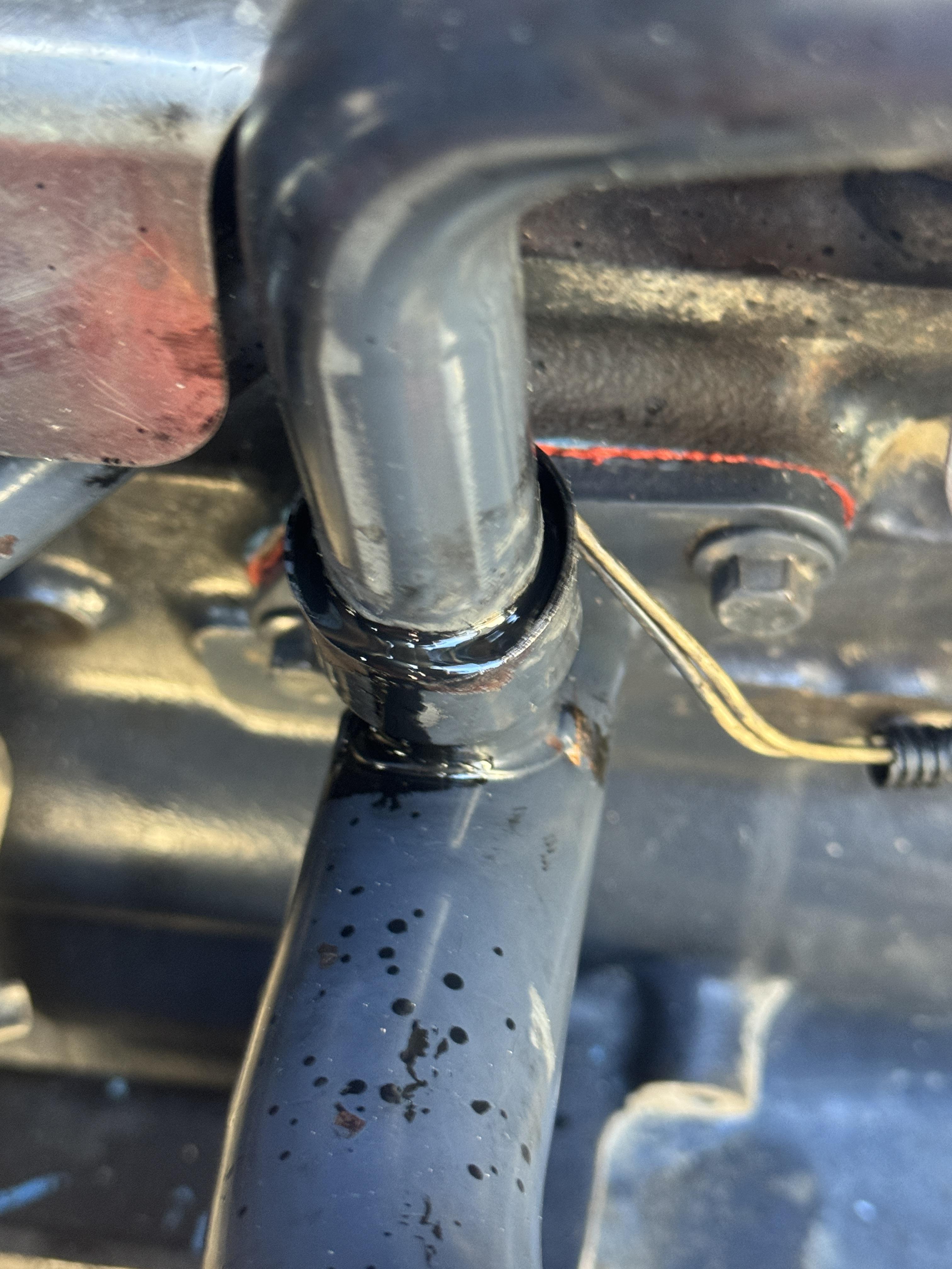

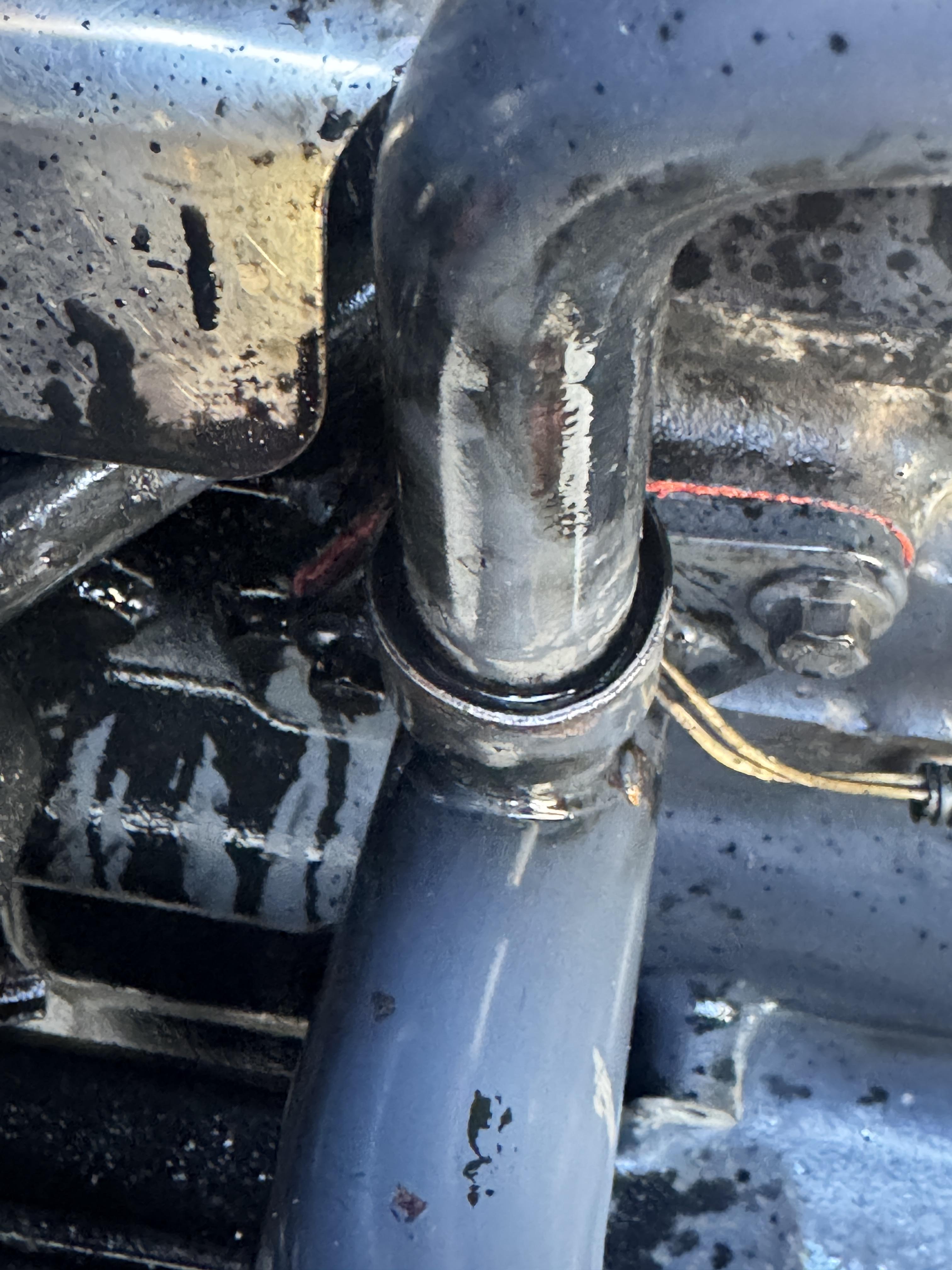

It appears the new OEM gasket severed in half. How should I install the two tubes going back? So this doesn’t happen again! Return oil tube from the turbo first? And than the tube going to the block? I’m going to run two gaskets and high temp permatex rtv. Hopefully it stops it
tighten the tube to the turbo first install and loosely  gotighten the tube to the block let it find its own center then tighten it! I also suggest using an extra oring above the captured oring  and filling the top with scone BUT you needto let the silicone SET Do it on a day when the engine does not have to run! The idea here is you want everything to find it’s natural position!
